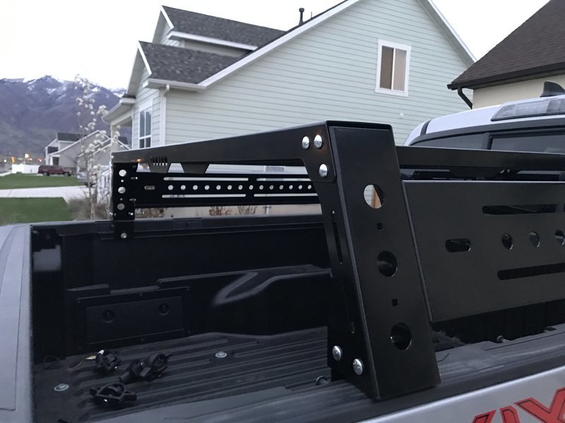

    Bought a KBVoodoo rack. The build quality is second to none.
