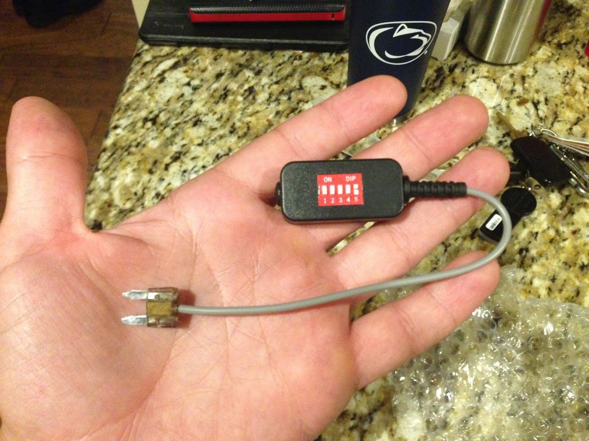

    After placing an order on May 4th, I finally got my booster in from down under, does anyone know what dip switch settings correspond to the voltage changes? Mine didn't come with a manual or settings, or do you just start it up and start changing the dip switches until you get the voltage you desire?

    The info with pictures is in the original post. You want switches 1-3 to be down on the numbers and switches 4-5 to be up at DP, which corresponds to +0.6v.
    Each switch down toward a number = +0.2v. 3 switches in the down position: 3 x 0.2 = 0.6v.

    Thanks, wasn't sure if up or down was adding the voltage. Hopefully I'll get to install and test soon, I have two optima D34 yellow tops with a blue sea ACR relay; so I'm thinking I'll shoot for the 14.7 range like you have. The optima specs for charging voltage via alternator are 13.65-15VDC

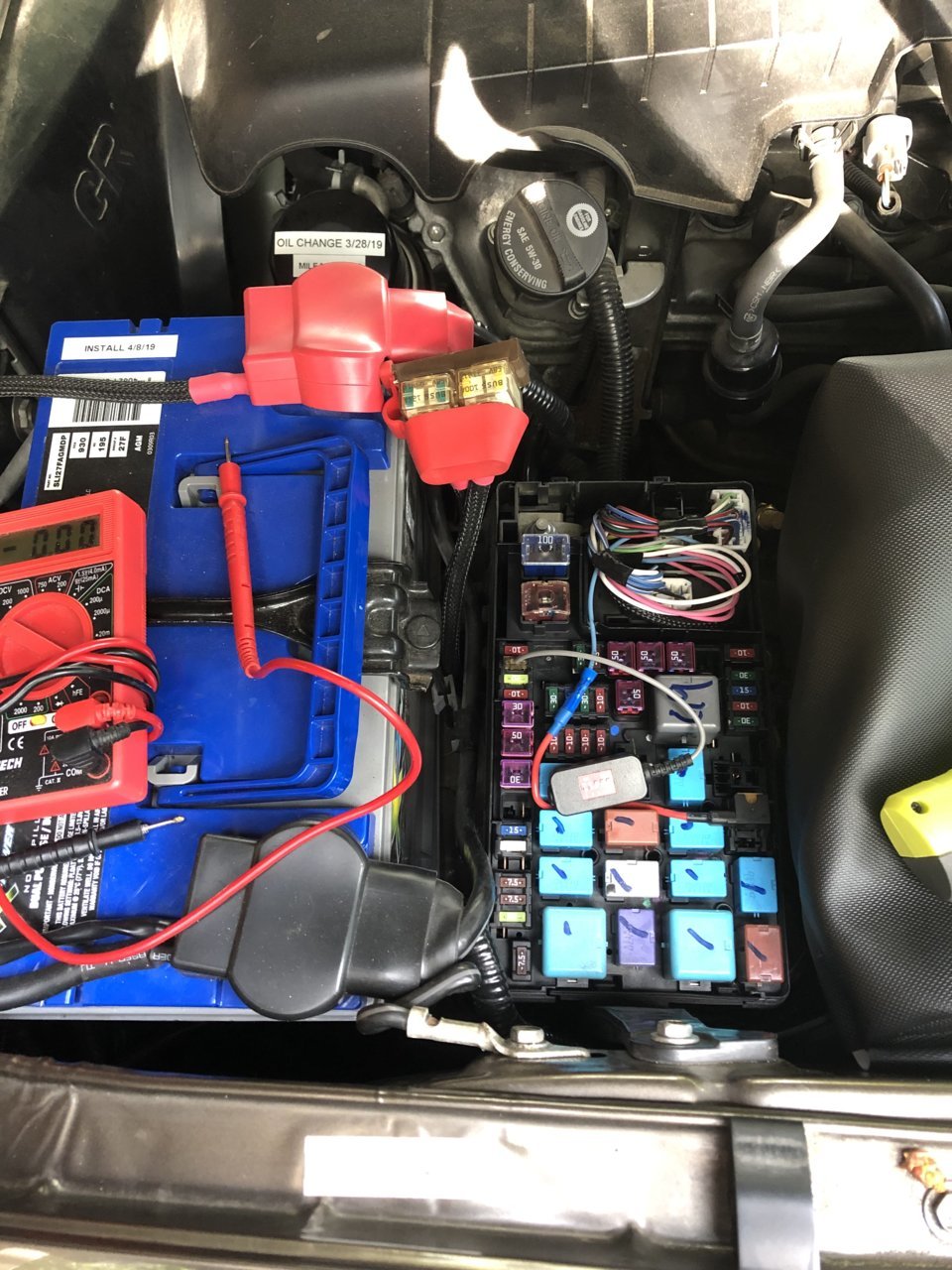

    About halfway done...
    Done. I decided to be conservative with boost of .4V
    Will monitor and adjust as needed.
