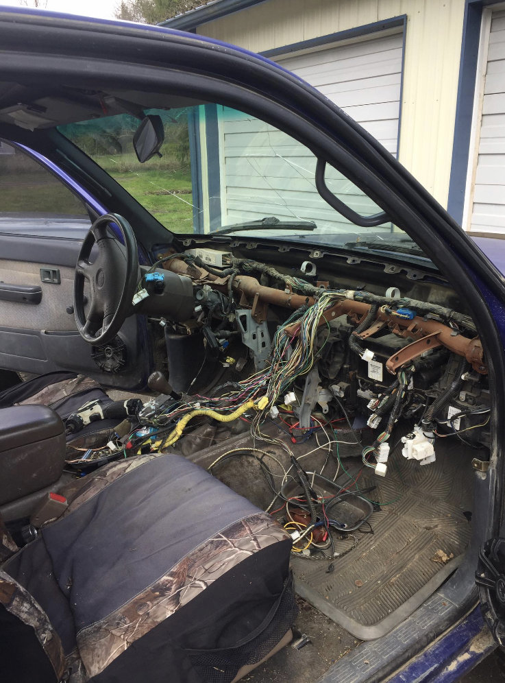

  6. Aug 28, 2019 at 10:02 PM

    Easier yes. But now I know how to take apart the dash, which is helpful since I’m in the process of adding switches. And I like the hardwired option. Cleaner is better.
    Besides. Think of all the character I’ve built. :curls:
    Oh and it turns out you can partially remove the radio panel and just reach behind this panel. Easy peasy

    97A795C1-5B03-457F-A52F-C08FEE7FAF08.jpg I’m all about that character building:benchpress:
