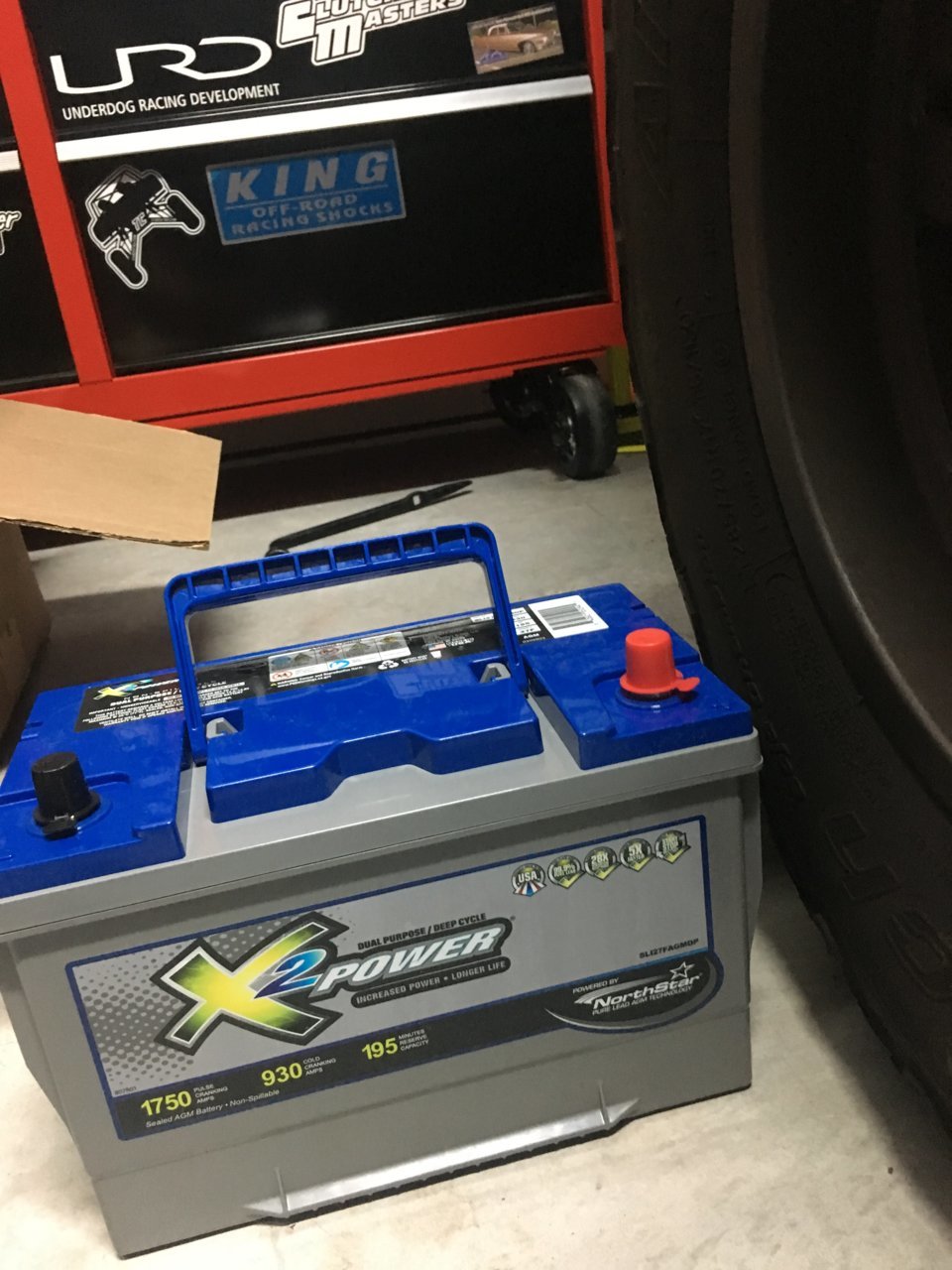

    garciav
    garciav Well-Known Member
    Apr 11, 2016
    #184036
    582
    Houston, TX
    2013 Tacoma TRD Off-Road 6MT
    TRD SC,HPTuners
    B2ECDEE7-D91F-4A4F-A772-939E6E9602D2.jpg Almost 4 weeks later finally got my battery
    Hope it was worth the wait !
