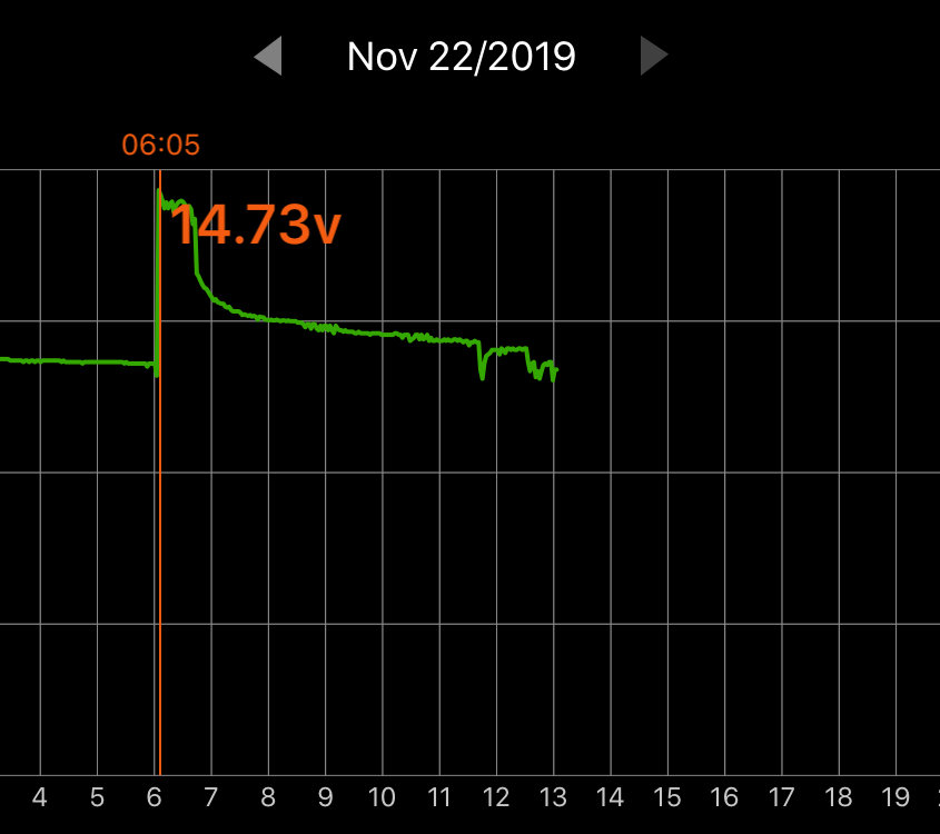

    Here was peak voltage this morning with the booster set to 0.4v...looks pretty good to me. Outside temp was 34*F and the truck sat for around 12 hours overnight.

    Nice! Track it over time to see if that is about the norm. It really helps to have data backed decisions. :) Are you running the NorthStar 27F?

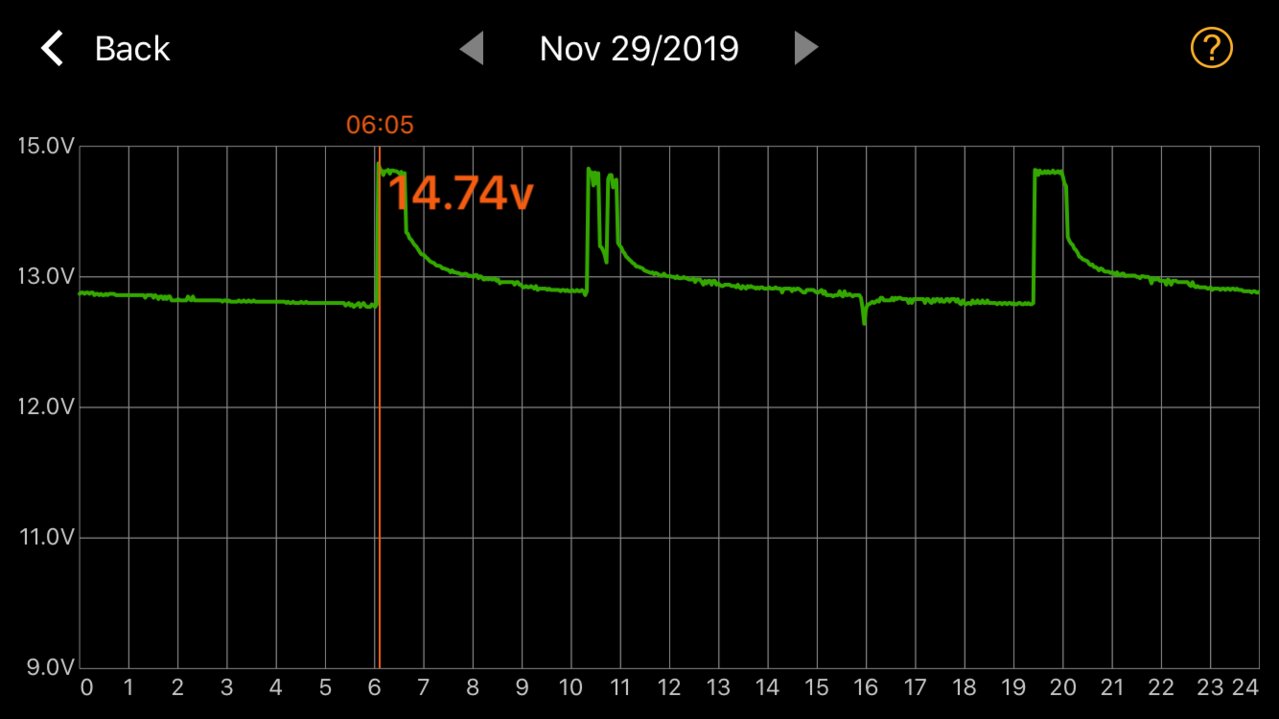

    The highest the battery monitor has read is 14.74 when starting the truck in the morning in 30*F weather. Do you guys think it’d be worth upping the booster from +0.04v to +0.06v?

    No, you are well dialed in as you don’t want to go over 14.8v. It’s possible you could adjust it up in the summer and back down in the winter depending on what your monitor readings are.
