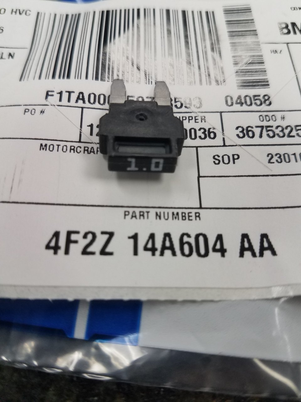

    I have to also add that Ford makes a 1 amp one way diode as well which is a 100% direct fit for our trucks for those looking for alternatives to GM and Littelfuse. I just got mine today. There is no need to trim anything on the housing to fit it in and it fits 05-14 Mustangs Econoline and various other vehicles.
    Just to add on to how easy this mod is, it dropped right in and imediately boosted me up to 14.7-14.8 volts at initial start. In Ford I trust. :laugh:

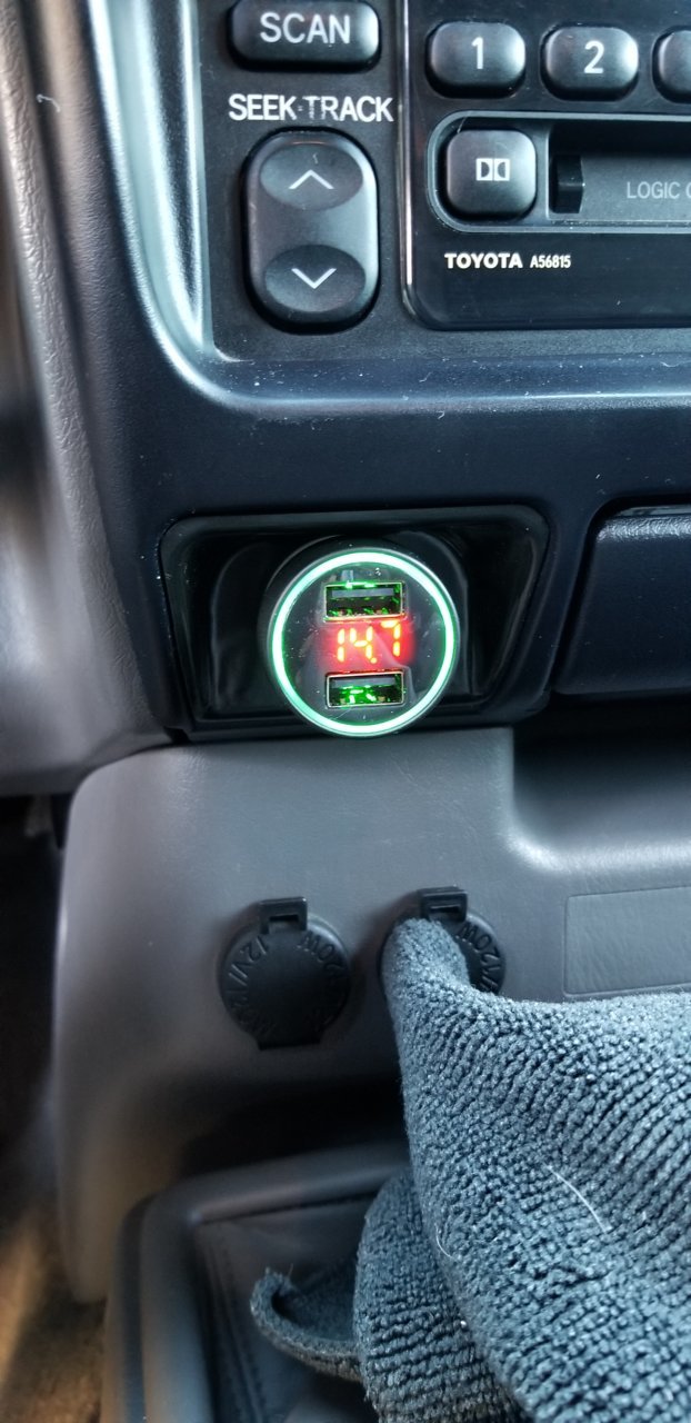

    Just got the .5volt booster fuse and installed it today. 14.2 was most I've seen before, now at 14.7
    Edit: thanks OP for the heads up.
