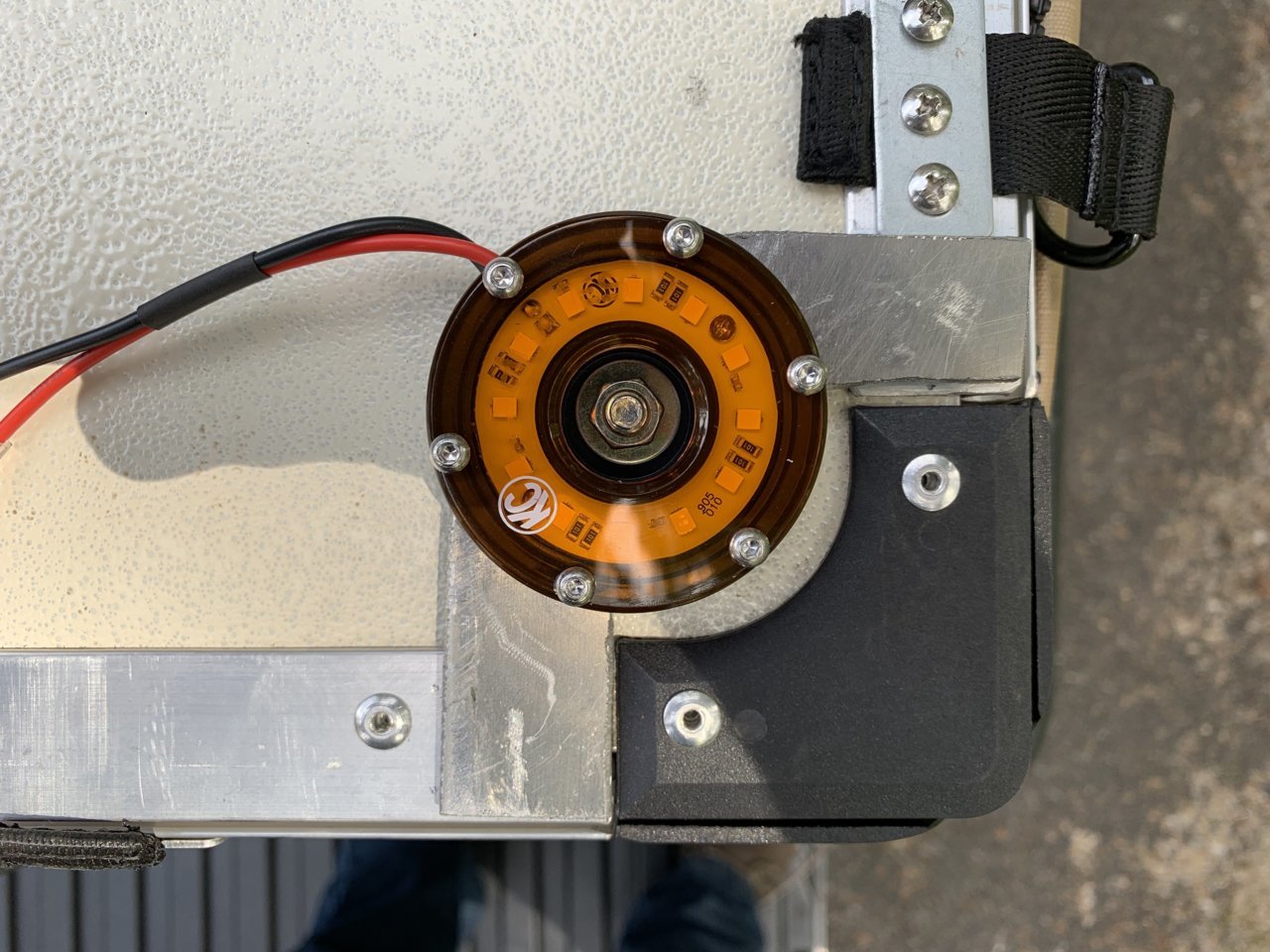

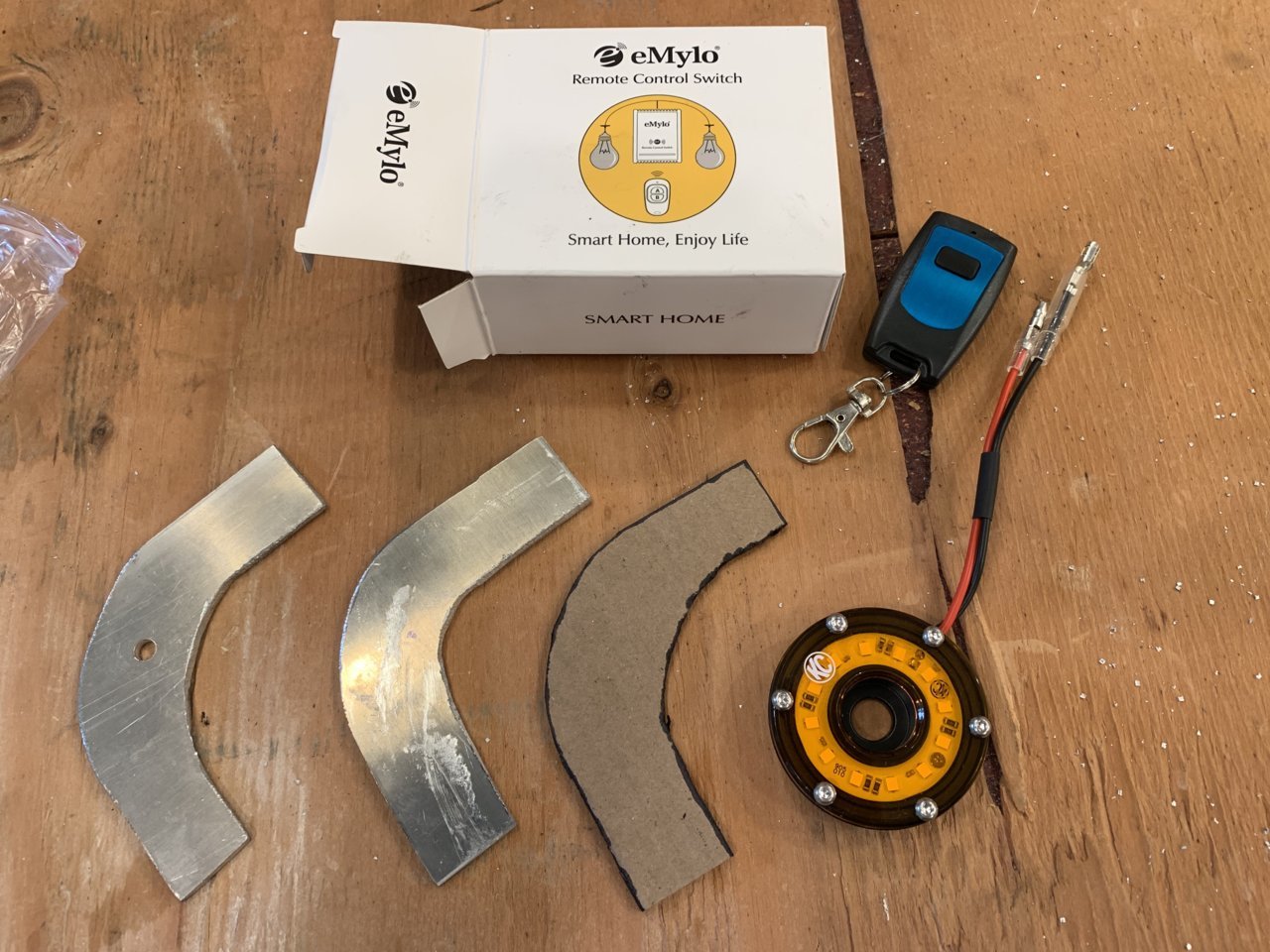

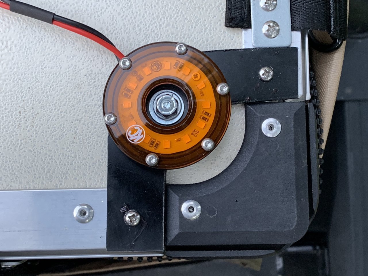

    I had it hooked up on a manual switch in the tent which worked great. When I went to wire to a remote transmitter it went a little sideways. It took forever to figure out the multipurpose transmitter wiring which had poor instructions, then once I had that done and installed the lights would remote turn on, but I couldn’t shut them back off without manually disconnecting from the power source. Required more troubleshooting. It was the end of the RTT season and after I took the tent off I haven’t troubleshooted it any more. Figured I’ll pick it back up in the spring. I was using 2 transmitters, one above the tent door on the inside for quick access, and one I’d carry on me. The wireless above the tent door switch was far easier to find than fumbling around the sleeping bags on the floor for a wired switch. Really happy with the lighting performance, just need to get the remote control bugs worked out.

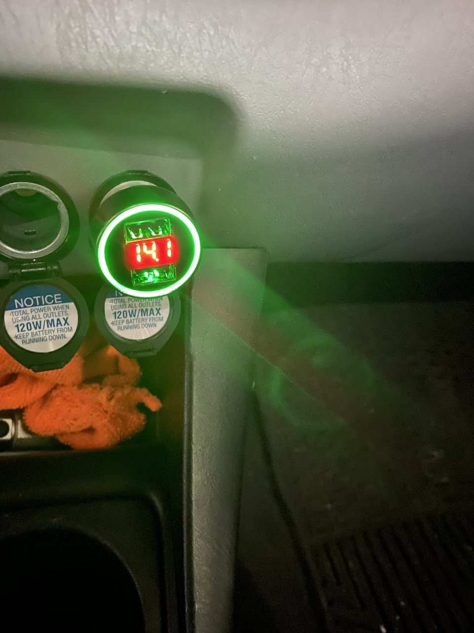

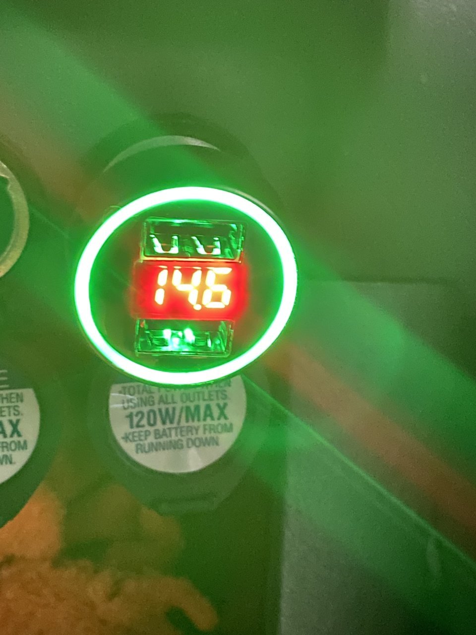

    I've had the 0.5V booster fuse now for a few weeks and have definitely gotten the boost needed. Mostly seeing 14.7 and down to a low of 14.4. My Northstar battery which is a little over a year old, is only showing 12.3 - 12.4 after sitting overnight.
    Before the booster was installed, it was in the 12.2-12.3 range. Looking at some charts for AGM batteries it looks like 12.8 is for a fully charged battery and mine appears to be only 75% charged. I thought the booster would get the battery more fully charged but that doesnt seem to be the case. Do you think my battery is doomed to an early death?

    If you see 14.7 after the booster mod, that would tell me your alternator is operating correctly. Not running the booster causes the battery to charge below required voltage, which leads to sulfation, or build up on the internal battery plates which causes a loss of capacity/voltage and eventually early death. I just checked mine with a voltmeter and I am at 12.85v. Sounds like your battery may have sulfating that the late added booster is having a difficult time resolving. It is supposed to be reversible:
    https://www.batterystuff.com/kb/articles/charging-articles/make-the-bad-sulfation-go-away.html
    Though you also have a very good warranty on the battery if you choose replacement. There is always a chance the battery is defective.

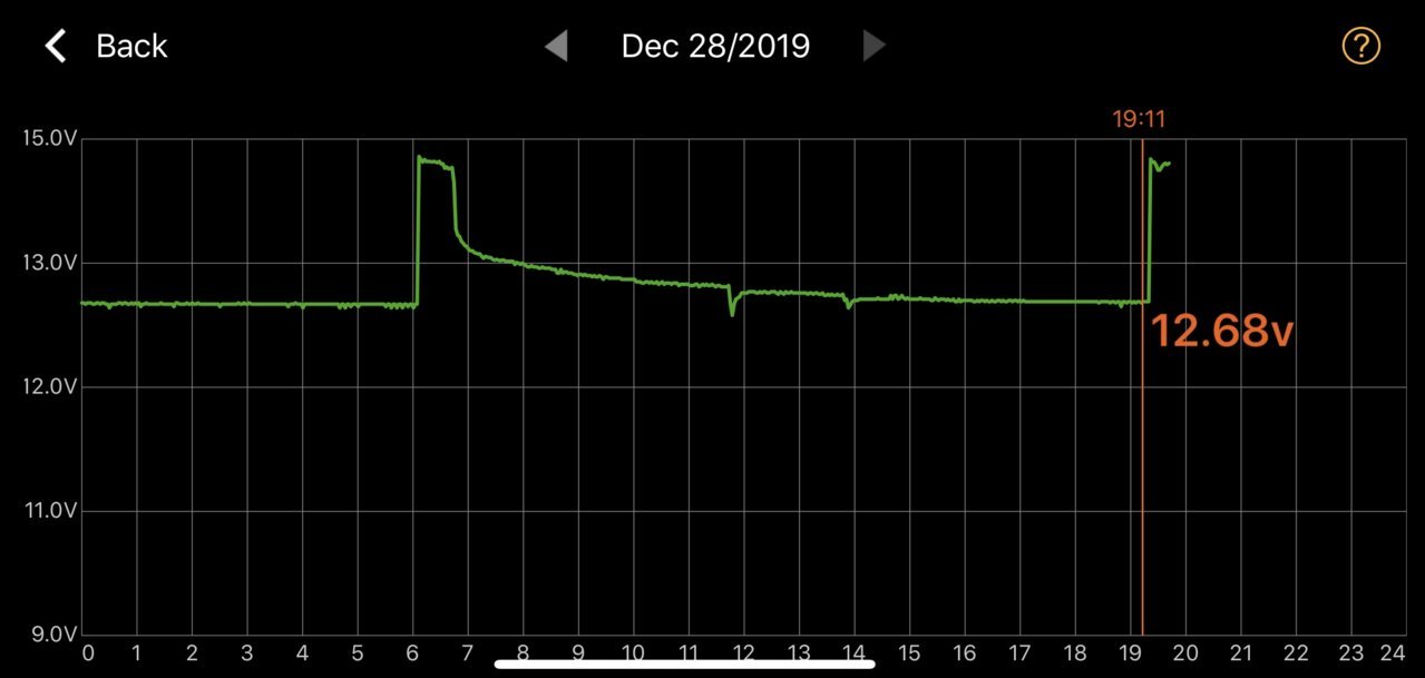

    I’ve noticed that my resting voltage, after about 12 hours, settles out to just under 12.7v. Do you think this is a problem?

    Nope! You can see mine is about the same after a couple supercharger pump cycle runs while resting as indicated in the chart (minor annoyance of the OEM supercharger). I wouldn’t worry about a 0.1v difference, in scheme of things that is pretty small.
