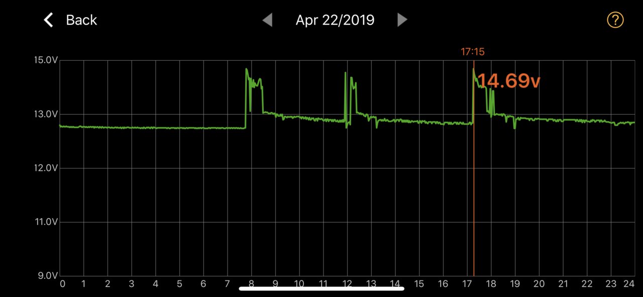

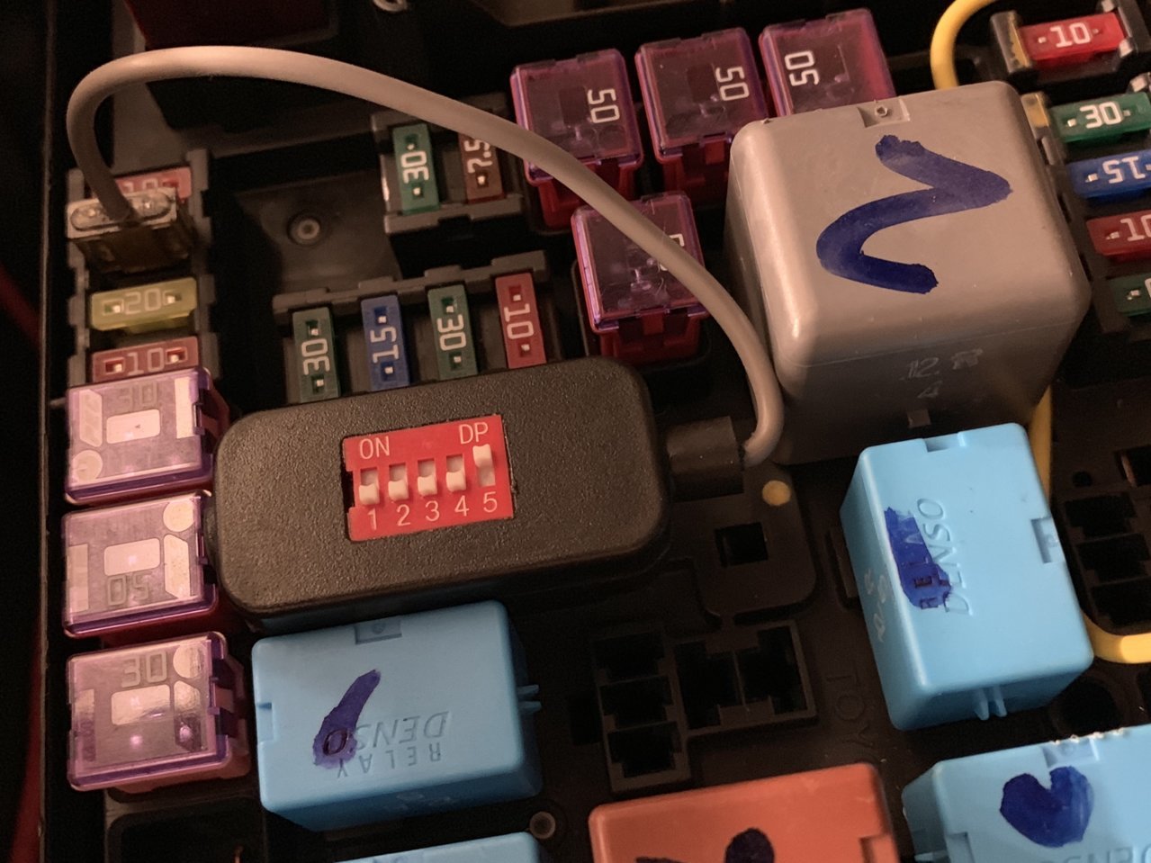

    I'm running a stock lead acid right now however I ordered the 1a diode from digikey ( two of them in fact ) and installed it. OBD is reporting charging voltage of 14.7. That will do for now since it won't harm the stock battery while I look for deals on an AGM.

    That will over charge a lead acid battery and lead to rapid failure. A lead acid battery should charge at a peak of about 14.1-14.2v. The voltage booster mod should not be run on lead acid batteries.

    Weird. Everything I've read online says 14.7 is a safe voltage for regular cells, anything above will cause the electrolyte to boil over or other issues. But I already took it out of the fuse hole any way, so it doesn't matter.

    Bad battery. Northstar shipped me a replacement today under warranty. I’m going to install the voltage booster and also I have a NOCO charger. I wired in the quick disconnect so I can leave it plugged in since I only drive it a couple times a month.
