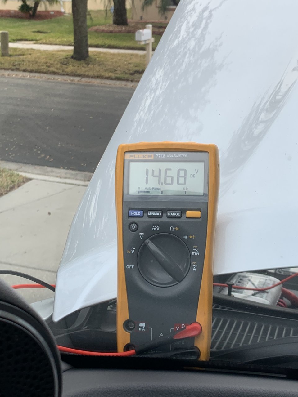

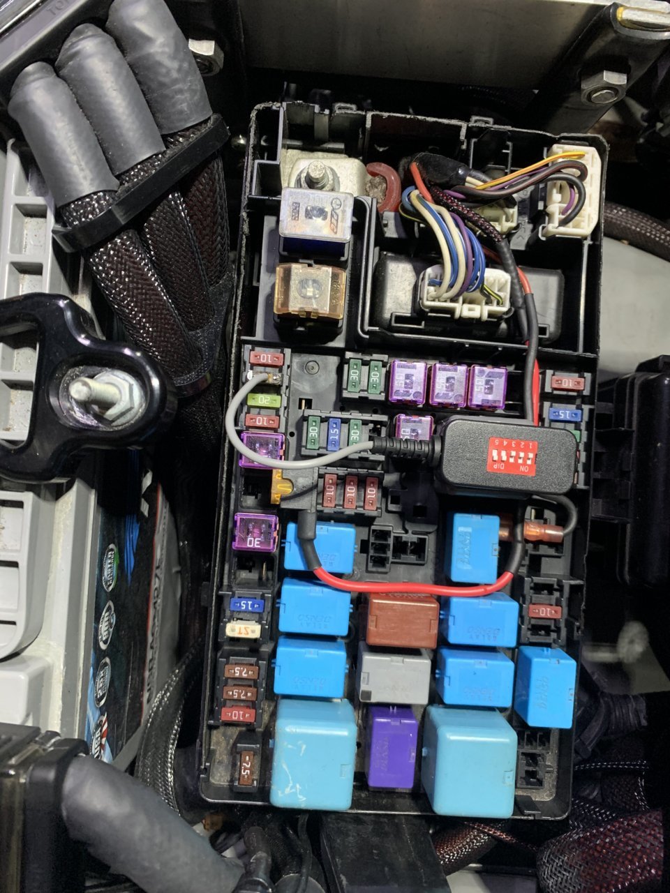

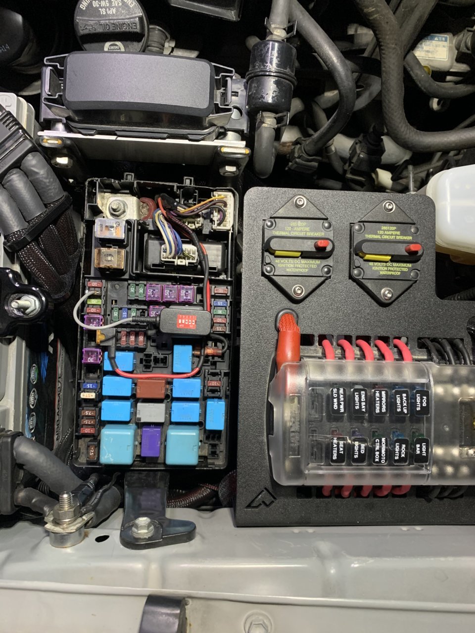

    Well, the Mail Man definitely surprised me. I placed my order on eBay for the micro blade 0.5V booster on Sunday January 12th and I got it last Friday, the 25th. I was expecting it to be way slower. Well here is what I got so far:
    I did install the booster microblade "fuse" on Sunday (following included instructions). The Taco was parked without any movement since Friday January 25 at 6:30 pm. This morning at 6:50 am I did start the Taco, the air temperature was 54F and the SGII read ~14.7VDC (on cold start) right on the button. After the Taco warmed up it ranged from ~13.8VDC idling at stop lights, to ~14.0VDC for the most part constant while cruising on the interstate, to peaking at ~14.4VDC.
    So far happy with the result, meanwhile I will continue to connect my charger at home (NOCO GENM1 - yeah, I know probably not very popular brand with most people here, but is worth a try) to promote desulfation on my NorthStar, which I suspect has some already. I purchased the battery on September 2018 - and since then I have not been giving the battery the proper charge that it needs. I looked at my resting voltage on Sunday and with a Fluke at the battery I had 12.38VDC - I saw on line that is roughly 50% charge on the battery - so I will try to force that recovery and restore that lost capacity. After talking to NorthStar this is the route I'm going to try. It's funny, because the guy even told me that at the current capacity of only 50%, that the Northstar battery will still last for 3 or 4 more years. Just want to get the battery healthy again and able to keep a 12.85V resting reading.
    All-in all:
    BEFORE booster:
    Cold start ~14.0VDC
    Up to temp ~13.0 to 13.3VDC
    AFTER booster:
    Cold start ~14.7VDC
    Up to temp ~ 13.8 - 14.4VDC
    Any feedback would be greatly appreciated...
    Thanks!
    Rick

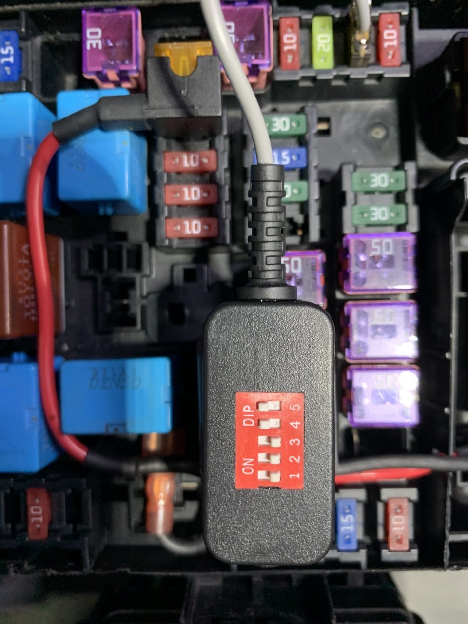

    UPDATE:
    So on my original post above, January 28, 2020 - I was very happy with the 0.5V micro blade’s numbers.
    Today I received the adjustable booster and I am happier with a 0.6V boost vs a 0.5V boost. Like I mentioned before - I had super low numbers from the beginning - 14.0V cold and 13.1V up to operating temp.
    I feel better with 0.6V and will keep the micro 0.5V which will give me the option to make adjustments with 0.4V, 0.5V, and 0.6V as needed.
    Like the new numbers:
    Cold start ~ 14.7V
    Up to temp ~ 14.0V to 14.4V
    Rick.

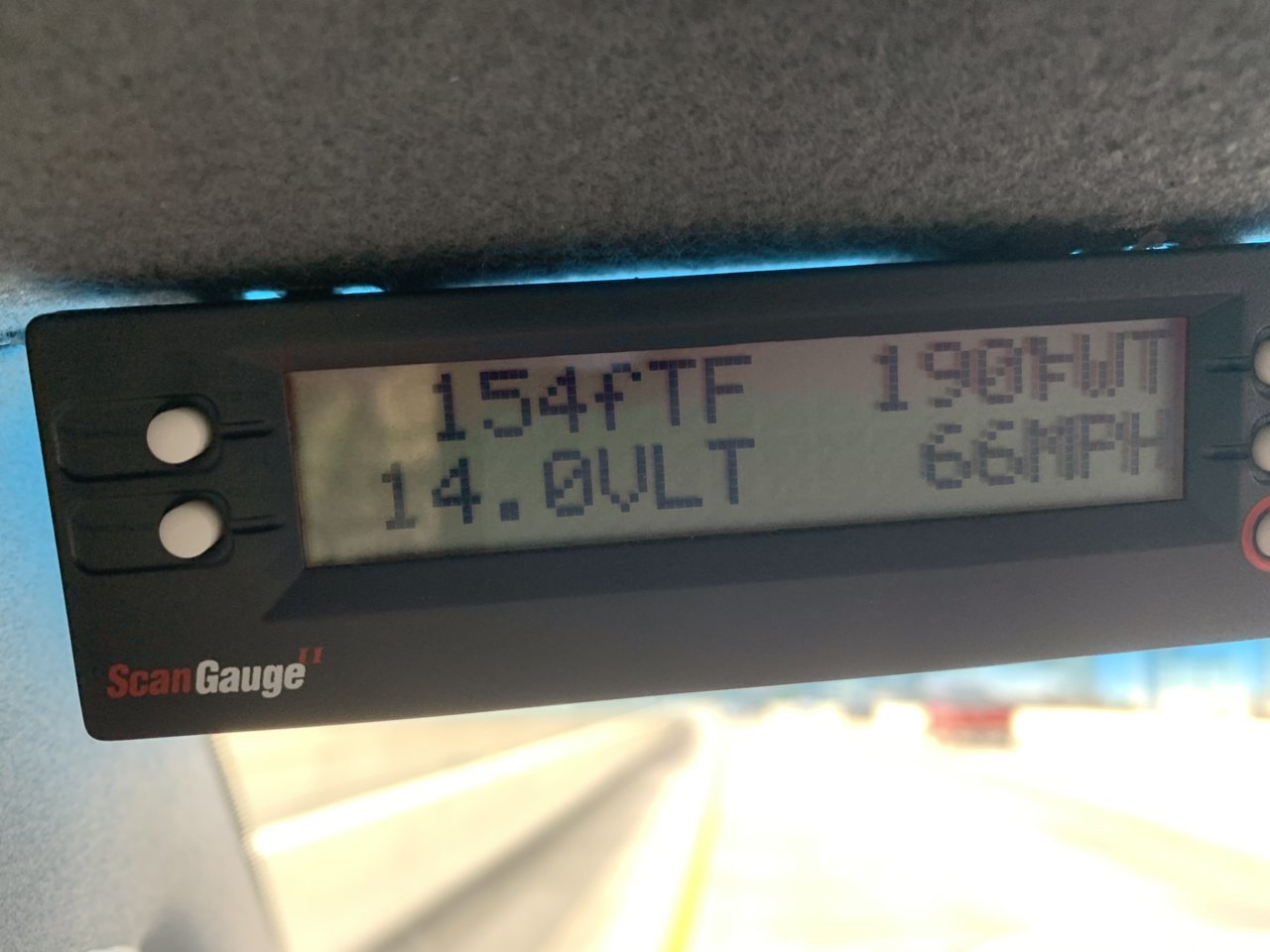

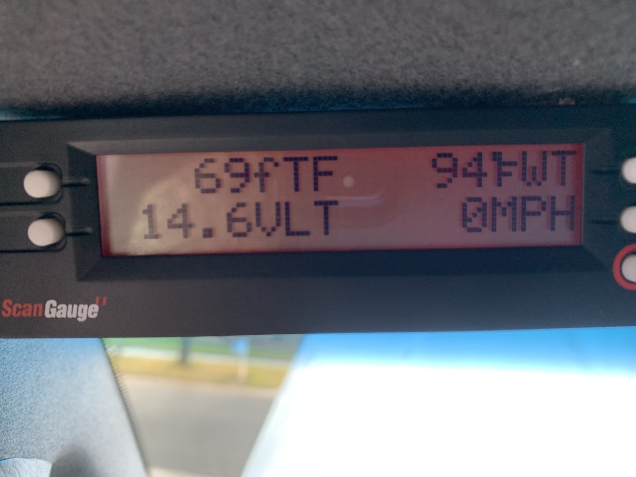

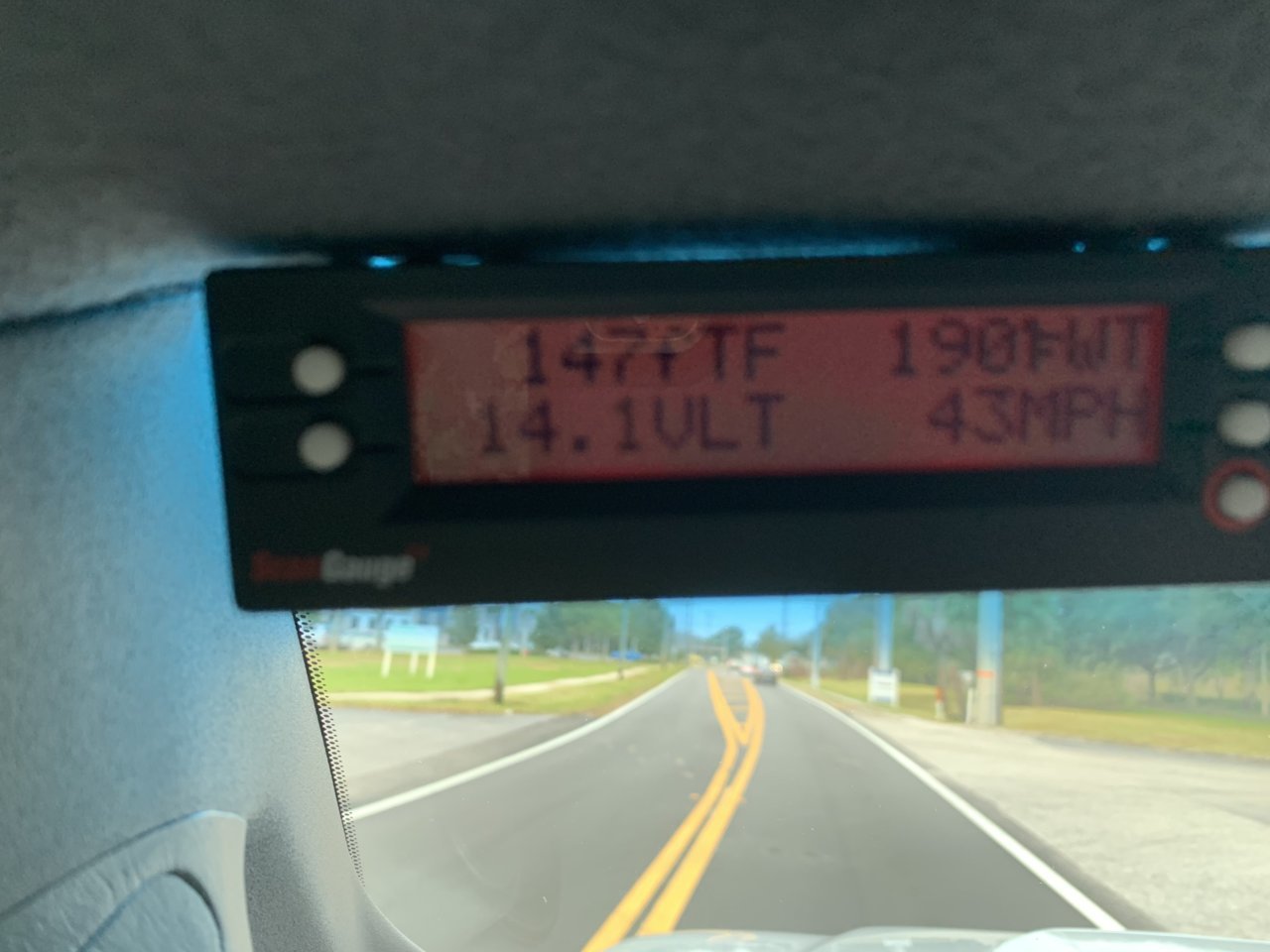

    Air Temp @ 8 a.m. today 66F
    COLD Start with FLUKE 77
    COLD Start with SGII
    I would say that the reading on the SGII is pretty dead-on...

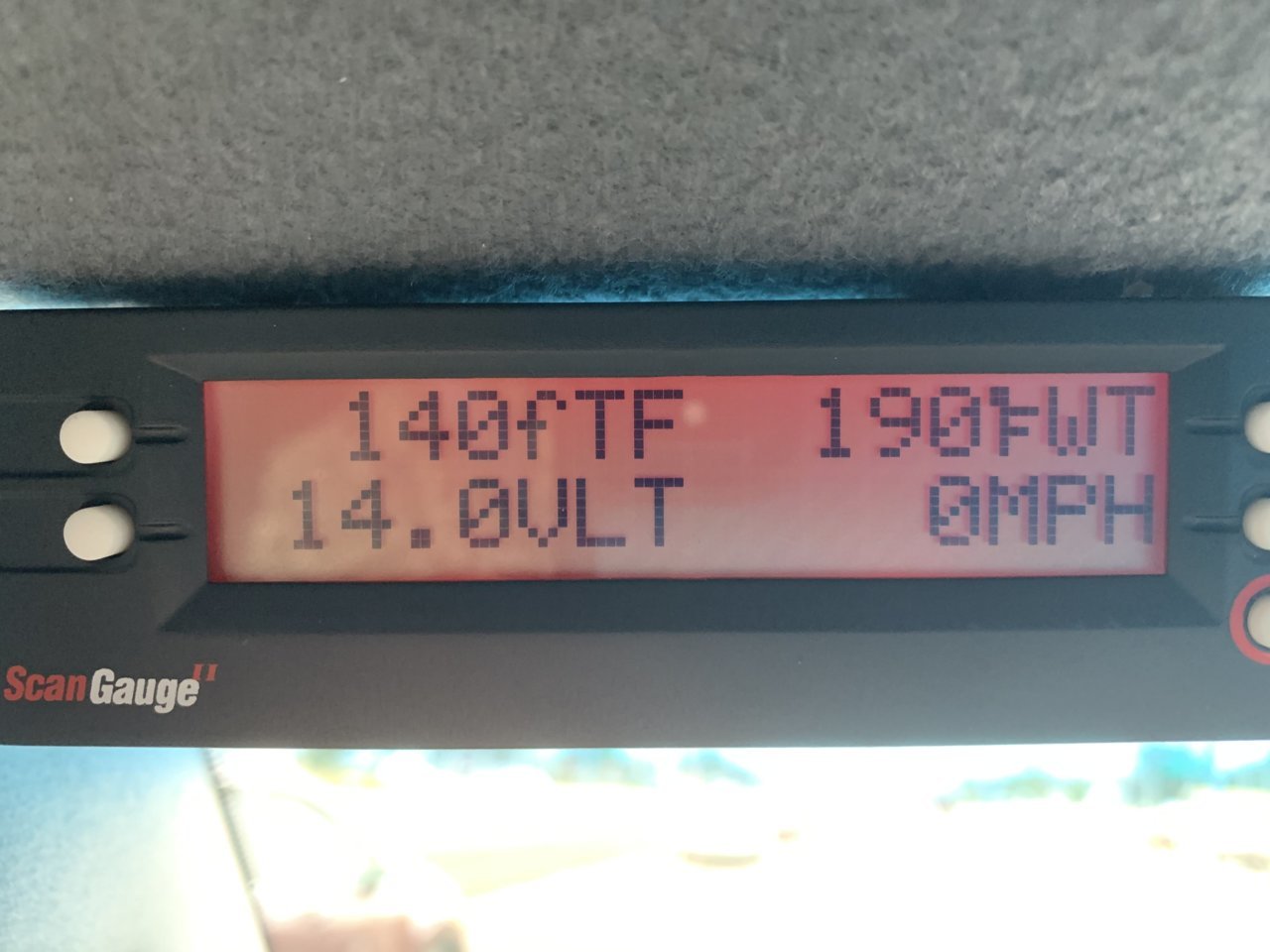

    Up to operating temp cruising speed...
    At a stop light...
    Pretty much fluctuated between 14.5V and never less than 14.0V.
    Rick
