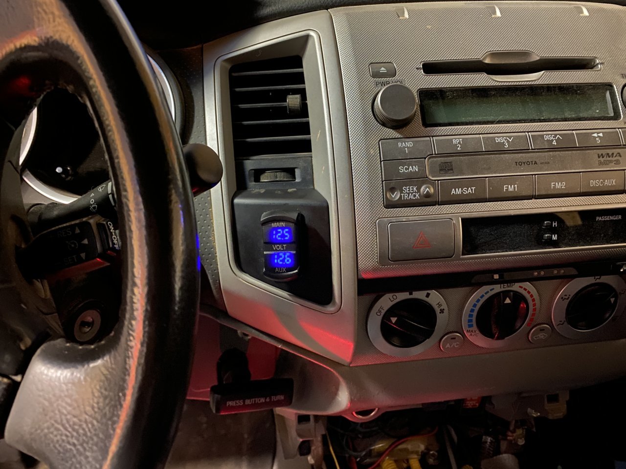

    Any recommendations for a Voltage Cigarette thing.... Dislike checking on the voltages, popping hood with VOM to just check. Ones from box parts stores have a nice hum on the radio when their plugged in..
    MattCowsmasher likes this.
  11. Feb 11, 2020 at 4:22 PM
    #491
    MattCowsmasher
    MattCowsmasher ( -_・)ᡕᠵ᠊ᡃ່࡚ࠢ࠘⸝່ࠡࠣ᠊߯᠆ࠣ࠘ᡁࠣ࠘᠊᠊ࠢ࠘
    Apr 7, 2017
    #215629
    48,694
    Temple, Tx
    O3 Rubicon wrangler
    I have this one no hum and it’s pretty spot on. I also did the 12v on anytime mod so I can see it when trucks turned off.
    Palumma 24W/4.8A Dual USB Car... https://www.amazon.com/dp/B07K16WM3W?ref=ppx_pop_mob_ap_share
    VE7OSR and blind cowboy like this.

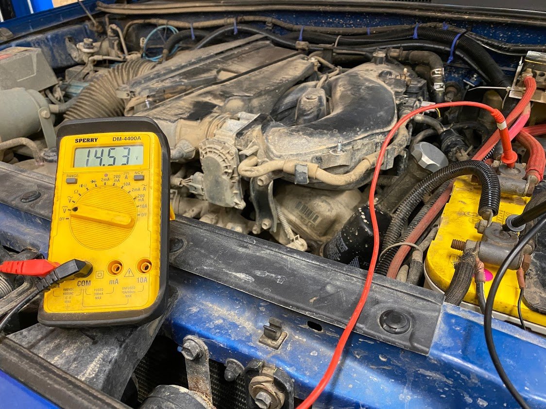

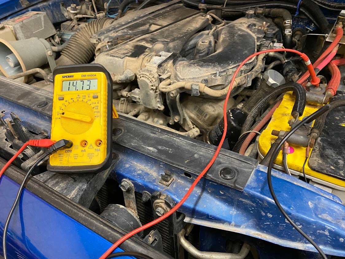

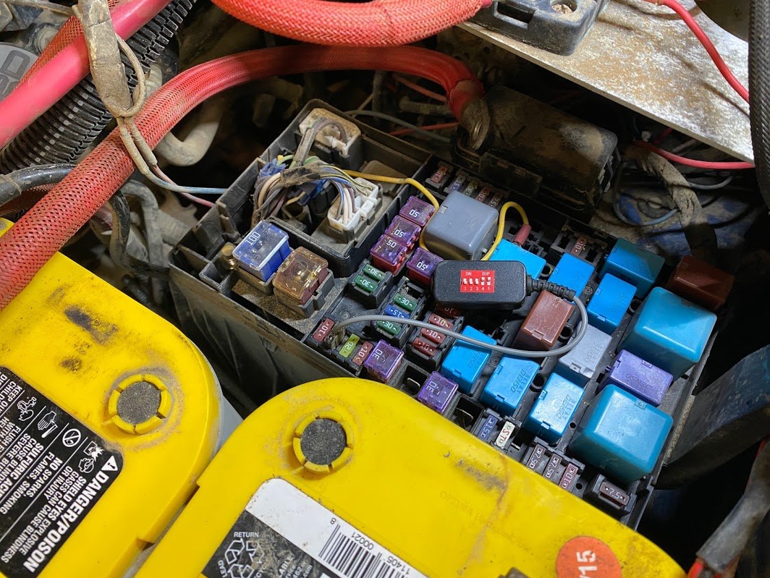

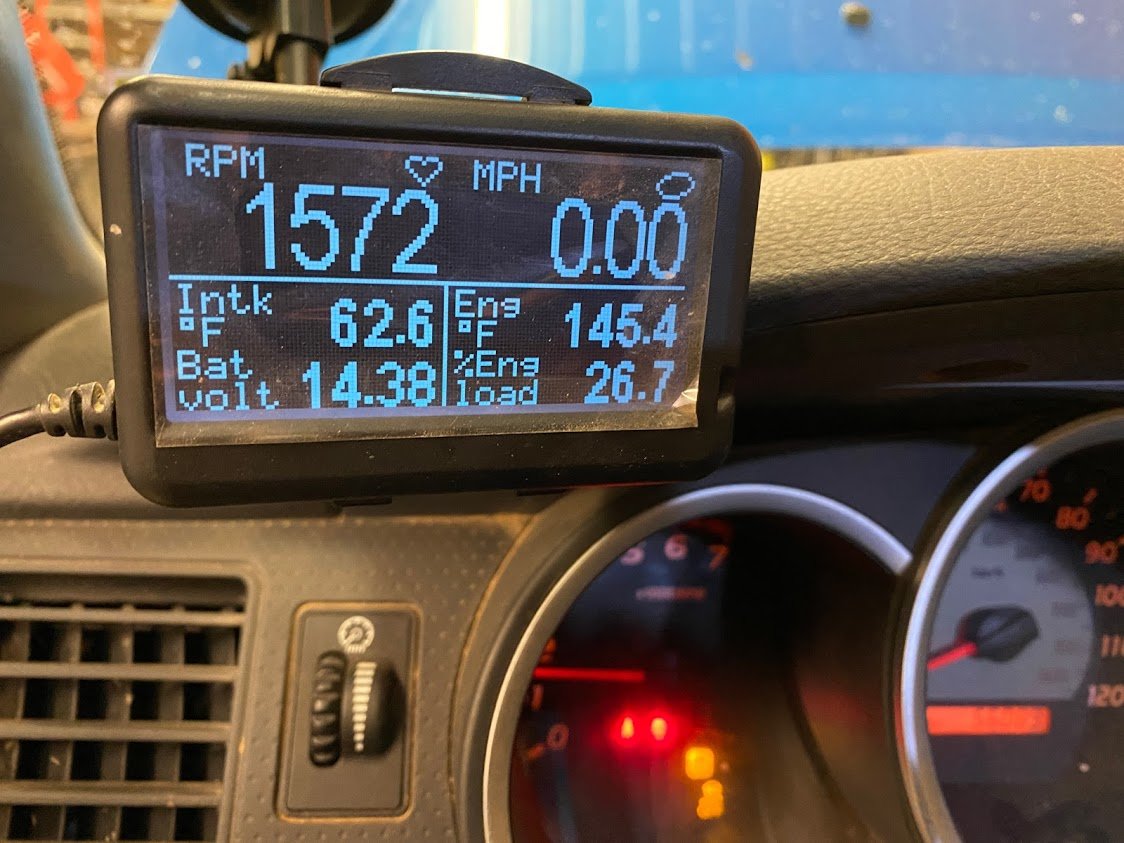

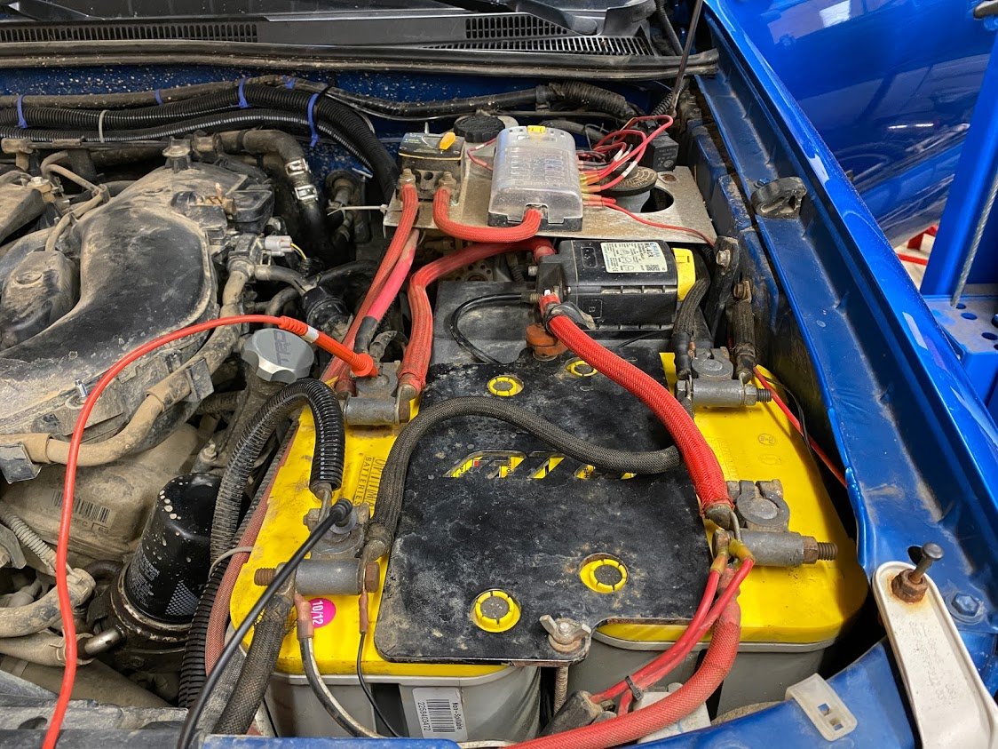

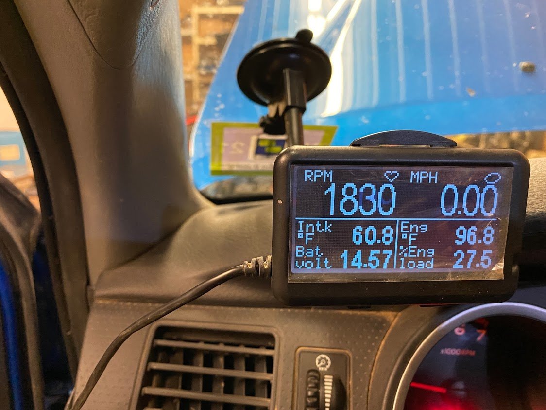

    Finally installed mine after months of sitting in my drawer :oops:
    So mine didn't come with any instructions and the first time I installed I put it in backwards and the battery light on. I didn't see any markings on the PTC fuse for which way to place it so of course the 50/50/90 rule got me and I failed lol. Swapped it around and it's pretty nice, placed it on the +0.6v setting.
    After initial start the meter reads 14.73 while the ultra gauge reads 14.57, for a difference of 0.16 VDC
    After about 5 mins run time the meter read 14.53 and the ultra gauge read 14.38 for a difference of 0.15VDC
    The setup I have is two optima yellow tops (now almost 8 years old) with a blue sea ACR; both were fully topped off and synced together before starting the truck and taking these readings.
    GonzoQuick, SR-71A, Sna and 2 others like this.
