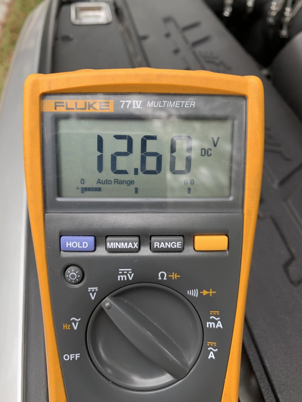

    So today after 24 hours at absolute rest, this is what my meter said:
    My Northstar 27F is 17 months old, I have been finding info on line that says that an AGM battery should have a resting V anywhere from 12.6 to 12.9. Where can I found exactly how much it should be for this AGM Northstar battery?
    Also, with the above mentioned resting voltage, where is the current charge percentage of my battery? 80-90%? 90-95%?
    Just curious where is my battery’s charge level at??

    My Northstar 34 is also 12.60 and it's brand new, but i haven't put in the replacement fuse which ups my charging voltage of 13.8 when driving.

    If you are concerned get it tested for free at a Parts store for its Cold Cranking Amps. I wouldn't worry about it.

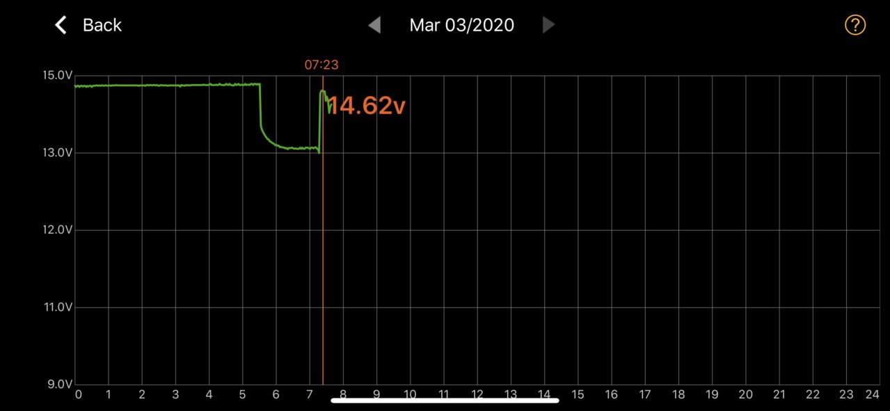

    Installed a new X2 Premium 27F yesterday along with the Ford 1 amp diode in the ALT-S fuse location. This morning it seemed to work great, charging at 14.62 at peak after starting the engine. Thanks for the write-up!

    Just curious and to obtain knowledge on why you didn't choose to use a voltage booster with your X2 Premium 27F battery?

    While I won't answer for him, it's the same functionality. One is a "fused" (thermal reset) diode, the other is strictly a standard diode, but they do the exact same thing.
    They create resistance which tells the alternator that the battery needs .5v more juice than it's currently receiving because the battery is extra low.
