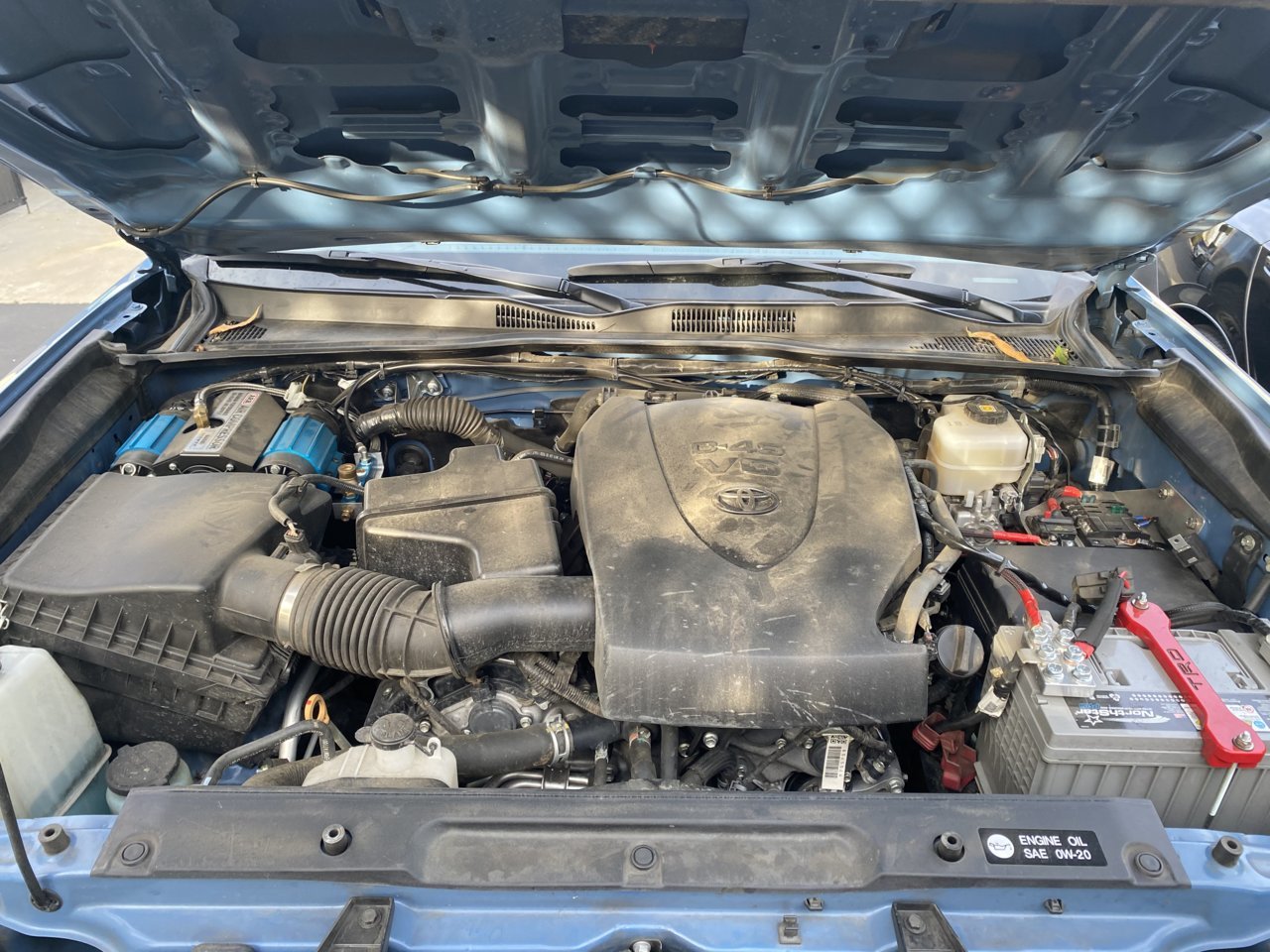

    What are those three little metal squares on the positive terminal, fuses?

    Circulate breaker for my winch, it came with it.

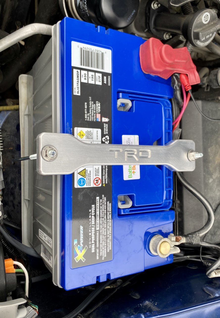

    It’s nothing special but they charge like 30-40 bucks at the dealershiP for a piece of plastic. However it fits perfect and doesn’t need any trimming. If you do go to 27f I believe the stock tie downs will not work.E572275F-13D3-4682-9AB7-8E5CA6FDFDCE.jpg
    on a side note, I’ve never trickled charged my battery since buying new from the group buy in July or august. Lately The truck has been having trouble turning over when the truck is parked overnight/ or longer. Could the battery have been drained that fast? Only accessories I have are a compressor, light bar(which rarely gets used) and a front camera. I do plan to invest in a stationary trickle charger but this still seems odd as the battery is still considered “new”, no?

    I’m not an expert, but from everything I read, I think with no way to boost alternator voltage on the 3rd gens it’s going to always be charging an AGM battery too low. Possibly that’s the cause of a potential early failure?
    I just bought a CTEK MXS 5.0 charger and it seems like a good piece of equipment for the price. I hooked it up to my 27f AGM when I got it home and it did take quite a while to charge all the way up. I assume it had been sitting a while. It has an AGM mode so it charges at the correct higher voltage ranges.

    @Toki your Northstar should actually have the acceptable charging and float voltages printed right on it. Youll probably want to get a good charger with a dedicated AGM mode to account for the higher voltage
