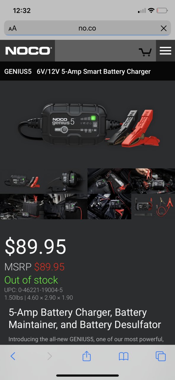

    I ordered the g5 off Amazon.

  17. Mar 15, 2020 at 9:12 PM
    #557
    BOMBS
    BOMBS Well-Known Member
    Jun 22, 2018
    #257154
    1,427
    2017 Black Tacoma TRD Off Road
    I'm not familiar with the g5. What is that?
  18. Mar 16, 2020 at 12:33 AM
    #558
    Toki
    Toki Don’t get killed by Theta.
    Mar 28, 2018
    #248758
    532
    Jon
    San Jose, Ca
    2018 Tacoma 4x4
    Little bit of this and a little bit of that but stock af.
    Noco genius 5
    it’s cheaper on Amazon and is in stock.
    BOMBS[QUOTED] likes this.

    I'm not familiar with that exact model, but make sure you get one that has a specific AGM mode. Again, for the higher voltages that AGM batteries want vs standard flooded lead acid
    Edit.. It does have an AGM mode :thumbsup:
