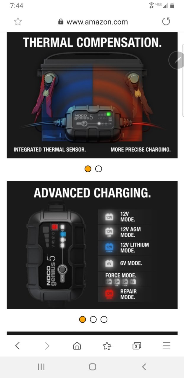

    I'd just looked it up on Amazon and it shows it does have an AGM mode.
    So my next question would be: How often are you suppose to charge your AGM battery? Every night at the end of your day?

    I want to say I have a Noco 3500. Has all the modes I would need for the different batteries in my fleet. Been a while since I looked, but I want to say there were "smaller" aka cheaper models that still have the cold/AGM mode.
    And now that I have a booster in the truck, I don't use the charger too much any more.

    I believe this model is the newer/smaller version of what you have.

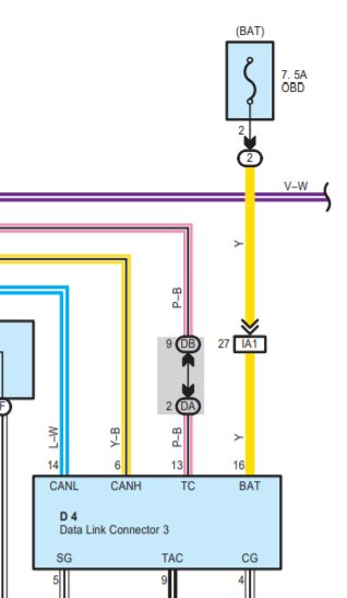

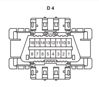

    it reads off the ECM not OBDII voltage, you could check the OBDII pin to verify at pin 16.

    Do you know if thats universal for SGII and UG, or just for the Ultra Gauge?

    I have no idea, I just went to the UG website and it specified it. "Battery Voltage (Measured by ECM)"
