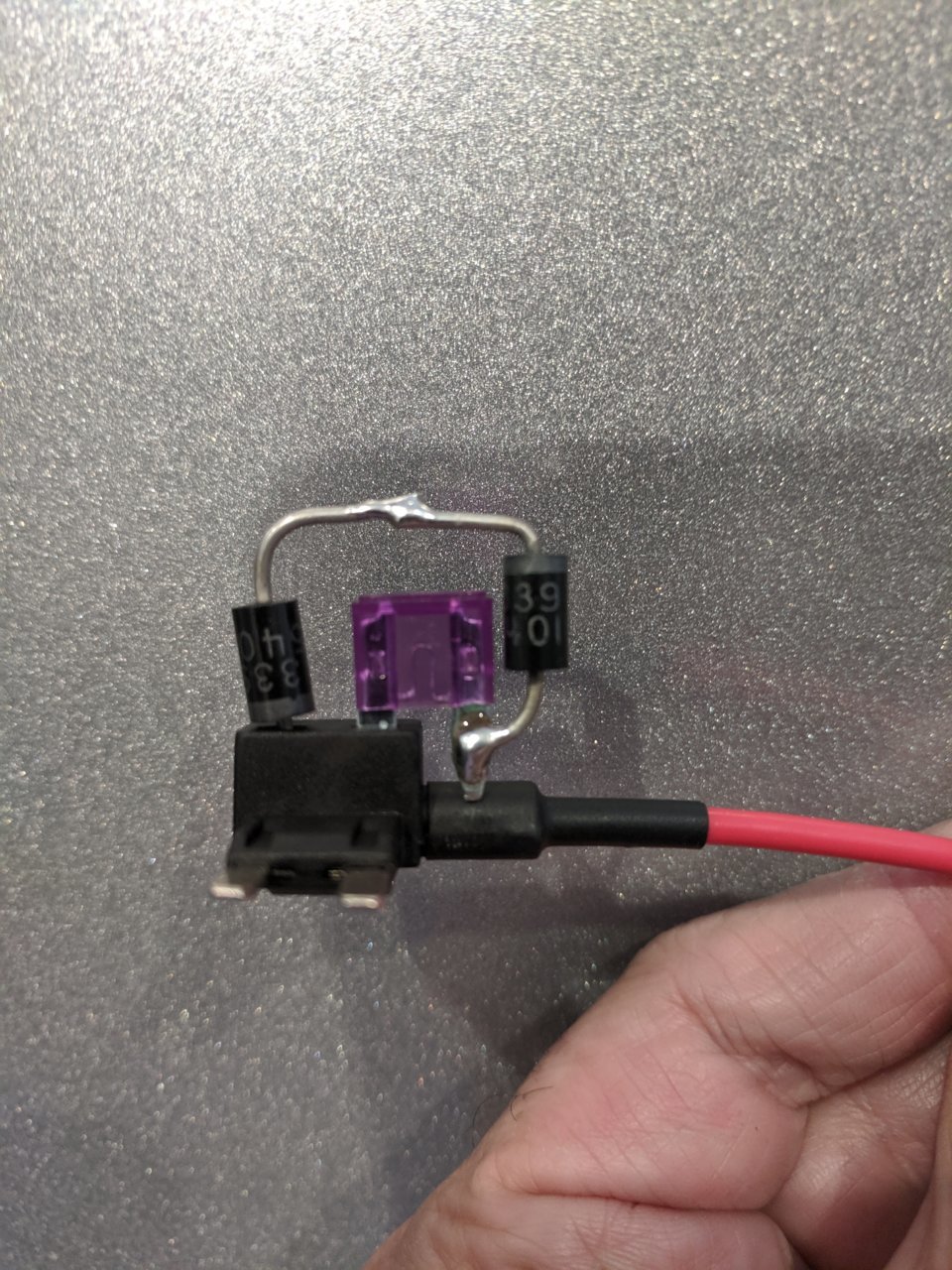

    Anyone think this is a viable option or because it is a 3A diode it would provide too much voltage boost it is also a 6A fuse so it provides the protection
    Edit: The voltage drop across a diode always is 0.7 so I see where it could work and having a 6A fuse it offers protection. Now just need to see it it is a PTC fuse
    CB229 Transorb, resistor and diode electrical protection devices easily install in common ATM fuse holders and blocks. These circuit protection devices provide voltage and current limiting functionality and are designed for the onand off-highway requirements of trucks, RVs, construction, agriculture, ATV and material handling equipment. • Transorb - Protects against voltage spikes. • Clamp rating: 27 Vdc • Power rating: 1500 W • Resistor - Drops circuit voltage. • Power rating: 5 W • Resistance: 68 Ω • Diode - Prevents reverse current flow. • Amp rating: 6 A
    https://www.waytekwire.com/item/46882/EATON-s-Bussmann-Series-22903-6-MINI-Diode/

    +0.7v is a little on the high side, you will likely exceed the peak cycle service charge of 14.8v on a cold start, and you don't want to overcharge your AGM. +0.6v is the highest I would go, but I really think +0.5v is the sweet spot. Of course this is all based on your charging system being in perfect working order.

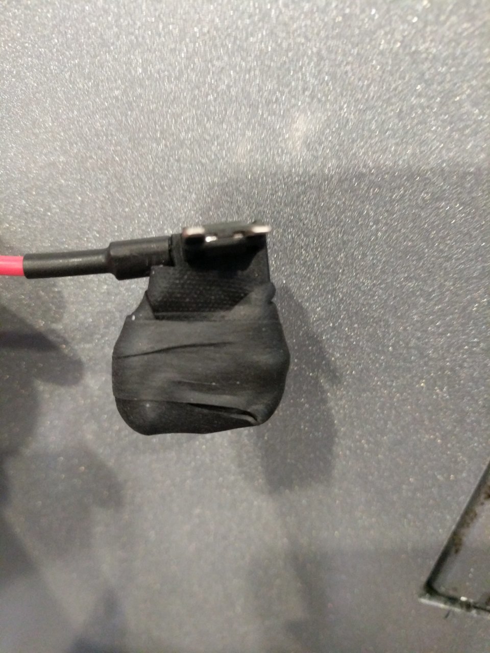

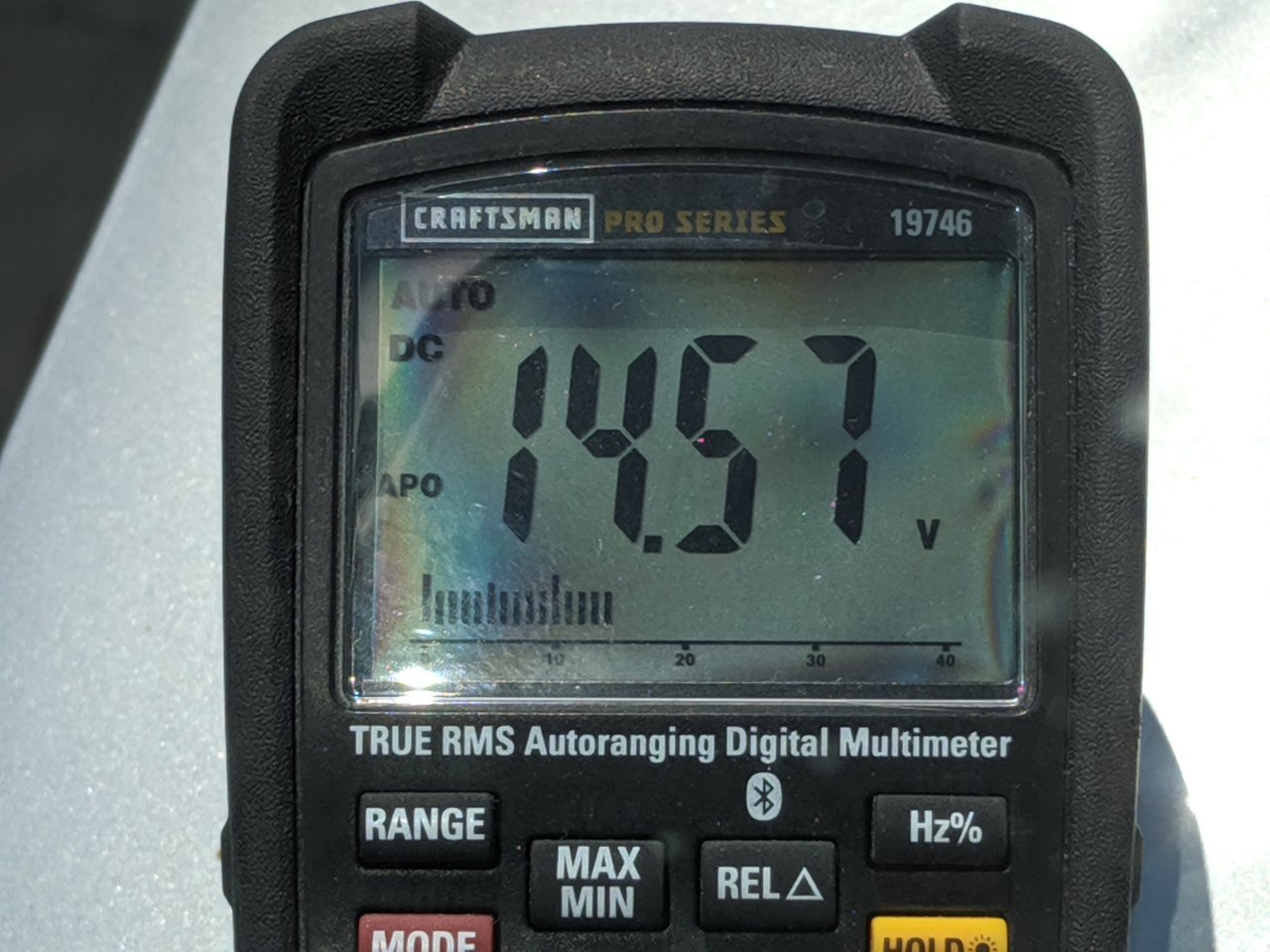

    Ended up making this with a fuse tap, 2 100v 3a diodes and a 3a fuse, probably for about $2 and it did not take 6 weeks. Wrapped it with 3M 600v electrical tape
    EDIT: I ended up with just 1 Diode 2 pushed the voltage to the battery too high for me now I am at 14.4 - 14.5 peak before I saw 15v and then cut a diode out of the build

    There is certainly more than one way to do it. :) Be sure to check your readings on cold start after the truck has sat overnight, as that is when you will regularly see the highest voltage reading.
