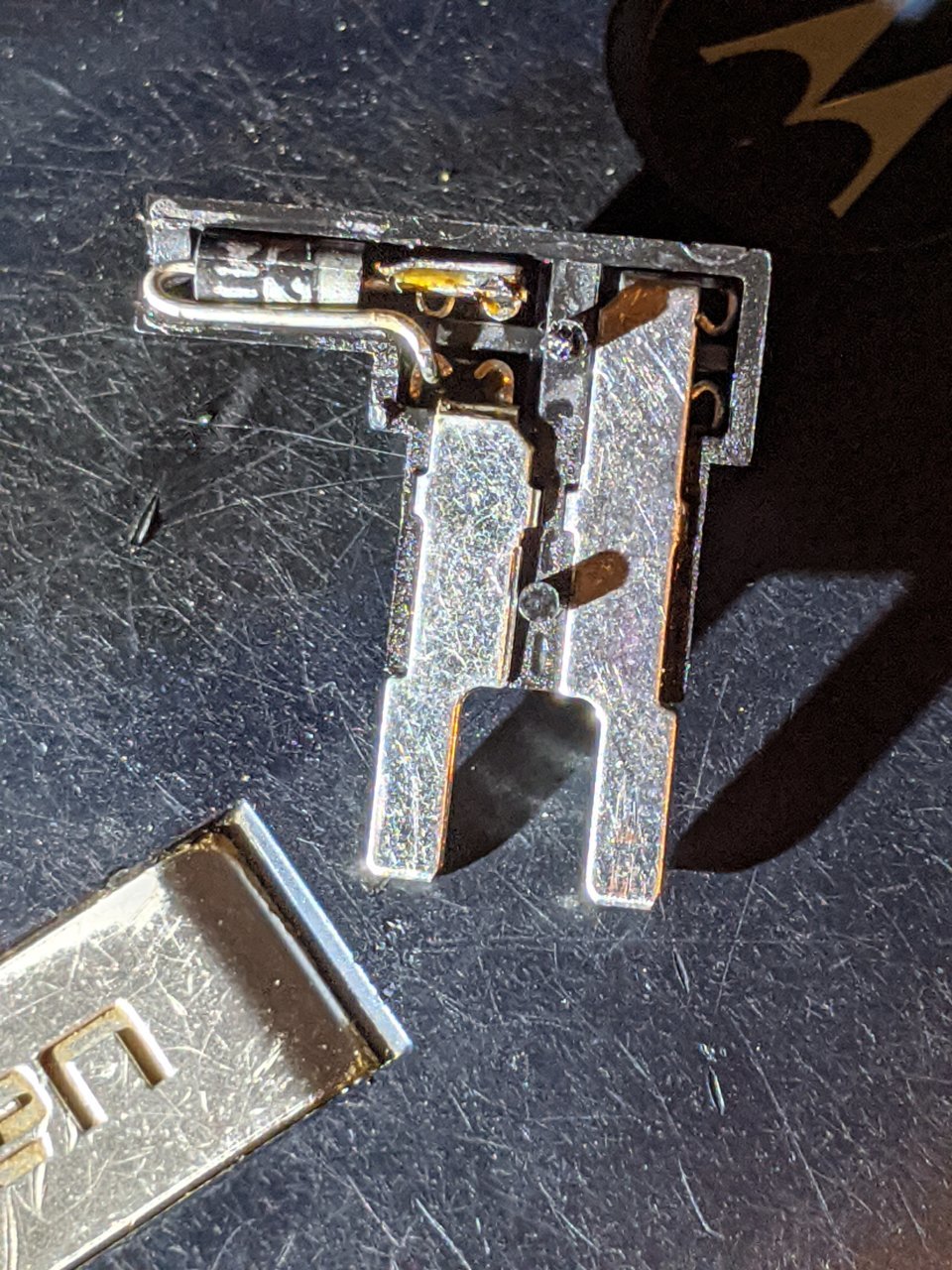

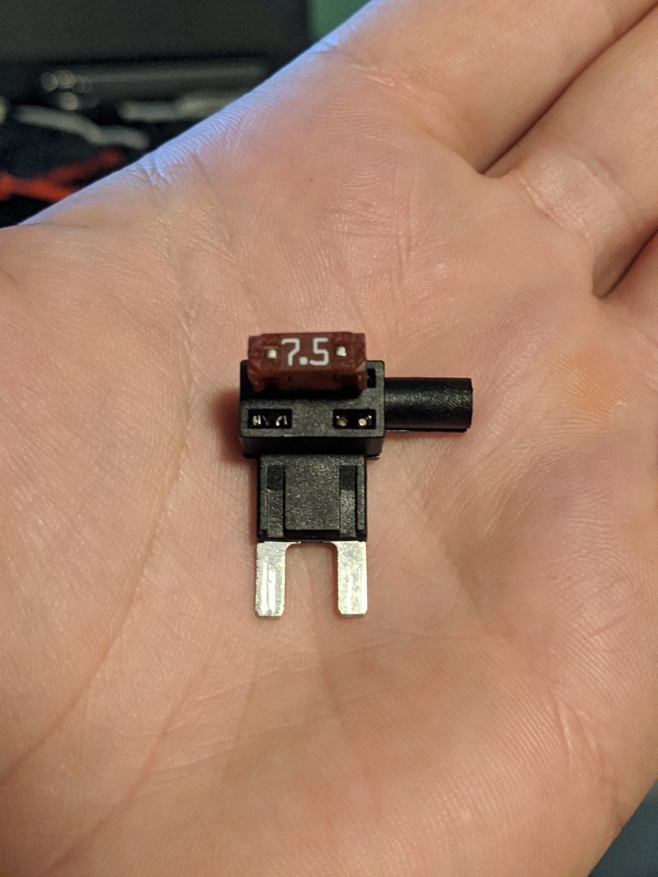

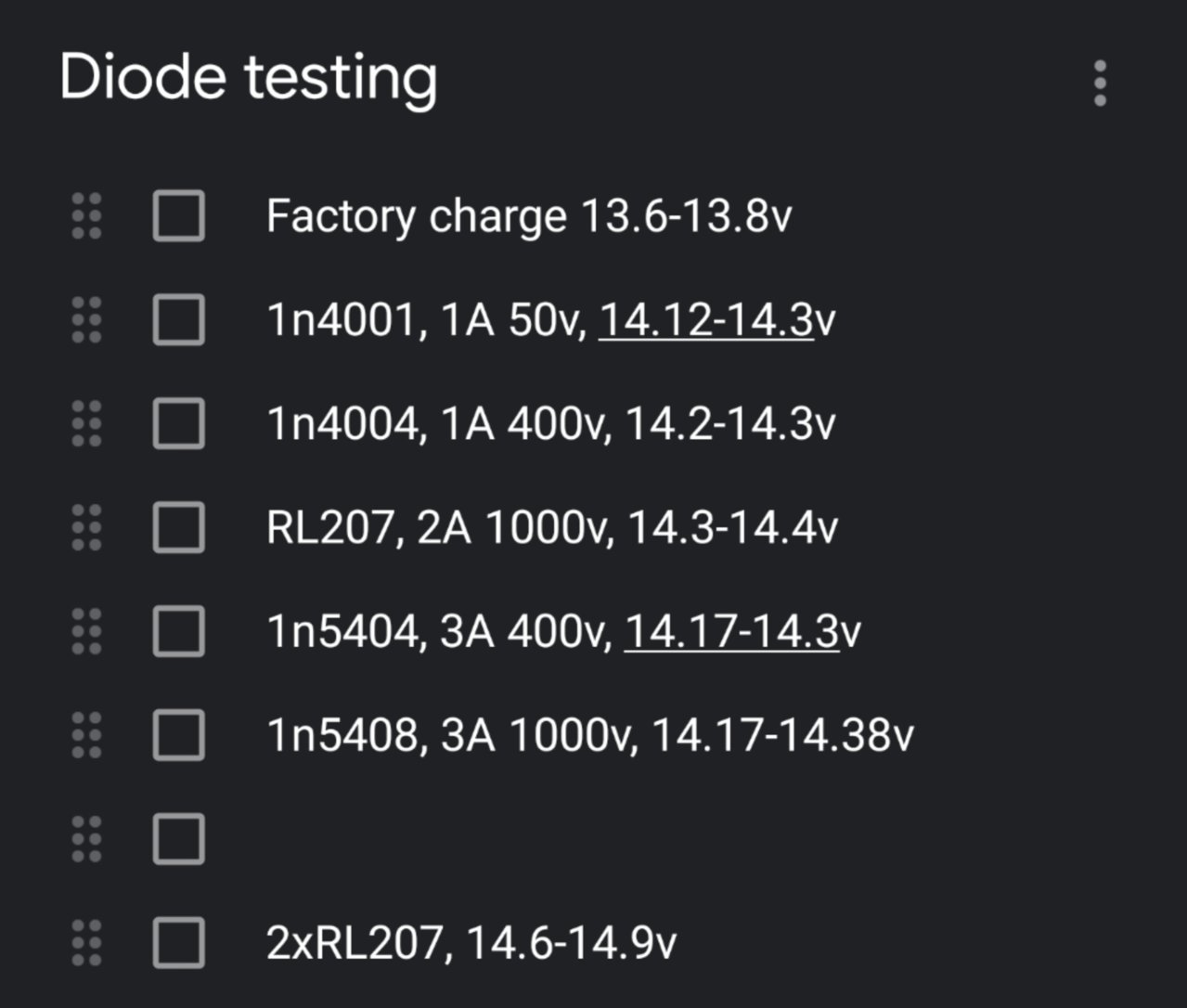

    Here's a little testing I did. Only the starting battery connected, fully charged 2 days ago, like 80* out. Pretty much saw a 0.5v increase across the board using a multimeter. Low side was at idle and high side was at 2500rpm.
    1n4001-1n4007 = 1.1 Vf(1A)
    RL201-RL207 = 1.0 Vf(2A)
    1n5400-1n5408 = 1.2Vf(3A)

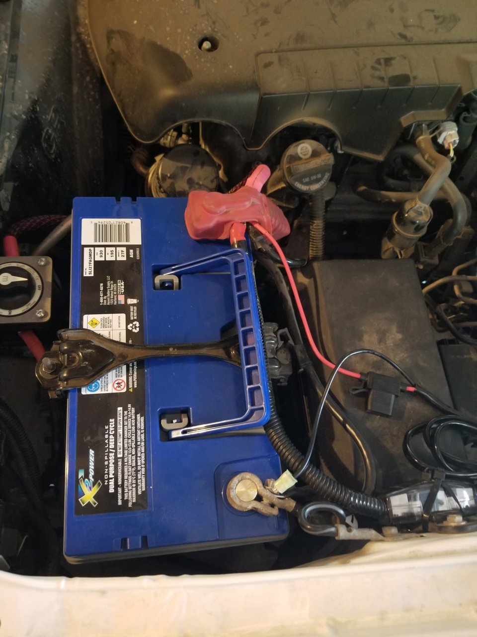

    Oof. Just emailed the seller on Ebay asking for an ETA for the voltage booster I ordered a month ago. They said probably about 4 months from when I ordered. That's a bummer as my new X2 battery is just sitting on my counter. Don't really want to install it until the voltage booster arrives. Any recommendations for keeping it healthy during my wait? Proper trickle charger? If I installed it and plugged it in and trickle charged it during weekends would it be ok? From previous posts I'm guessing yes.

    Sucks kangaroo land post is getting hit so hard with this.. You'll be fine to install it. Many people don't know or care that they need a higher charge and the batteries don't implode. An occasional full charge would be good.

    Voltage booster showed up, only took 2 months. Not too bad in the long run! Voltage when cold looks to be at 14.7 and when it warms up sits about 14.3
    Definitely happy with it so went ahead and installed the X2 battery today.
