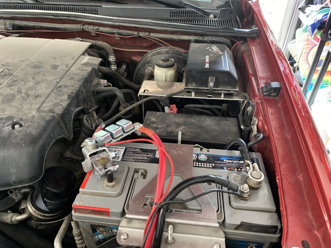

    Just ordered a northstar battery group 31 from gpcaraudio for $378 total. I didn’t think the extra 8 pounds difference in the group 31 over the 27 would be a big enough difference in weight versus the actual spec difference in power ratings personally so although I probably won’t need the 31 I got it just in case for $25 more roughly. I have a noco genius 5 charger mounted underneath the hood on my truck that I’ve got hooked up at all times to my blue sea fuse block which goes directly to my battery. All I have to do is plug it in an AC wall socket to charge and it has desulfurization smart mode built into it

    So i just received my north star group 31 today and by just eyeballing it there is no way this thing is going to fit my 2017. Aren’t some running 31 in 3rd gens or did i screw up and order a $375 battery that isn’t gonna fit?

    I cannot comment for 3rd Gen fitment in the stock location, but that is a lot of weight for the OEM tray. Other members have had their sheet metal and welds tear/crack. If using a Group 31 I’d look at a remote mount.

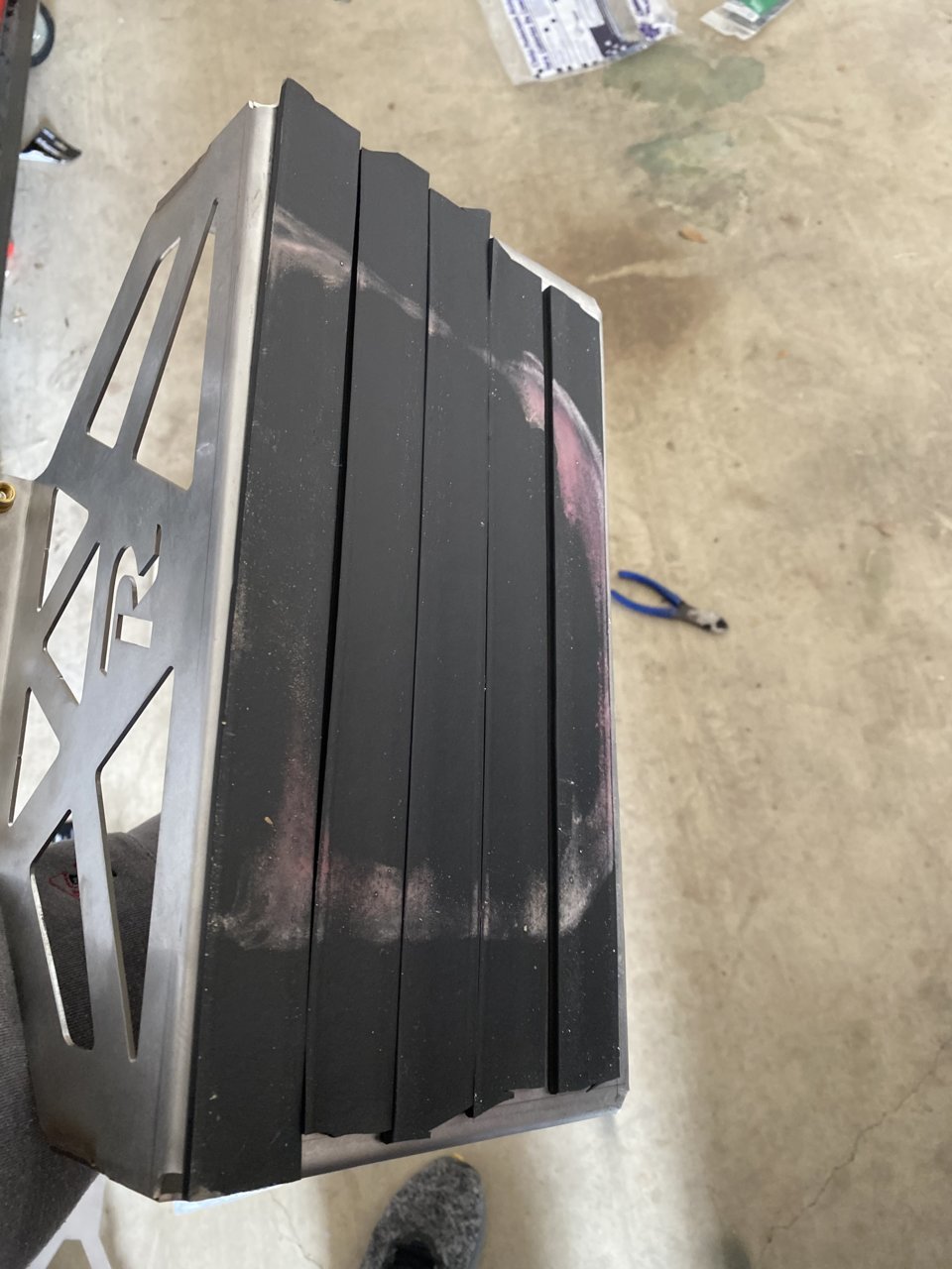

    It’ll fit you’ll need to get a battery cage and longer tie down hooks. Granted I’ve got a 2nd gen I used Rago’s battery cage it’s a solid product.
    I also put some thick weather stripping across the bottom so it’d have a bit of dampening and no metal/metal contact. upload_2020-10-8_11-3-23.jpg

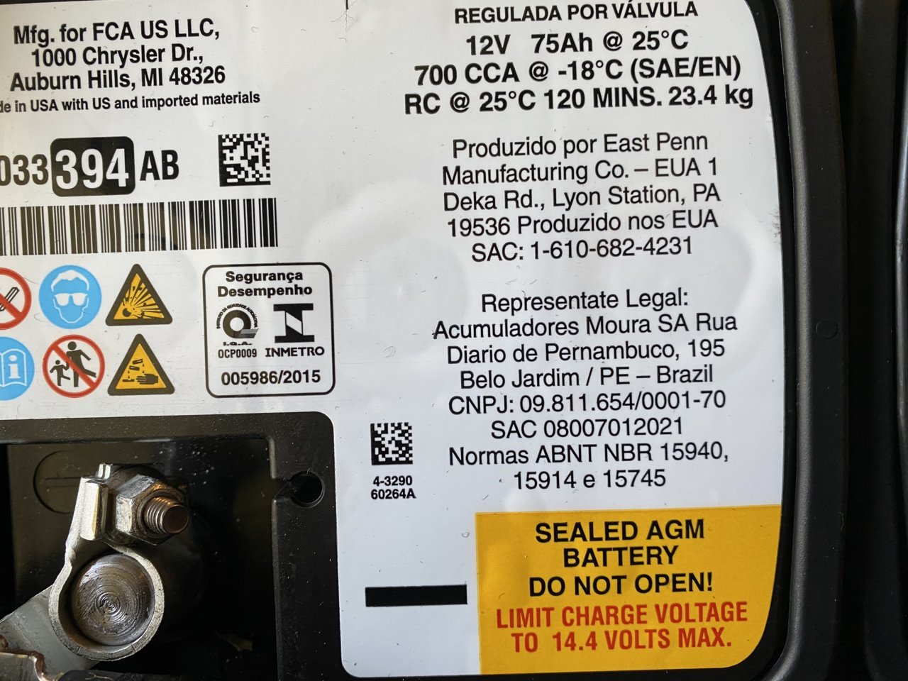

    So this is interesting, not sure what to make of it. The 240A alternator package in the Gladiator comes with a factory AGM battery, but the battery says in bold print to limit charging to 14.4v, which is the peak charge voltage for a traditional lead acid battery, not the higher voltage for an AGM.
