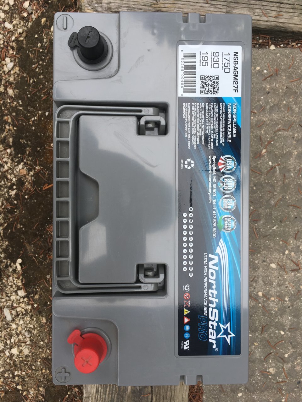

    Ideally the primary and secondary battery are the same size, type and age. In a dual battery setup, I'd consider running a smaller primary battery such as the 24F rather than the larger 27F which will provide less weight on the nose/tray and a closer match to the secondary battery. Unless you have a winch with extreme power draw that you are using often, if you have a secondary battery there is really no need for such extreme power reserve in the primary battery that the Northstar 27F offers. The 27F Northstar primary battery recommendation is geared around those seeking maximum battery performance from a single battery.

    Gotchya. Thanks so much for the input. I was really sticking with the 27F since that's the stock size in my rig, although a lighter battery would be nicer. I will be getting a winch here soon as well and thought that would be another reason to stick with the bigger battery. I won't be using it THAT much so maybe a 24F will be just fine. Will a 24F still be adequate for the occasional winch pull?
  13. Nov 13, 2020 at 9:41 PM
    #753
    crashnburn80
    crashnburn80 [OP] Vehicle Design Engineer
    Jun 6, 2015
    #156893
    14,772
    Kirkland, WA
    2003 DCSB TRD OR
    Keep in mind the Northstar 24F is more powerful than the stock lead acid 27F.
    Stock 27F: 625 CCA, 130min RC
    Northstar 24F: 840 CCA, 160min RC
    So yes it will be able to run a winch without issue, if you connected your dual batteries in such a way the power could draw from both you'd have enough for some pretty good pulls which is what I'd aim to do since you will have the battery capacity under the hood.

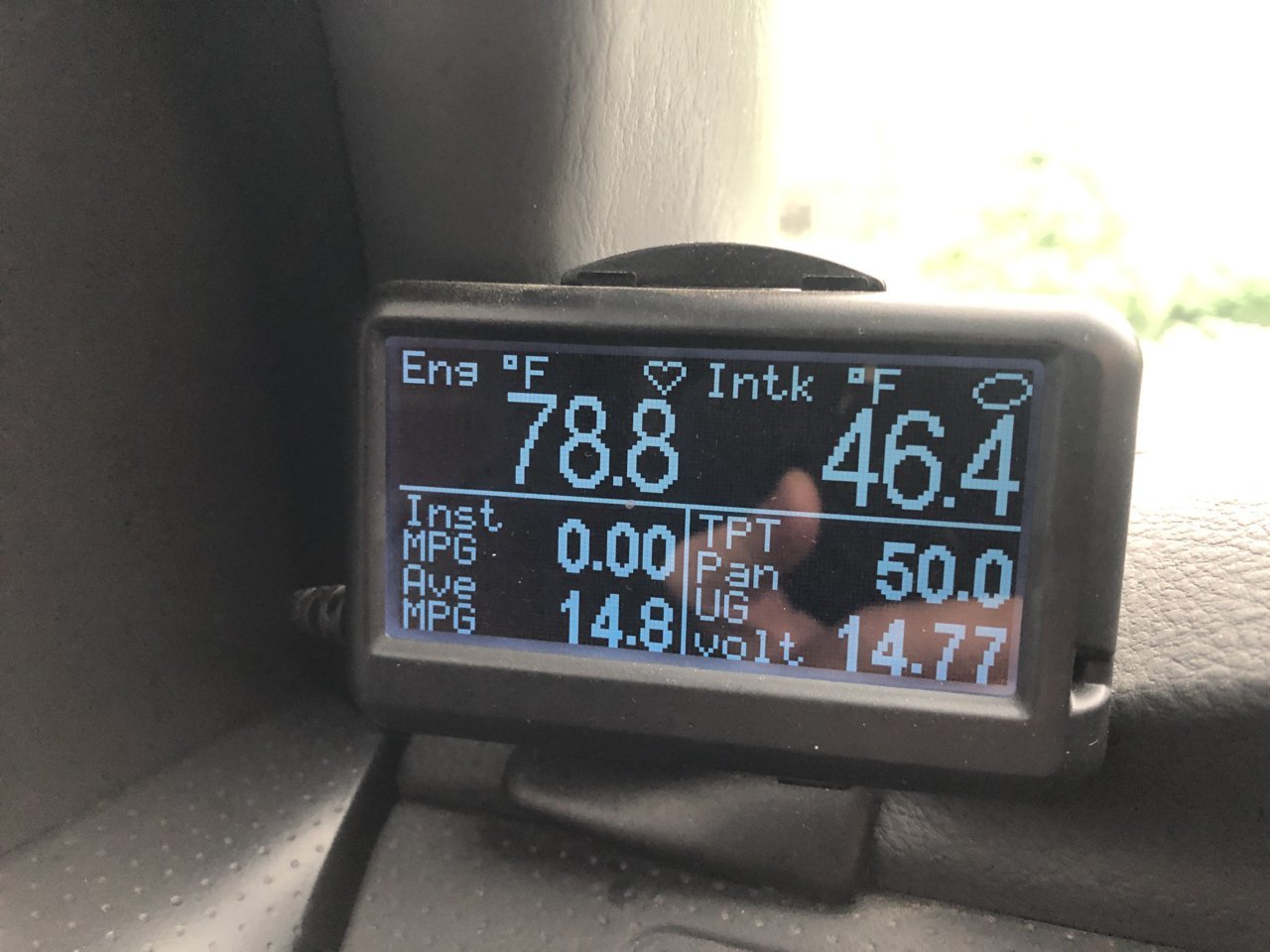

  15. Nov 15, 2020 at 10:16 AM
    #755
    SaphiraTaco
    SaphiraTaco Well-Known Member
    Feb 8, 2018
    #243869
    483
    Sean
    Seattle WA
    2013 DCLB TRD Sport
    About halfway done...
    So quick question about peak voltage. During cold start up when I haven’t driven the truck in a few days my voltage is up to 14.77-14.8
    Is that to high?
    I usually refrain from turning on any lights until the alternator settles down a little bit.
    I have the variable voltage booster so I could adjust the switches to reduce if needed.
  16. Nov 15, 2020 at 10:28 AM
    #756
    crashnburn80
    Jun 6, 2015
    #156893
    14,772
    Kirkland, WA
    2003 DCSB TRD OR
    About right on target for a cold start. Peak should be no higher than 14.8v.
    SaphiraTaco[QUOTED] likes this.

    Also in the fine print on the battery is says 14.4 to 14.8

    Thats the one reason I wish I had the adjustable booster. I would knock it down a notch in the winter. Think the highest Ive ever seen is about 14.9V on a cold start right around 0*F
