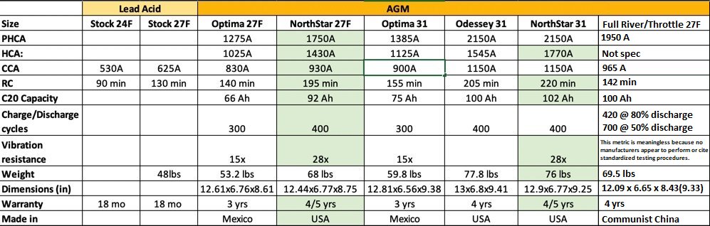

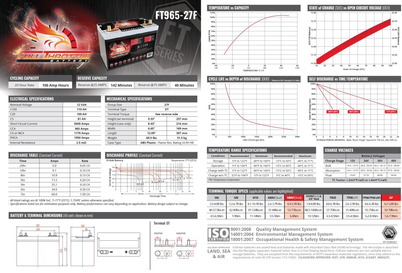

    In addition to the excellent summary of battery options presented by @crashnburn80, I would like to bring an additional seemingly less-known battery option to the attention of TW readers: the FullThrottle 27F AGM battery (from FullRiver).
    Disclaimer: I have no association with the manufacturers, distributors, or marketers for the battery(ies) discussed here. I in fact am very happy with the Northstar 27 battery in my truck and can wholeheartedly recommend it. Also, sorry if this battery option has already been posted, I'm not going to read 38 pages of this thread to see if it showed up. But I couldn't find it by search.
    Anyway, I stumbled across these FullRiver/FullThrottle AGM batteries while researching battery options for my commuter car, whose Bosch conventional (flooded) lead acid battery just shit the bed only a few months beyond its 36-month “free replacement” warranty window expired. And despite its "96 month prorated warranty," it'll cost me $120 to replace it (including the prorated discount!) The now-dead one only cost me $100 in the first place -- what a racket!
    So I am strongly considering this FullThrottle AGM. SoCal heat just kills conventional batteries, I've never gotten more than 4 years from a car battery out here. (Also, Northstar doesn’t make one in a compatible size for this car.)
    Here’s the downside: this battery is made in Communist China. But you can buy them from mainstream US vendors that will stand by their warranty (such as the huge online one that sends you collectible magnets with each order). And the technical specs provided for these batteries are nothing short of amazing. Just look at this spec sheet for the 27F:

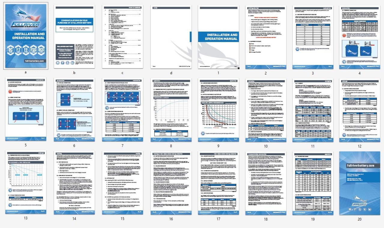

    On top of that, they offer a detailed manual for operation and maintenance of their AGM batteries. I mean, look at this, it’s 18 pages of shockingly useful technical information:
    (note this is just a screenshot, you can download the PDF from their site.)
    I can’t find anywhere near this level of technical detail from any other manufacturer. Honestly I would buy from this company vs. NorthStar or Optima simply because they offer a proper spec sheet for their product, instead of a bullshit promotional flyer made by a graphic designer or something. I'm an engineer and I value information a lot, especially compared to useless promotional bullshit. Let's compare this to the data available online for the NorthStar 27F:
    Notice how there are only a handful of specs, and zero graphs. But wait, what's this on page two? A notional diagram of a car, showing things that might be in a car, and approximately where they might be? How the fuck does that help me decide what charge voltage to use on this battery?!? Get your fucking act together, NorthStar!
    Enough ranting. The FullThrottle 27F has very competitive specs vs. the NorthStar and the Optima, and as of this writing, it costs a fair amount less. OP, your insightful comparison helped me pick my NorthStar 27F last year. To help future readers consider their options, please consider including this poorly updated chart that I made in MS paint (or otherwise including this data) in your first post:

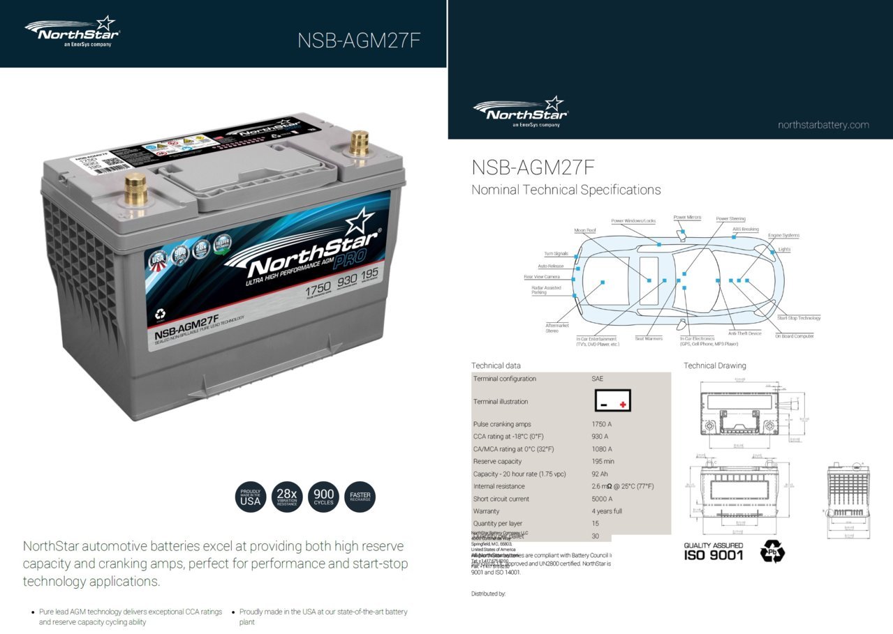

    Very interesting find, I've never heard of this manufacture but from the looks of it they are newer to importing to the US. And talk about fantastic specs charts/data sheets! I wish all products would include such extensive technical documentation. Agreed that Northstar has a lot of room for improvement by comparison in their provided documentation, those Full Throttle docs are amazing. I have been able to call NorthStar and speak directly to a technically knowledgeable person on the phone to get whatever technical information I need as well as discuss battery design, certainly not the same, but their customer service was impressive.
    While the Full Throttle battery has some good specs, a few things stand out to me. Arguably the two most important specs people look at when comparing AGMs is CCA and RC. How much cold cranking power does the battery have, and what is the power reserve capacity. By the Full Throttle specs their battery comes in at 3.7% higher in Cold Cranking Amps than the NorthStar 27F. It is higher but relatively speaking negligible. Many people run AGMs for the Reserve Capacity, whether that be for accessories/lighting when camping, or the extra power reserve depth for high draw applications like winching. In RC the Northstar comes in at 37.3% higher in power reserve capacity than Full Throttle. While the CCA is difference is trivial, the RC difference is huge and in NorthStar's favor by a landslide.
    I don't buy or recommend products for warranties. People that post that you can buy some low quality battery with a great warranty and that makes it a good deal do not align with my philosophy on automotive components. A single failure that leaves you stranded, hopefully not in the remote wilderness, is not worth whatever costs savings may be repaid by a free replacement battery that will likely repeat the same event. Optima's batteries look ok on paper, certainly better than stock. But what you don't see in the specs is product build quality. As soon as Optima moved production to Mexico to reduce costs, quality tanked and product reliability fell off a cliff. The specs still look the same, but the product is not reliable in the way it used to be and that isn't visible on paper. NorthStar on the other hand has set the bar in battery quality and reliability, manufacturing their batteries in the US. Similarly, while the China made Full Throttle battery might have some good looking specs, that doesn't mean it has the same level of build quality and reliability as NorthStar. While there is nothing fundamentally wrong from a manufacturing standpoint with manufacturing in China, I've lost count of how many Chinese manufactured products I've tested that have failed to meet their specs and/or had falsely inflated specs.
    Then there is price. The China made Full Throttle 27F appears to cost $385 from most retailers. The USA made NorthStar 27F cost $360 under the X2 Power label, before rebates and/or the 10% online purchase discount. So the world class USA battery manufacture with significantly better power reserve is also cheaper than the China made counterpart.
    NorthStar also manufactures battery backup systems for enterprise environments, so it is always interesting to see who trusts their critical backup systems to a manufacture:
