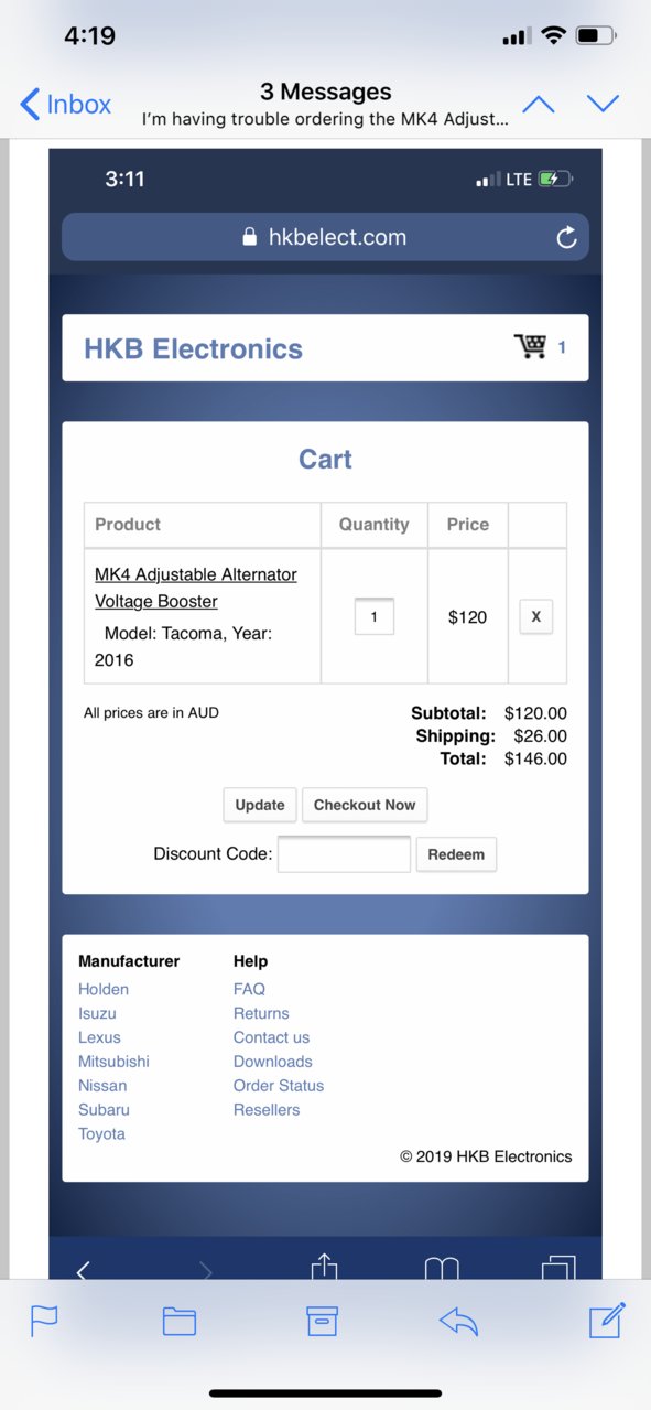

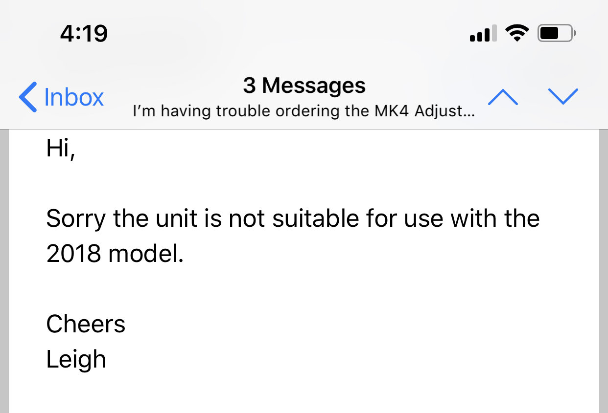

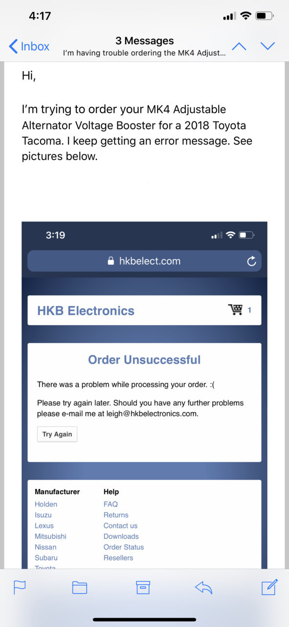

    Here is a brief conversation I had with HKB Electronics.

    Interesting being they list it as compatible with the 2016 version.

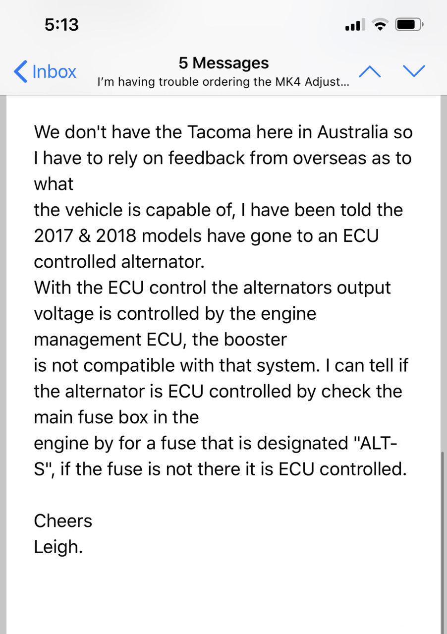

    That’s what I thought also. Pretty much the same truck, just a different year. NOT TRUE
    Update:

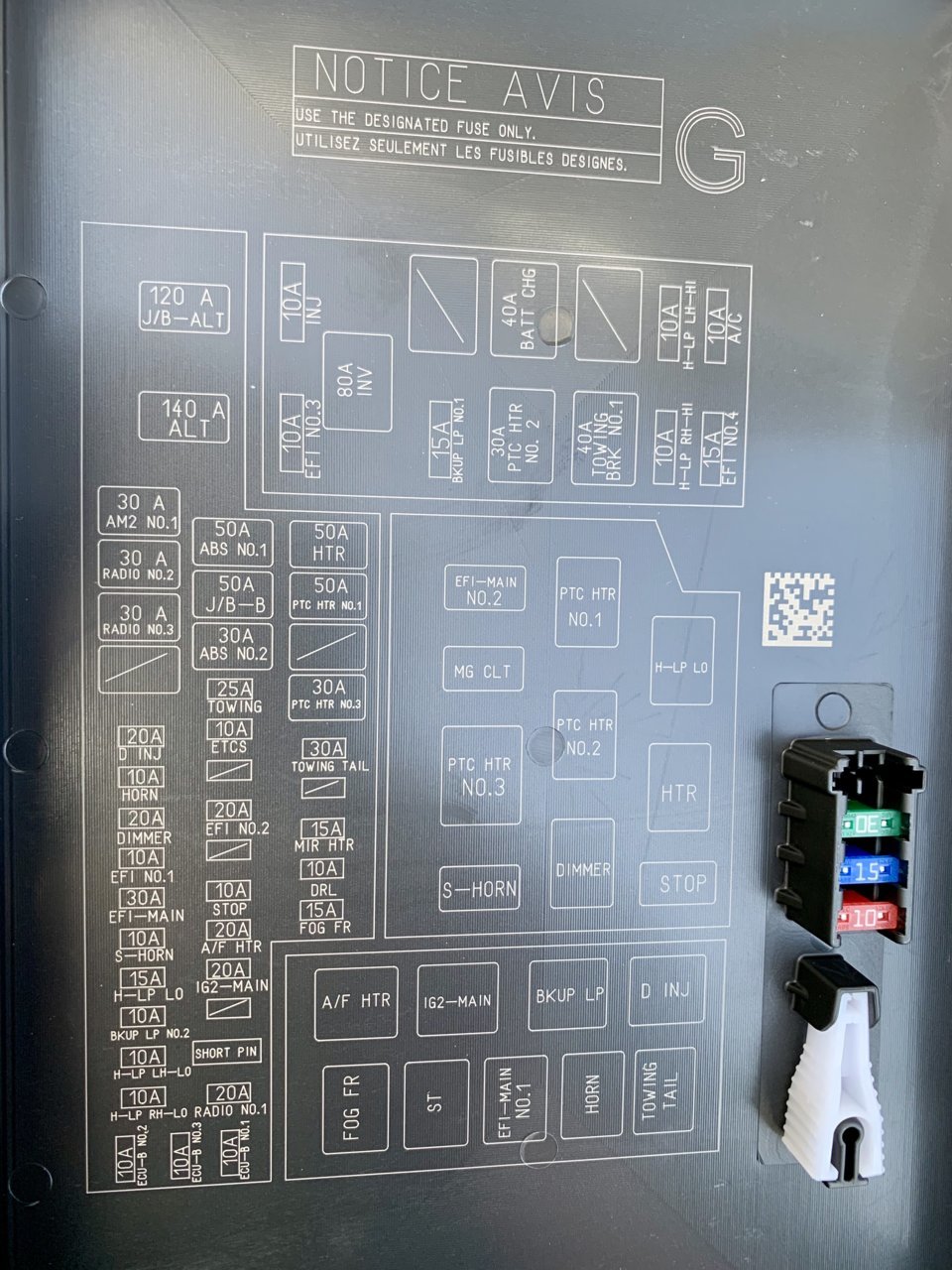

    So I can confirm the HKB voltage booster won’t work with a 2018 Tacoma. 2018’s don’t have the Alt-S fuse.
    I had a conversation with Leigh from HKB Electronics.

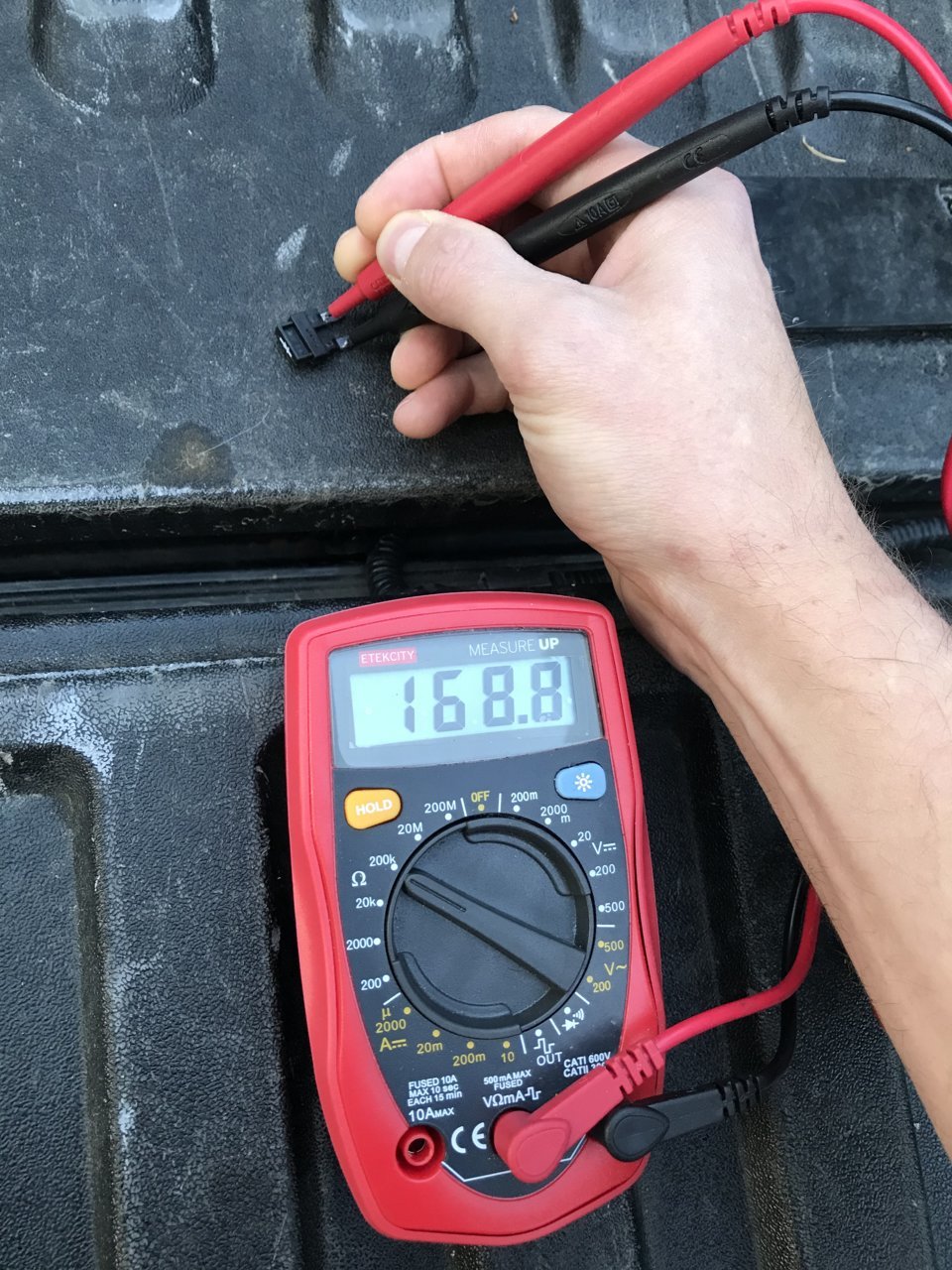

    For everyone looking for a budget alternative, 2000’s GMs use a diode which fits into our Alt-S slot. $4 at O’Reilly. I’ve been running this in my truck. Here’s a pic of me testing the resistance. Raises output by about .6V.
    The only thing to go wrong is installing it backwards in which case your battery light will illuminate. NBD, shut off truck, turn it around and be on your merry way. I’ll try and find the part number and edit my post.70643012-D413-4989-A7B1-3572F6C636BE.jpg

    Nice budget find! A diode is not a fuse though, so you have removed the short fuse protection. The HKB product is a PCI auto-resetting fuse, so it still maintains the fuse functionality, although obviously is more expensive.
