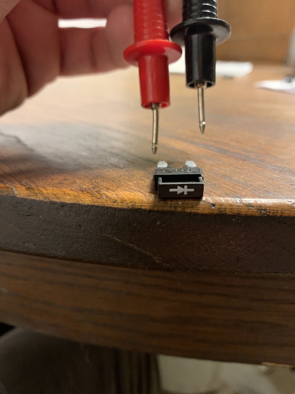

    I measured the capacitance of the diode (need to make sure you have the positive lead and the negative lead on the right legs; see picture below).
    My DMM showed a capacitance reading of 0.470nF. Then I measured the resistance and it read about 1.95 megaohms.
    All in all, I received the correct voltage when I was using it (hesitant to put it back in).
    The GM diode part number is 12135037. The diode’s purpose was for a compressor after a quick google search.
    Either way, I had my denso rebuilt this weekend with parts from a company called transpo. No idea if those parts are quality or not.
