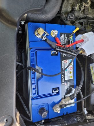

    Is there a reason I shouldn't run The X2 27M (Marine RV model with the extra terminals(what I have with my Original DieHard Platinum)) Vs the X2 27 F( which says Car and Truck)?? seems to have same specs for AH and CCA?
    Thanks for any info

    If you want the extra terminals, the marine version is fine.

    Found a reason not to buy X2 27M vs 27F. 1 extra year warranty on the F vs M model.

    Terminal orientation remains correct/the same as the 27F flavor?

    Good call, the terminals are reversed. So the 27M wont work with the stock terminal hookups.
    27F
    27M
    See above. I hadn’t accounted for the terminal reversal.
