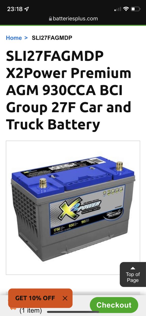

    @crashnburn80 Sir any update on this; Northstar 27F still superior to an Optima 27? Looking to upgrade my battery this winter.

    Why would you pick the Optima over a Northstar or X2?

    Definitely no on the Optima. Northstar was acquired a while back by the same company that owns Odyssey (another very high end brand), but nothing has changed that I am aware of. There was some talk they may discontinue the 27F in Pro series (Batteries Plus X2 Power), but it is still listed as available on Northstar's website. In short all the info is up to date.

    Gotcha. Just confirming this is the one you’re referring about?

    Correct.
