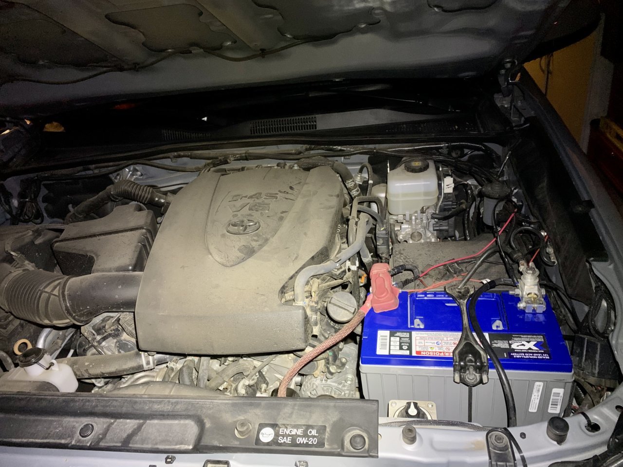

    Woot, new battery.

    That was easier to find than "where's Waldo" dang do you drive in the mud with the hood open.....:mudding:

    Looks like dust, not mud. Means it’s doing truck things.

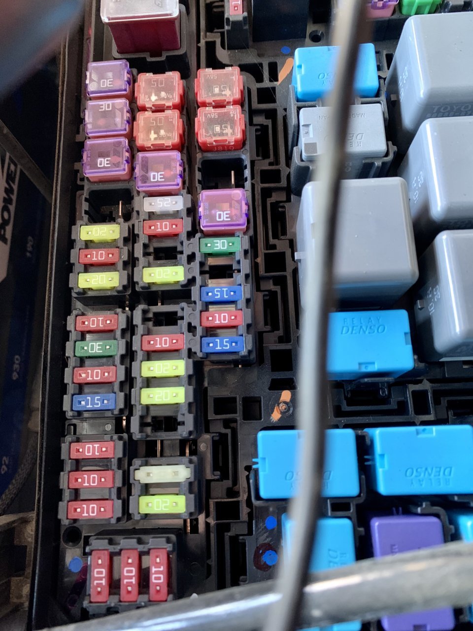

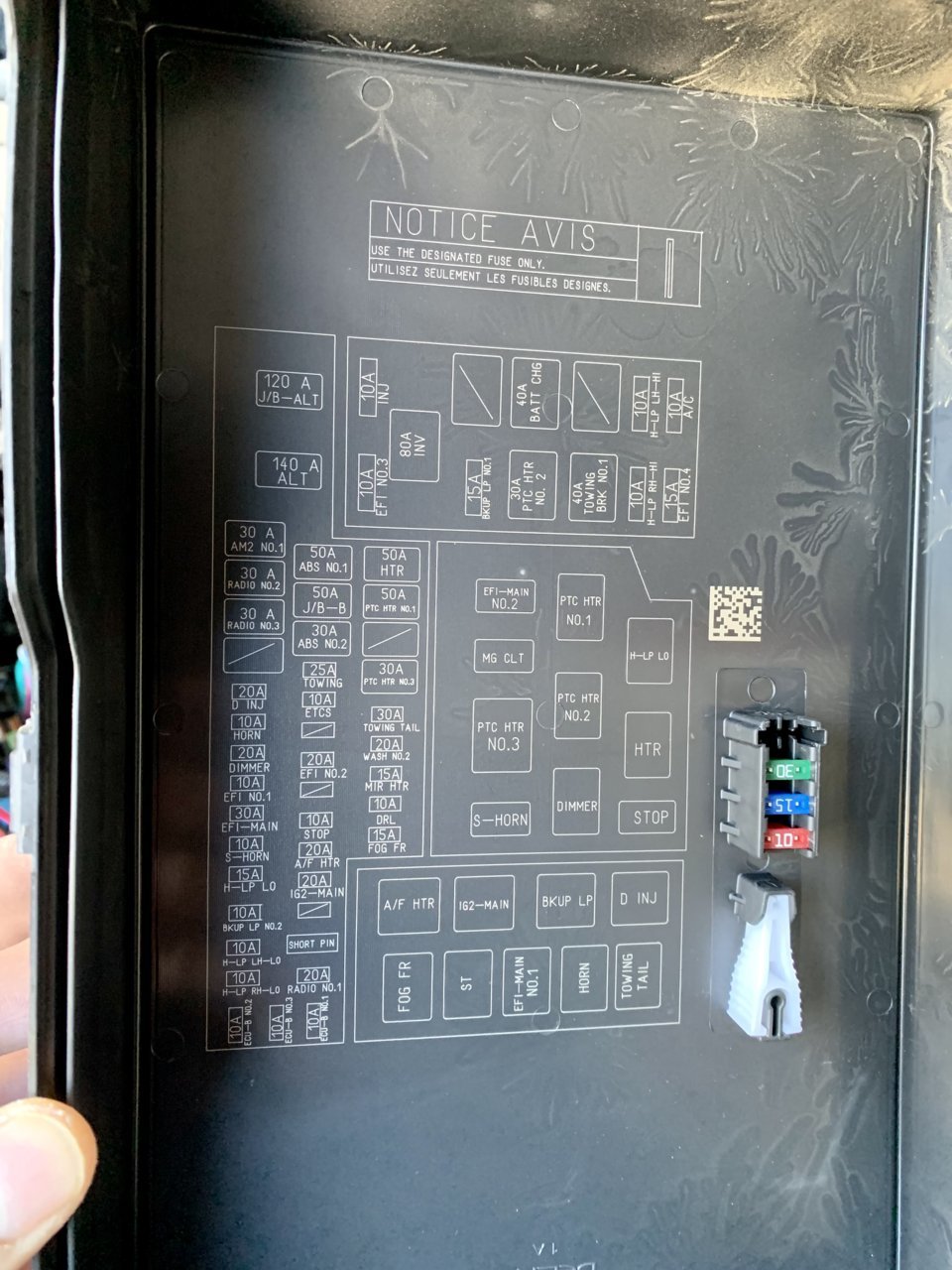

    Attempting to instal the HKB fuse and noticed I don’t have the 7.5A ‘Alt-s’ fuse. OVTune the only solution?
    4438A06E-4AA6-4821-A4EF-1E750C862700.jpg 972B8792-00BC-42CC-B2A5-E5D9BB56486E.jpg

    Yep it won't work on a 3 gen Tacoma 2016+
    From the first post
    In some newer vehicles like the 2016+ Tacomas, the voltage is regulated by the ECU, meaning no voltage regulator Alt-S circuit to spoof. The ECU can be reprogramed for 3rd Gen using OV Tune and likely others, see post #3821 here for details.
