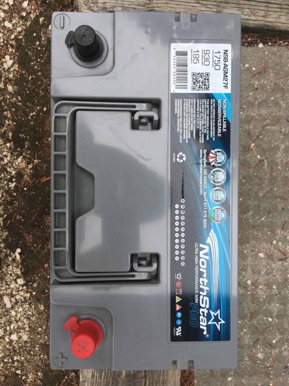

    Doesn't work with 2nd Gen Taco. I purchased 2 of them to mod to work, ended up giving to locals to try in FJ Cruiser and 3rd Gen Taco...

    Oh yeah I didnt even think about that, the ALT-S fuse is over on the edge of our fuse boxes isnt it

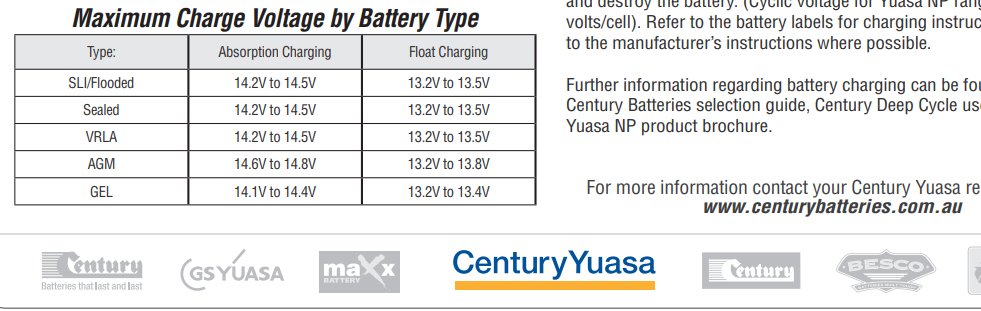

    AGM batteries specifically need to be charged at a slightly higher voltage. This is a random article (from a battery manufacturer) that gives you a rough idea. I would be hesitant to believe that the boosted voltage caused issues for you.
    https://www.centurybatteries.com.au...alk/issue-2-battery-talk-battery-charging.pdf

    But do they like to be charged at that higher voltage all the time?

    All depends. Mine was pegged @ 14.8V but it was -30+ this morning . When it’s cold like that it takes a while before levelin’ off.

    Yeah, the charging voltage should drop off as the truck warms up. The idea being when you first start the vehicle the voltage is a bit higher. Aka its in that 1st phase which tops off the battery after some of the charge was used to crank the engine over. As it warms up it drops into that lower voltage range more of a float mode
