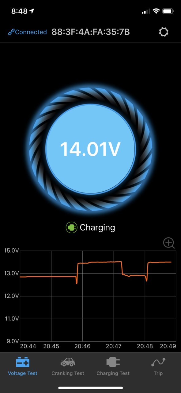

    I’m liking this data logging app. I’ve reset my booster to zero to establish a baseline and will compare my multimeter readings to the battery monitor readings for determining accuracy. But the data is pretty cool. This is a cold alternator reading, so not very useful but just wanted to share initial readings.

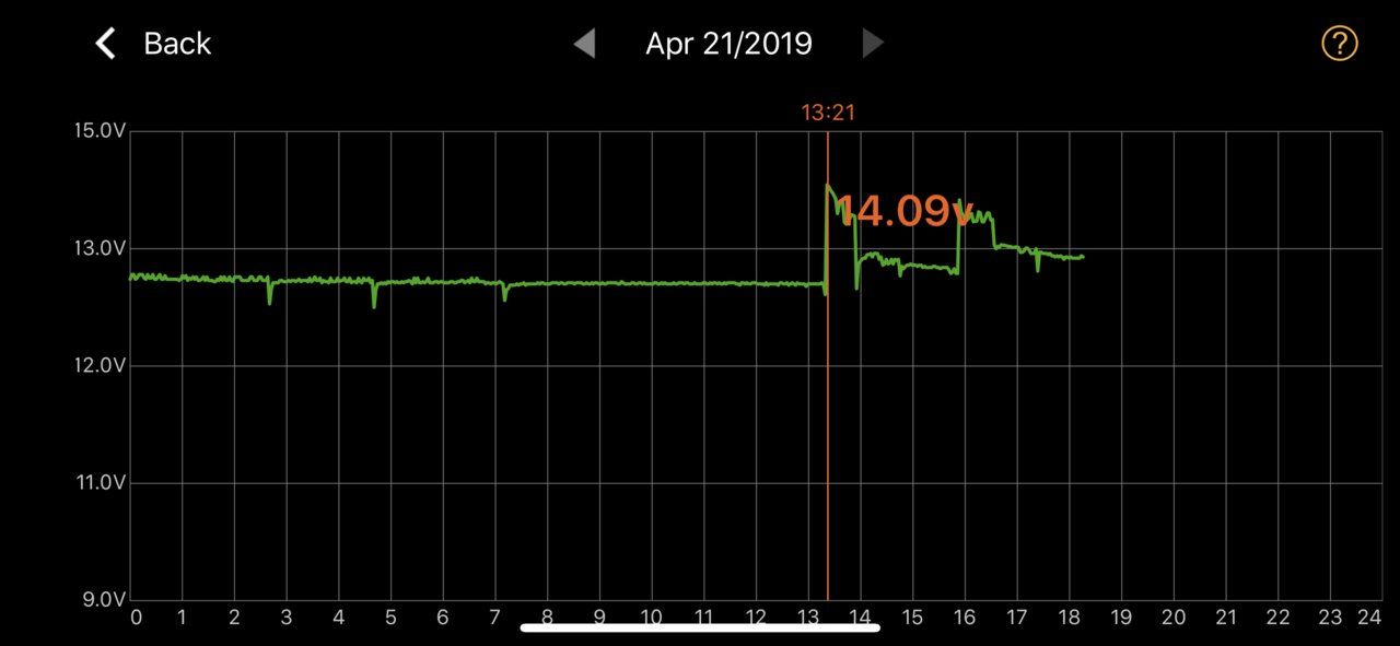

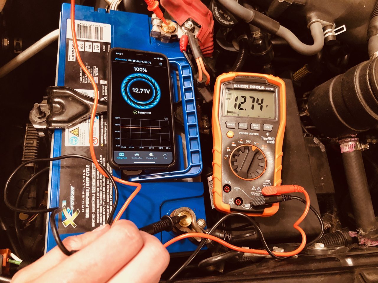

    2003 DCSB TRD OR
    I data logged a few drives today. I reset the voltage adjuster to +0.0v for a baseline. Peak voltage was measured at 14.09 with voltage steadily dropping down afterward. Average settled running value seemed to be about 13.55v.
    I checked the voltage monitor for accuracy with my multimeter, it specs to be within 0.03v.
    Confirmed it meets spec, it reads 0.03v low. In the big picture that is a very small delta but good to know.
    I reset the voltage adjuster to +0.6v for tomorrow and will check the log from my commute to dial in voltage performance.

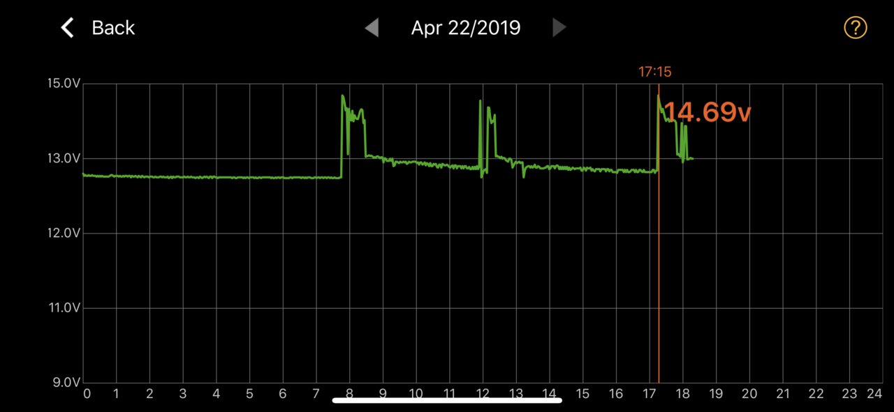

    And here is my adjusted +0.6v today.
    Both morning and evening startups peaked at 14.69v and quickly fell off, seems to average settling around 14.16v. Which is pretty on spec for +0.6v vs the baseline.
    I’m liking this method of voltage measuring far more than measuring with a multi-meter. Based on this data I can see that setting to 0.8v as the static data seemed to imply would be best, will cause a few minutes of exceeding the 14.8v max of the battery after startup.

    Kirkland, WA
    2003 DCSB TRD OR
    I sent Northstar my before and after +0.6v voltage comparison graphs (above), they confirmed the adjusted voltage looks ideal and requires no further adjustment. Based on that the 0.5v adjuster would work as well, just 0.1v less.
    I’ll update the original post with this data and point out the possible errors of just using a multimeter, which only gives you a single voltage data point in time. I’ll also add the 24F AGMs to the comparison chart as well.
