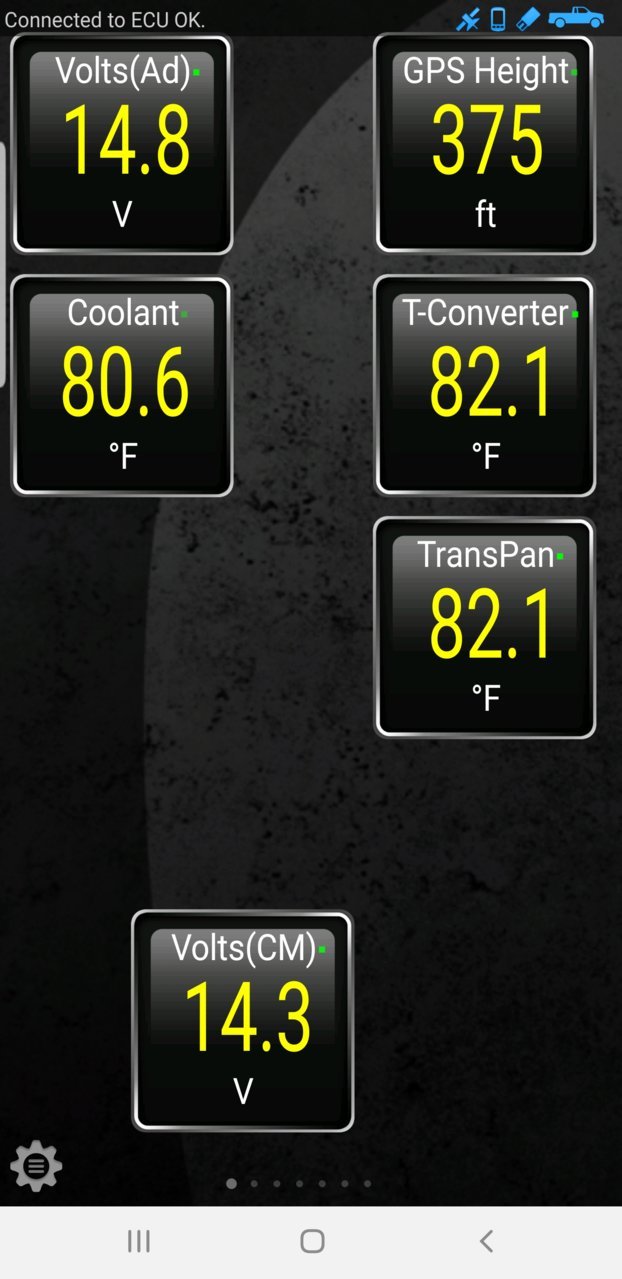

    Is it possible for the HKB fixed voltage booster to fail?
    Driving in to work this morning, my Charging System light on the dash came on. Truck was running just fine. I looked at the battery voltages - the starting battery voltage dropped to 12, while the aux battery (charged by a DC/DC CTEK - powered from the alternator) read its normal ~15 volts.
    Since the CTEK continued charging, I think the alternator is OK. The battery (even with the truck off) shows 12V, so it doesn't appear to have a short.
    Voltage regulator maybe?
    I am currently at work, and have not diagnosed this yet - just thinking about it, and looking for a good place to start.
    Both of my batteries are Odyssey. And, as mentioned, I run the HKB voltage booster to charge my AGM battery. The starting battery is 4 years old this month.
    Thanks for any and all suggestions.

    Simple to swap a spare fuse into the spot and see if the problem persists. If it does it is unrelated to the booster.

    That was one of the first things I planned to look at.
    However, when I started my truck after work, the problem was not there. No indicator light, all voltages were normal. I drove a bit last night, stopping and starting, all with no issue.
    This morning, no issue.
    I will be taking a longer drive on Friday, so I'll see if it is possibly a time/heat thing.
    I'm glad it's gone, but at the same time, wish it wasn't so I could find and fix it.
    I know - maybe it was a sun spot! LOL

    You are aware that it's effectively a circuit breaker + diode in terms of logical functionality? So, if the circuit breaker trips, killing power should reset that.
