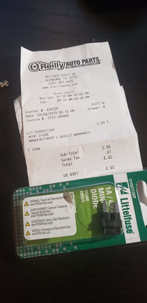

  16. May 11, 2022 at 1:03 PM

  17. May 11, 2022 at 1:05 PM
    #1037
    Ridgewalker1
    Ridgewalker1 Well-Known Member
    Sep 20, 2021
    #377594
    327
    Philip
    Longmont, CO
    2003 Tacoma TRD OR, 2015 Tacoma TRD OR
    2003 1 5/8” lift, 235-85r16 BFG KO2, ARB Bull Bar, Warn M8000, sliders, Snugtop; 2015 Hefty Fab al bumper and sliders, Warn Zeon 10k, Rago bed stiffeners,
    LOL! It says it’s a 4pack! LOL! Still it’s $9/each vs your $4.
    Norton likes this.
  18. May 11, 2022 at 1:07 PM
    #1038
    MonkeyProof
    MonkeyProof Power Top
    Oct 7, 2008
    #9774
    12,825
    SoCal- SGV
    Spares or better yet, trade em for beer
    Norton and Ridgewalker1[QUOTED] like this.
