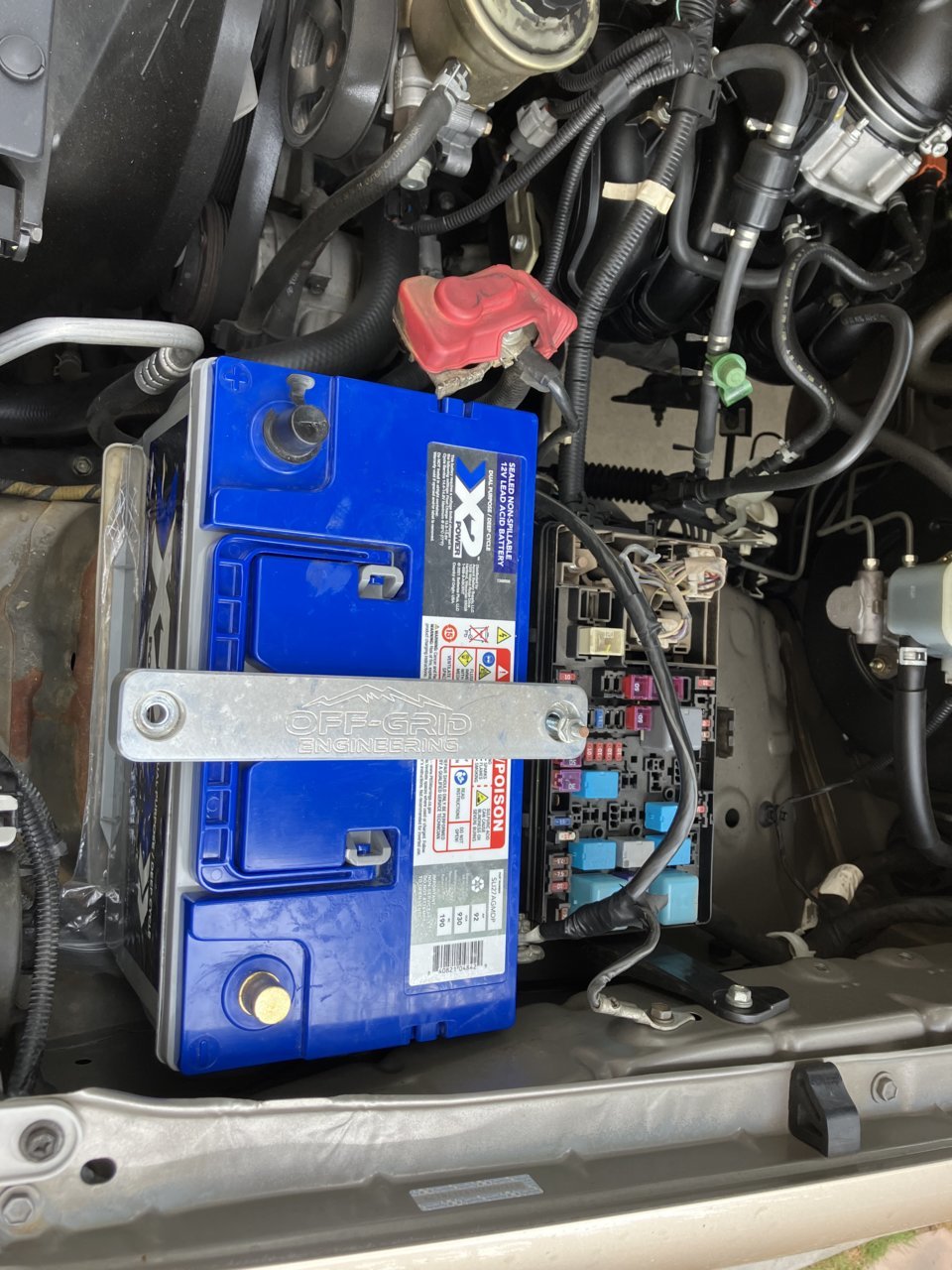

    Hah, bit by terminal location. Rats

    I hate it when this kind of oops happens! A good reminder for me to watch for when I eventually get an AGM starter battery.
    Guess it’s time to upgrade the cable?

    Looks like they pulled the wrong battery for me so I’ll go back and haggle. My paperwork says 27F and the image shows opposite terminal polarity.

    Hah, popped in my HKB and battery light on. Gotta flip it now but don’t have tools and the fuse extractor won’t pull it. Rats.

    Dykes work, but if you don't have a gay girlfriend, you can use needle nose wire pliers. :rofl:

    That was the solution and it worked perfectly.
