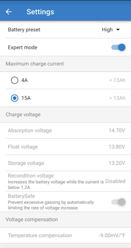

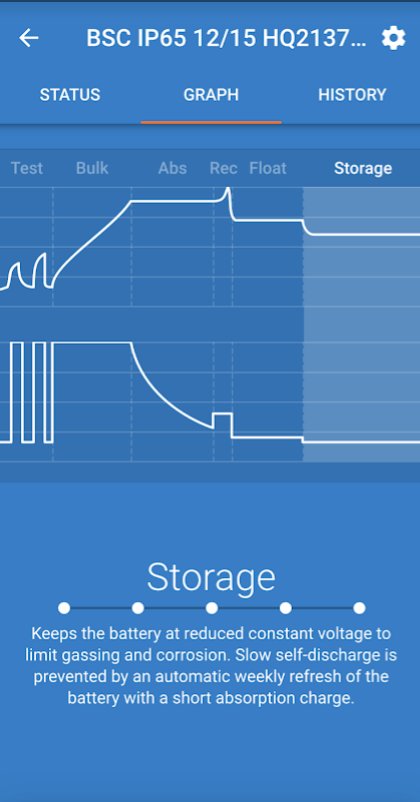

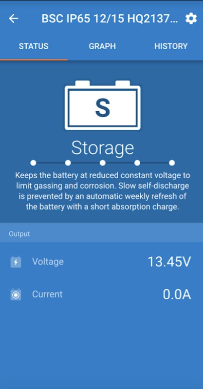

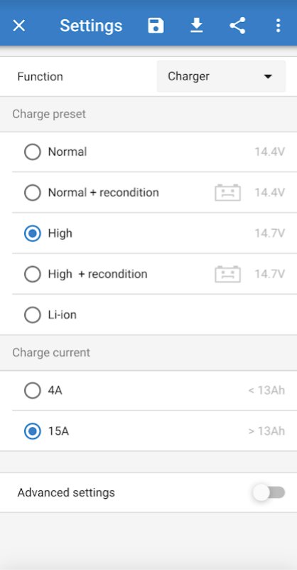

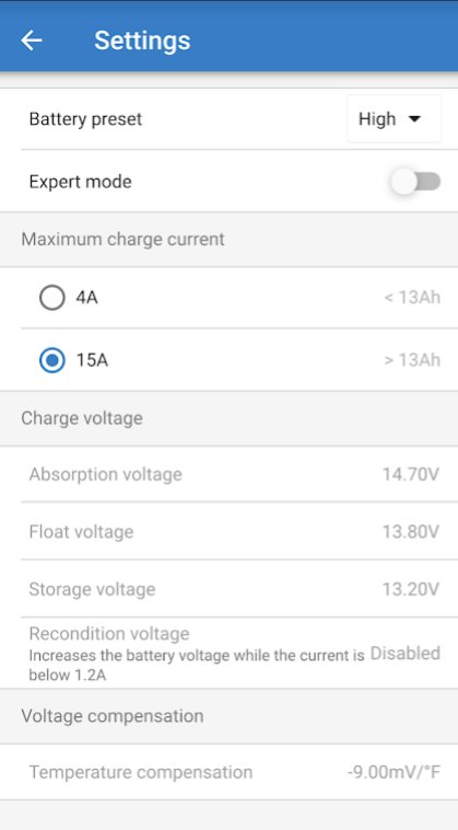

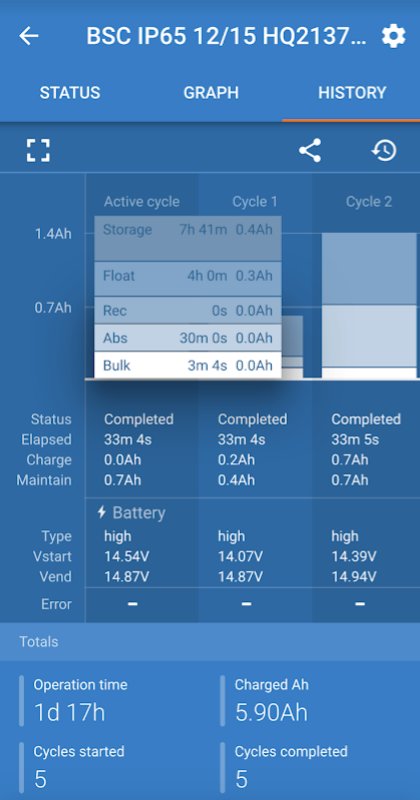

    Here are a few screenshots of the APP -
    The charger has 5 presets. The 'High' preset is what I am using for the Northstar.
    The High preset is in-line with charge criteria NorthStar outlines on the label.

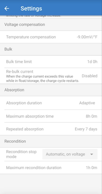

    There is also an Expert mode which can be turned on to modify the charge program and tweak the values to what you want -

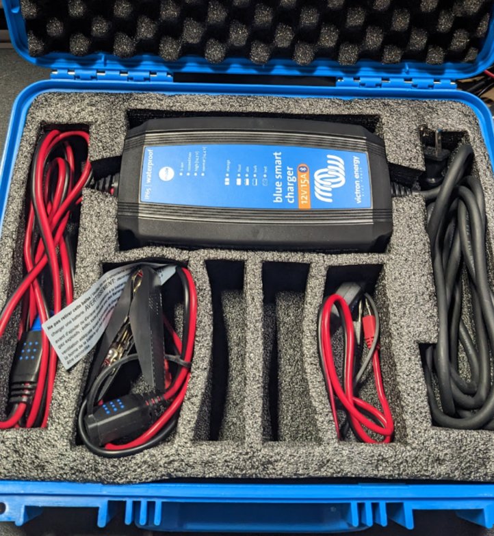

    There are different versions of the IP65.
    I opted for the 12v/15A charger.
    There is also a 12v/10A and a 12v/7A available.
    The charger includes clamps and eyelets however they are unfused. If you want fused clamps / fused eyelets, you'll need to purchase them seperately from the charger. EDIT: For the fused eyelets, there are two options. One has an indicator and the other does not.
    There is also a very nice storage case available.
    So far, very pleased with this damned expensive charger but most of us know that Victron is one of the best out there.

    That looks like a great setup! I especially like the Bluetooth connectivity and detailed level of control. If I wasn't happy with the (3) CTEKs in my garage, I'd likely go this route.

    I missed this earlier. That is a really slick charger! The price for those features doesn't seem too unreasonable, and having the specific data is always a plus. Ideally I'd like to see higher than a 15A charge rate though, but the importance of that really depends on how you plan to use the charger.

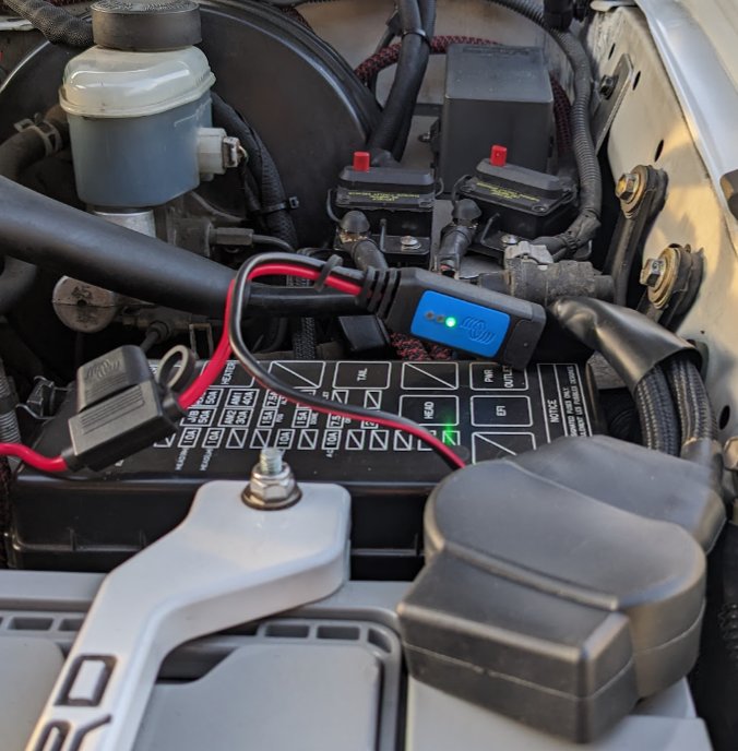

    Product page is here if you want to check out all of the details (https://www.victronenergy.com/chargers/blue-smart-ip65-charger). It really is a nice charger.
    I ordered the fused eyelets and they showed up today. Connected them and found it has a 3 LED feature built in. I can't imagine it putting any serious hit to the batt but it does blink every 4-5 secs to show batt state.

    Looks very similar to CTEK's Comfort Connect Indicator Eyelet.

    Proprietary connections make sense, from each company's marketing perspective. It would be too easy (for us) if they were interchangeable. :frusty:
