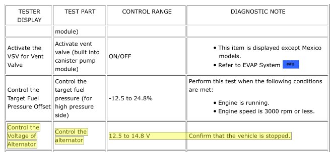

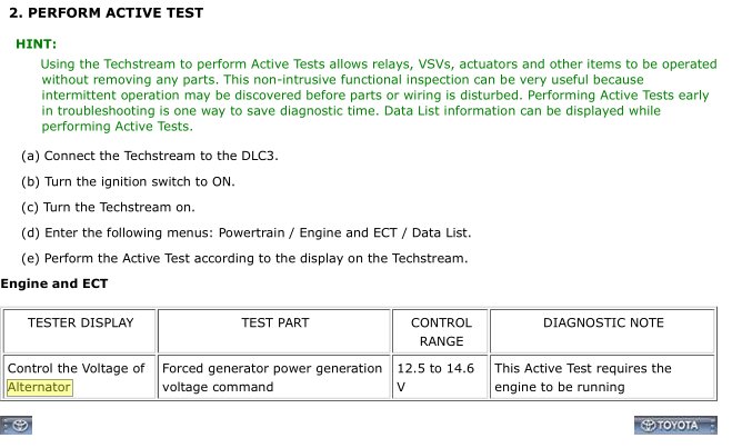

    In theory yes. I was also looking at the service manual and using Techstream, we can see the voltage from the alternator and it looks like it can be set...

    According to the service manual: Powertrain / Engine / Active Test.
    Another one on: Powertrain / Engine and ECT / Data List.

    Not sure. Need to look at spec of the battery. According to service manual, its specced to 11V to 14V.
    I would just test to see if we can even change the output voltage to max OEM spec. If we can change it, then this problem is solved and we can all use our AGMs to its optimal performance.

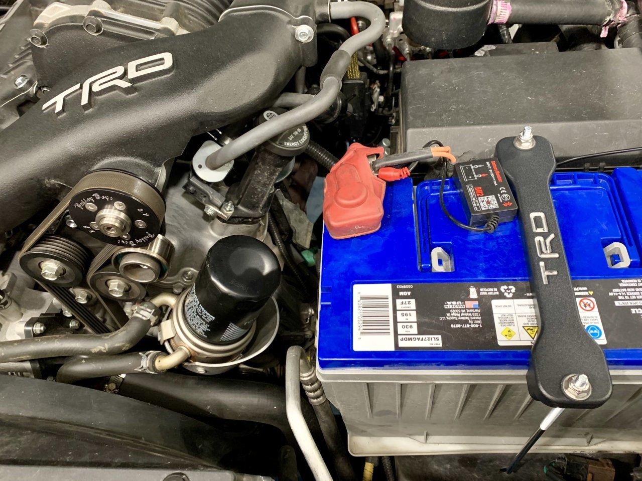

    I installed mine yesterday. (One of the easiest "mods" ever!)
    I didn't spring for the nice voltage monitor but, using my UltraGauge and digital multi-meter, I saw voltages no higher than 14.6 on cold start. Haven't gotten it up to temp yet, but will know more about that this week.

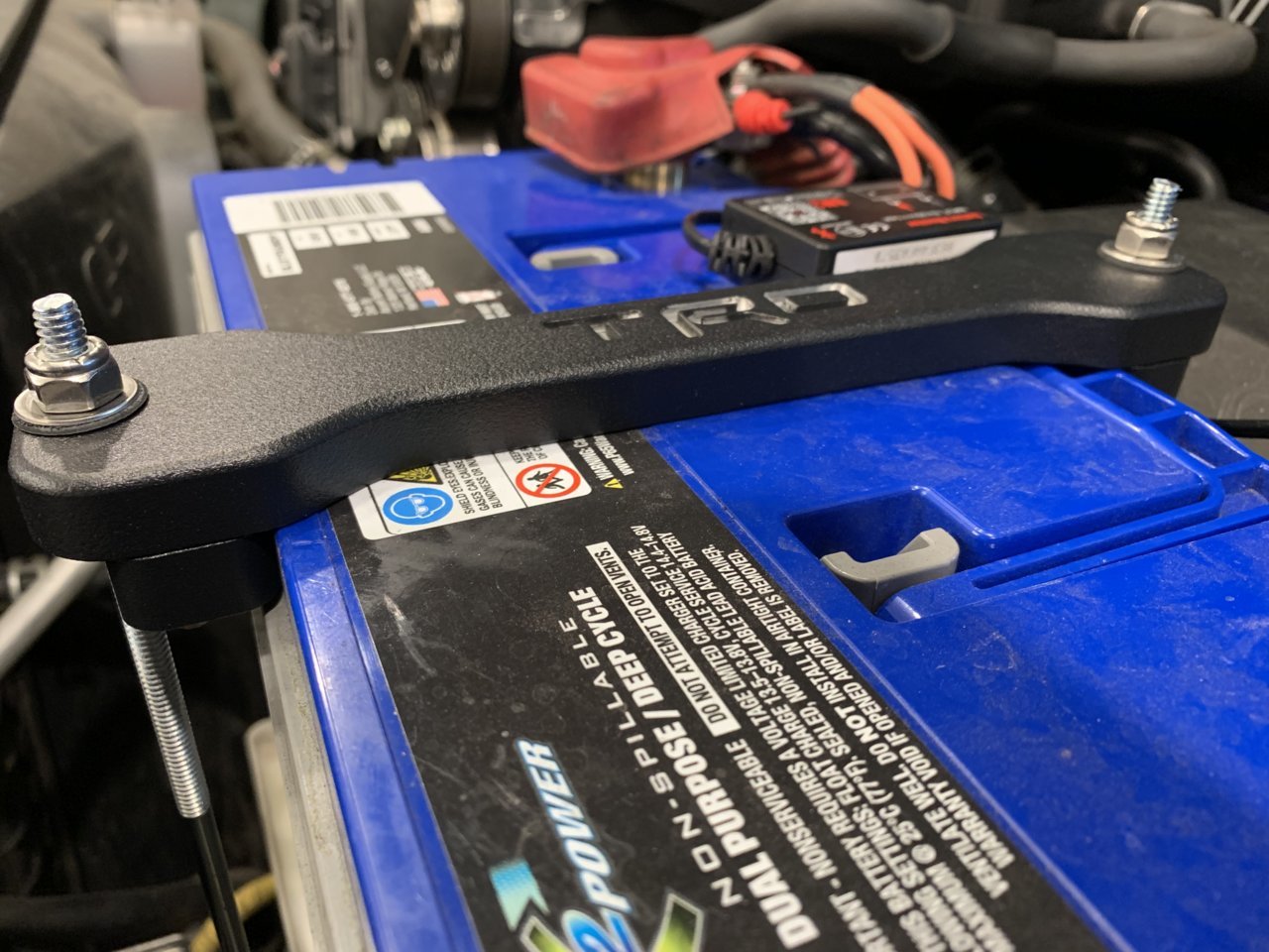

    I originally purchased the Rouge battery tie down for my NorthStar. Not a good fit for this 27F battery. The tie down lip way overhung the edge of the battery.
    I then purchased the adjustable one being sold on the forum. Since the clamps are adjustable, it fits the 27F battery perfectly.
    A nice plus is that it matches the TRD blower.
