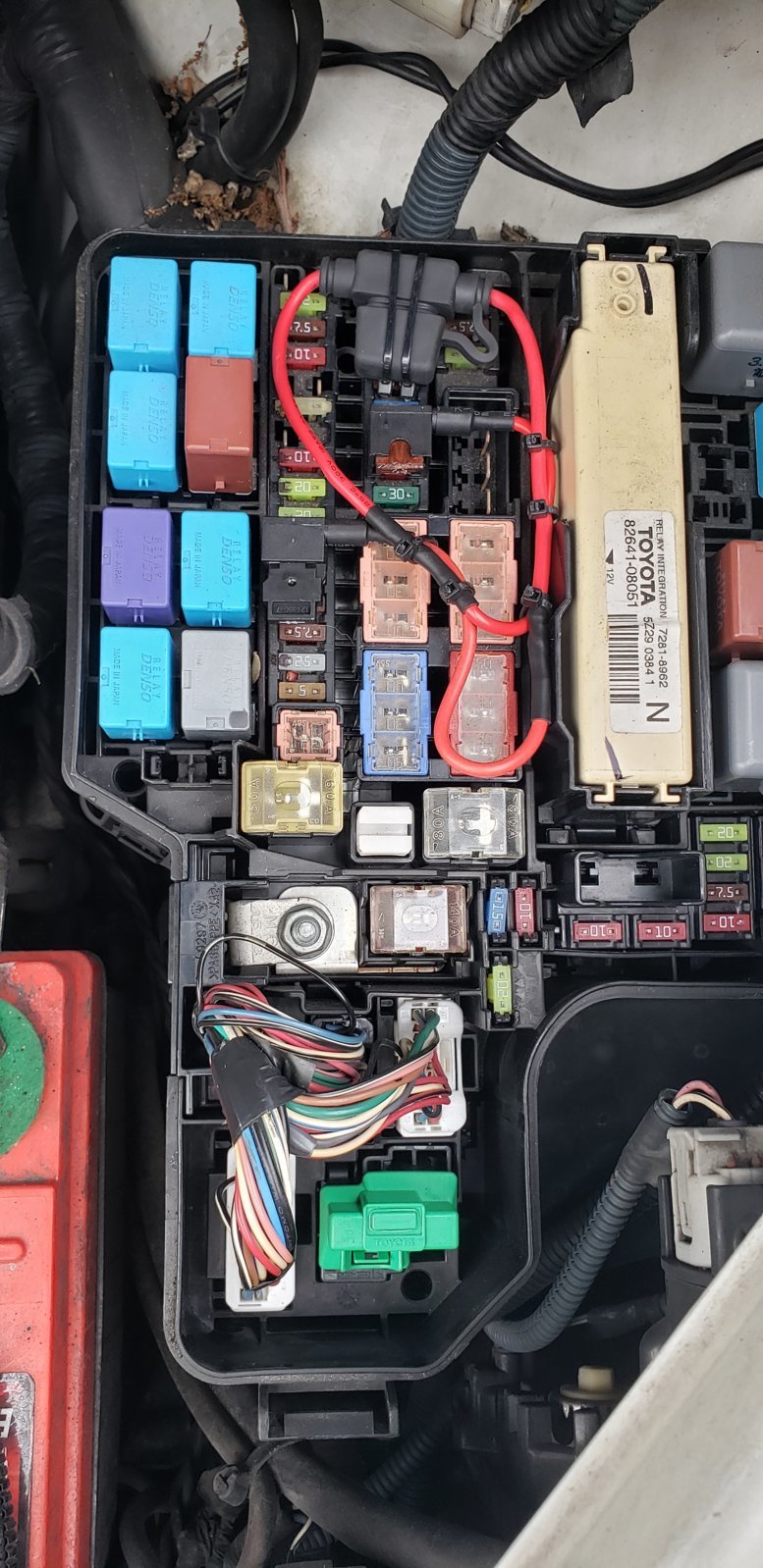

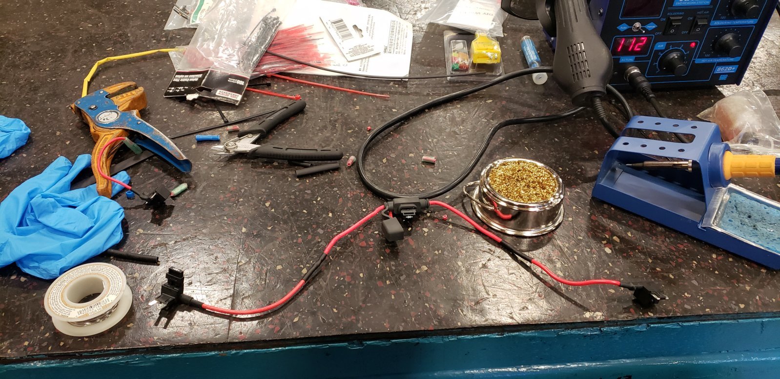

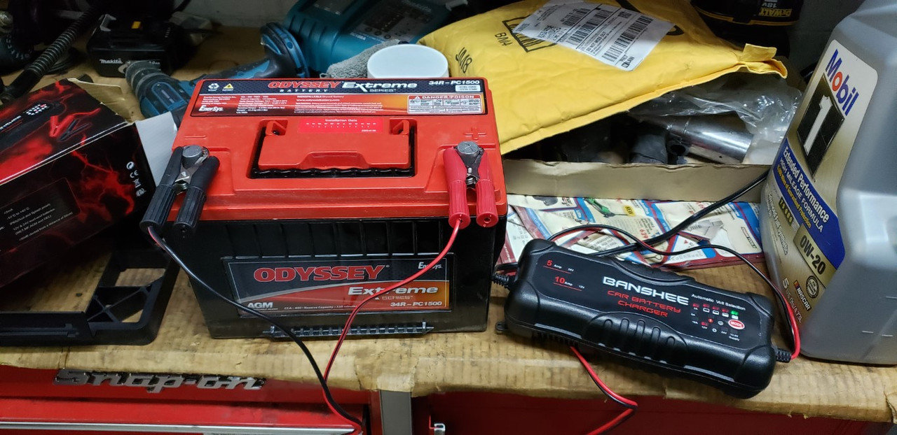

    This is what I've done with my 2016 Sienna Limited
    Odyssey Extreme 34R
    200psi OBA
    Train Horns
    Sub Amp
    Multi-camera surveillance system running 24/7
    Initial voltage readings at idle:
    Stock: 13.3-13.5v
    1 diode: 13.9-14.1v
    2 diodes: 14.5-14.7v

    Check your overnight cold start voltage readings just after start up. If you are at 14.5-14.7v at idle, I suspect you'll far overshoot the max spec charge voltage under heavy cold start charge which will damage your AGM.

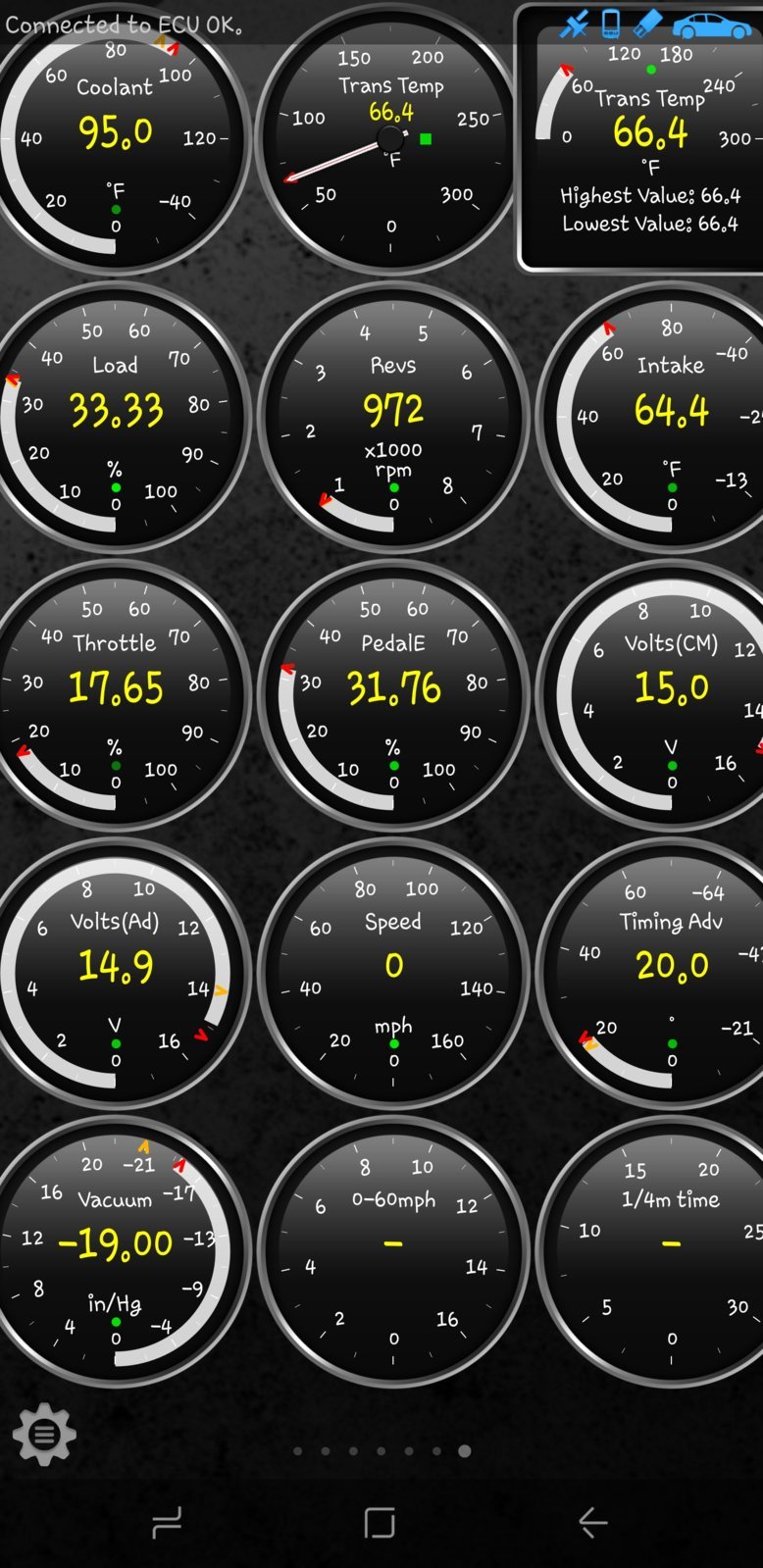

    Cold start voltage is usually 12.3-12.4v (this is after a full night of multiple cameras running non stop)
    Initial start will generally peak at around ~15v, then taper off to about ~14.5-14.7v after she warms up.
    My contact at Odyssey says it's about as good as it gets for this battery.

    Doesn't sound great. Per Northstar technicians, startup voltage should never exceed 14.8v. If you are hitting 15v now, it is only going to get higher as it gets colder. Looks like you will be easily over charging the battery, leading to certain early failure. It sounds like Odyssey's technical support is unfortunately inferior to NorthStar whom they acquired. "Over charging is as good as it gets" should be a non-starter. Sound like talking to someone in sales vs engineering. I'd strongly advise against charging counter to the engineering specs printed directly on the battery.

    According to Enersys, 15v is the limit (which is why he said it's as good as it gets).
    If it starts going over, I'll just pull one of the diodes
    But you're right, I should go by the specs printed on the battery itself rather than their general literature

    Be sure to have a way to monitor or track the voltage other than manually using a multimeter. With being that close to the limit it will likely go higher in the winter, or remain at 15v for longer. I liked the voltage logging apps for history, but a simple in cab voltmeter works too.
