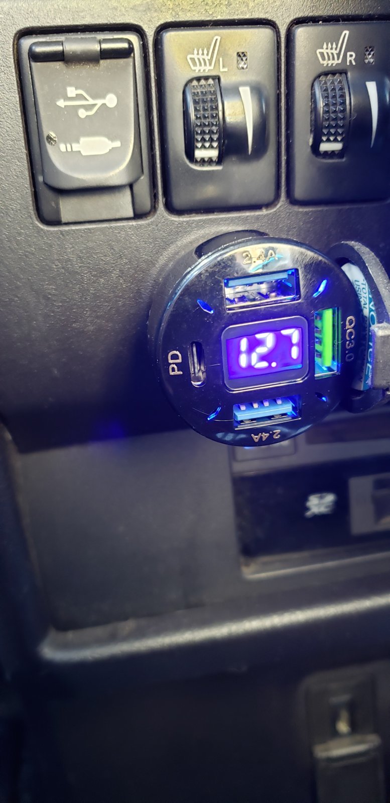

    Yeah I have a few apps as well as this little charger doohickey to keep an eye on it.
    This morning the battery voltage was a little lower than usual at 12.1v as it was a bit colder (low 50's) and I had several power hatch and sliding door openings/closing while loading up.
    Upon start up it went to 14.9-15v and settled down to 14.7-14.8v after about 10 minutes of driving.
    After about an hour it will hover around 14.4-14-5v
    Surpisingly the voltage remains quite stable regardless of rpm's.
    Pretty much stays the same at idle as well as normal driving.
    Even when I crank up all accessories (front/rear AC, OBA compressor, fan cooled LED's, etc.), the change in voltage is minimal.
    I do notice a bit of a drop down into the high 13's when parking (EPS), but that's normal

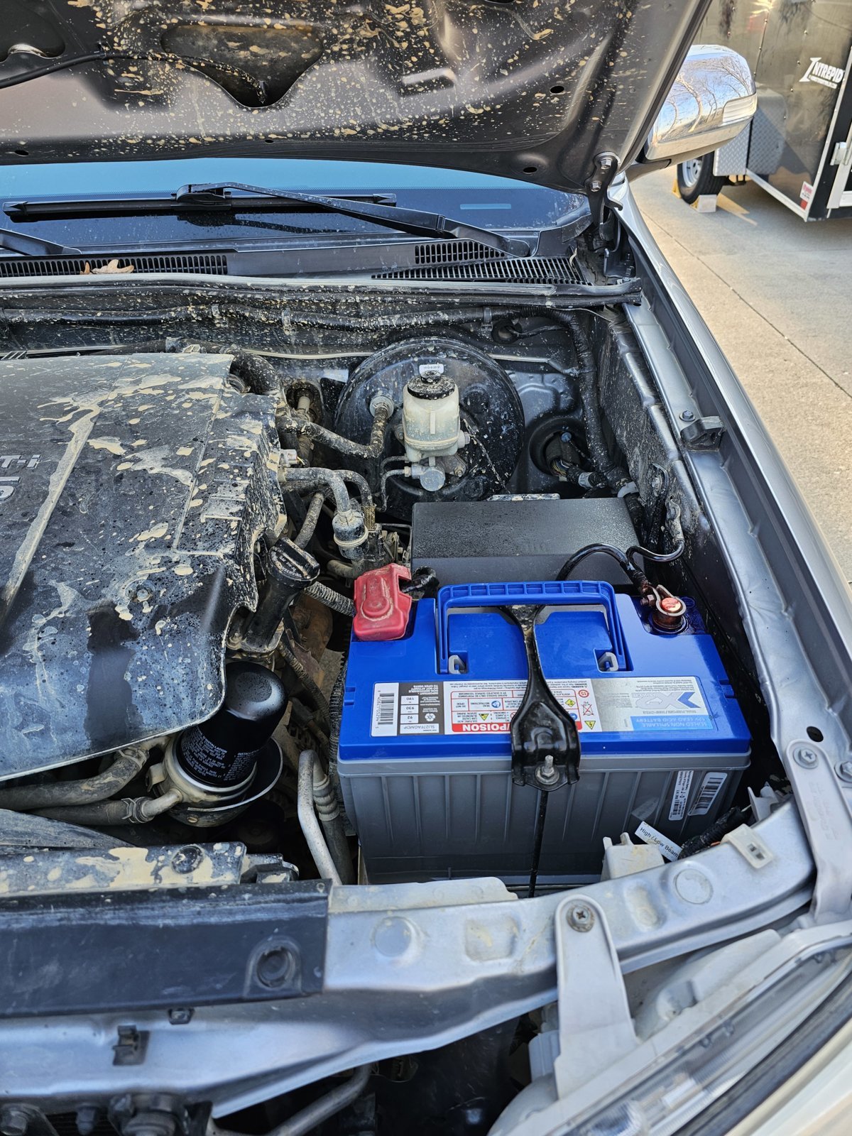

    Did the install on my X2Power 27F today. I absolutely love it so far. I may have to do as crashnburn80 stated with a custom battery tie down. Wanted to make sure my voltage booster was working good before I dropped in my new agm. I go camping twice a year at a site with no running water and no power. So, this will be a nice addition for when I go.

    I've been running my 27F in the stock location, but I'm flatbedding my truck and want to move it to a rear frame rail for better weight distribution and less weight on the front sheet metal, which is already prone to cracking.
    Does anyone have a battery box that will fit these batteries?

  20. Feb 6, 2024 at 2:35 AM
    #1260
    daveeasa
    daveeasa FBC Harness Solutions
    May 14, 2020
    #328079
    7,479
    David
    PNW
    2016 Tacoma OR DCSB 6MT, 2005 RC 5MT PreRunner, 2002 Tundra SR5 RCLB 4x4
    If moving to a frame rail, group 31 would be my choice. Then keep a 24F or swap to a 35 in the stock spot for starter only. Lots of good options for group 31, I had a Rago but never used it, never got around to finding a home for it as intended.
