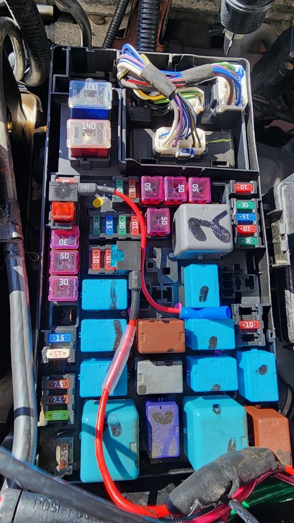

    Can anybody confirm with me that I did this accurately? I used a little fuse diode with an add a fuse and a 7.5 fuse with it?
    It appears I went up about a .5 voltage with this set up.
    My main question is to does this offer me the proper fuse protection doing it this way?

    No protection. But it does work that way and I ran mine for months before stuffing in the HKB.
    The fuse only protects the added circuit, they are parallel. What we would want is series wiring which could be done (think of 3 AAA batteries with one oriented opposite to the other 2) but I don’t know of any plug and play options.
    two of these in series could work with minimal modification to tie one leg of each together.

    It depends on the orientation of the add-a-fuse holder. It’s designed for the fuses to be in parallel with the wire on the output side(opposite the hot rail) but reversed they end up in series. This is because the two fuse slots are only connected at the end of the holder normally plugged into the hot rail.

    Not true for the OEM circuit, only true for the added circuit. The OEM circuit has no way / no path to route through the upper fuse slot without modifying or using a fuse extender and hacking.
    I'm sure you realize this and you were thinking of the added circuit, note that for alternator we're not concerned with anything other than the lower slot.

    The discussion was about using a gm diode to boost voltage. Which is what this thread is about. And then, specifically while using an add a fuse, is there was a viable means to protect and boost. Unfortunately, there isn’t an easy way as there is no option for series wiring with the OEM circuit regardless of orientation.

    Remove the tab of the add-a-fuse that normally plugs into the hot rail and replace it with a fuse tap connected to the wire from the output side of the add-a-fuse. Install the remaining tab of the add-a-fuse into the hot rail and the fuse tap/wire into the output side and install your diode and fuse which are now in series and provide both boost and protection. Current will flow from the hot rail to the remaining tab, through that fuse slot to the other end which is already tied to the other slot, back through that slot to the wire and on into the fuse tap to the protected side of the circuit. Done. Yeah, I’ve read the thread.
