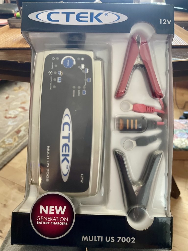

    Anybody recommend a charger. My Northstar’s gonna be sitting for a month or two & with Black Friday coming up.

    CTEK Smartcharger

    To further clarify, I've had four CTEK chargers for years...
    - CTEK MULTI US 7002 normally charges the AGM in my Tacoma
    - CTEK MXS 5.0 (Ford Performance Smart Battery Charger And Maintainer 5.0) normally charges the standard wet cell lead-acid in my Shelby
    - CTEK MXS 5.0 normally charges the standard wet cell lead-acid in my wife's BMW
    - CTEK MULTI US 3300 (Corvette Model 1051) normally charges the standard wet cell lead-acid in my Corvette
    My son lives in an apartment with a detached garage, so he uses a CTEK MUS 4.3 POLAR for his Tacoma and motorcycle.

    Just got ‘er. Thanks @Norton :hattip:

    You're welcome! I hope you're as happy with yours as I am with mine.
