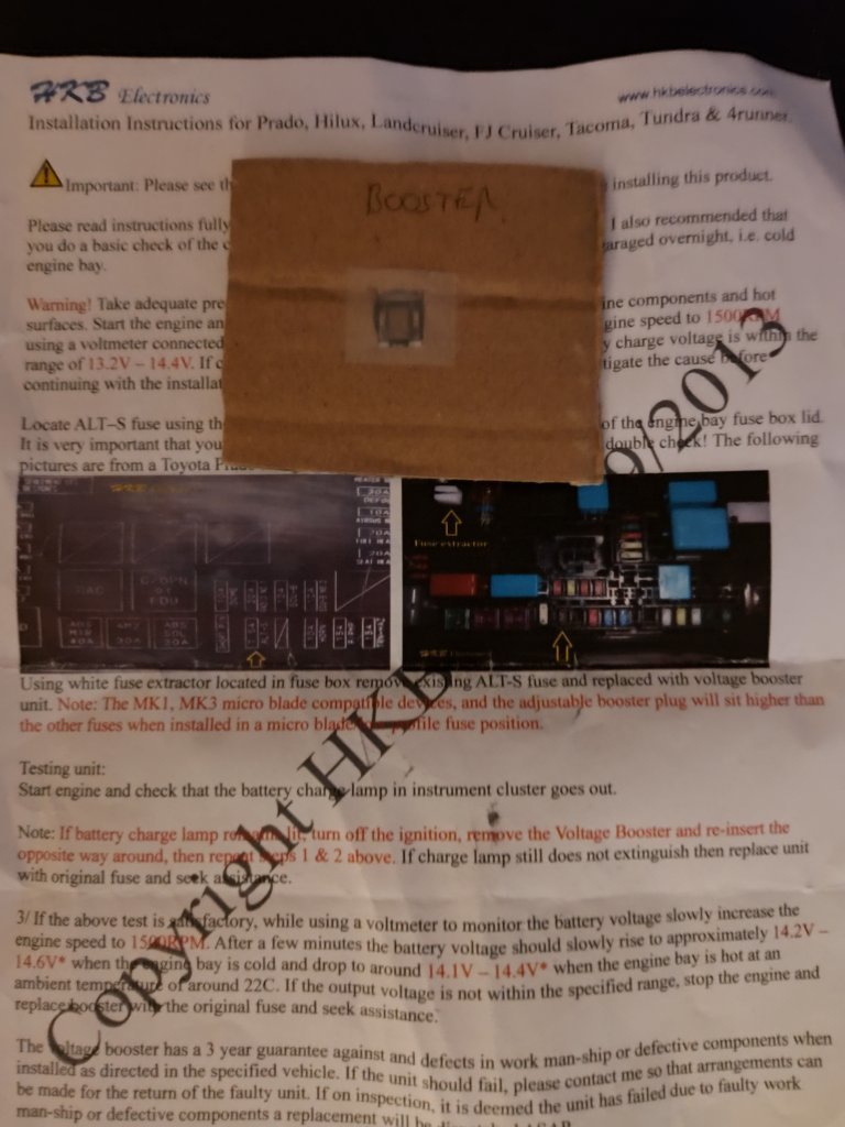

    Got this in the mail yesterday
    Now to wait until it warms up and snow melts in the next day or two to install and see the difference.
    I've been starting with 14.3 and would drop to 14.0 or 13.9 by the time I drove 17.5 miles to work and 30 minutes of driving.
    At last check they are sold out again.

    Installed and working. Tomorrow is the first test run to work.
