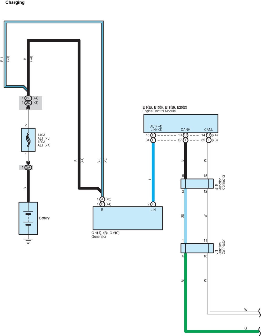

    Anyone had a chance to check techstream to see if 2017+ alternator output can be changed?

    Tried looking today, couldn't find anything. Only thing I could find, like the other member, was to test a specific alternator output voltage, but once you exit it defaults back to other setting.
    Under the function tab along the top of the screen, there's a vehicle configuration option, but asks for your vehicle configuration code.....I don't know where to find that, so couldn't explore further.
    There's gotta be a way to change the setting somewhere!

    If you can identify the wire coming from the alternator to feed the ECU the voltage, it should be possible to install a fuse inline, then add the booster like earlier trucks. Certainly not as cool as a Techstream solution though.

    Would this wire be considered the "sensing" wire? I would think the "sensing" wire would be between the ECM and battery. I see this wire as ECM input into the Alt, must be another wire between ECU and battery. If not, interesting 3rd Gen don't utilize a fuse on the sensing wire.
