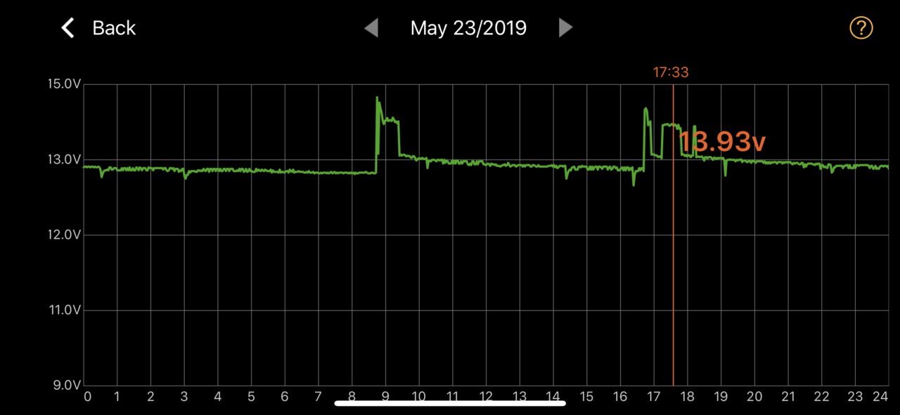

    Voltage fluctuates quite a bit, here you can see I am in the high 13s warm with a 0.6v booster. I’m regularly around 14.7 after overnight cold start.

    I'm really digging these historic graphs

    I like factual data. There is a link in the OP with a tool to make your own, something like $30.
