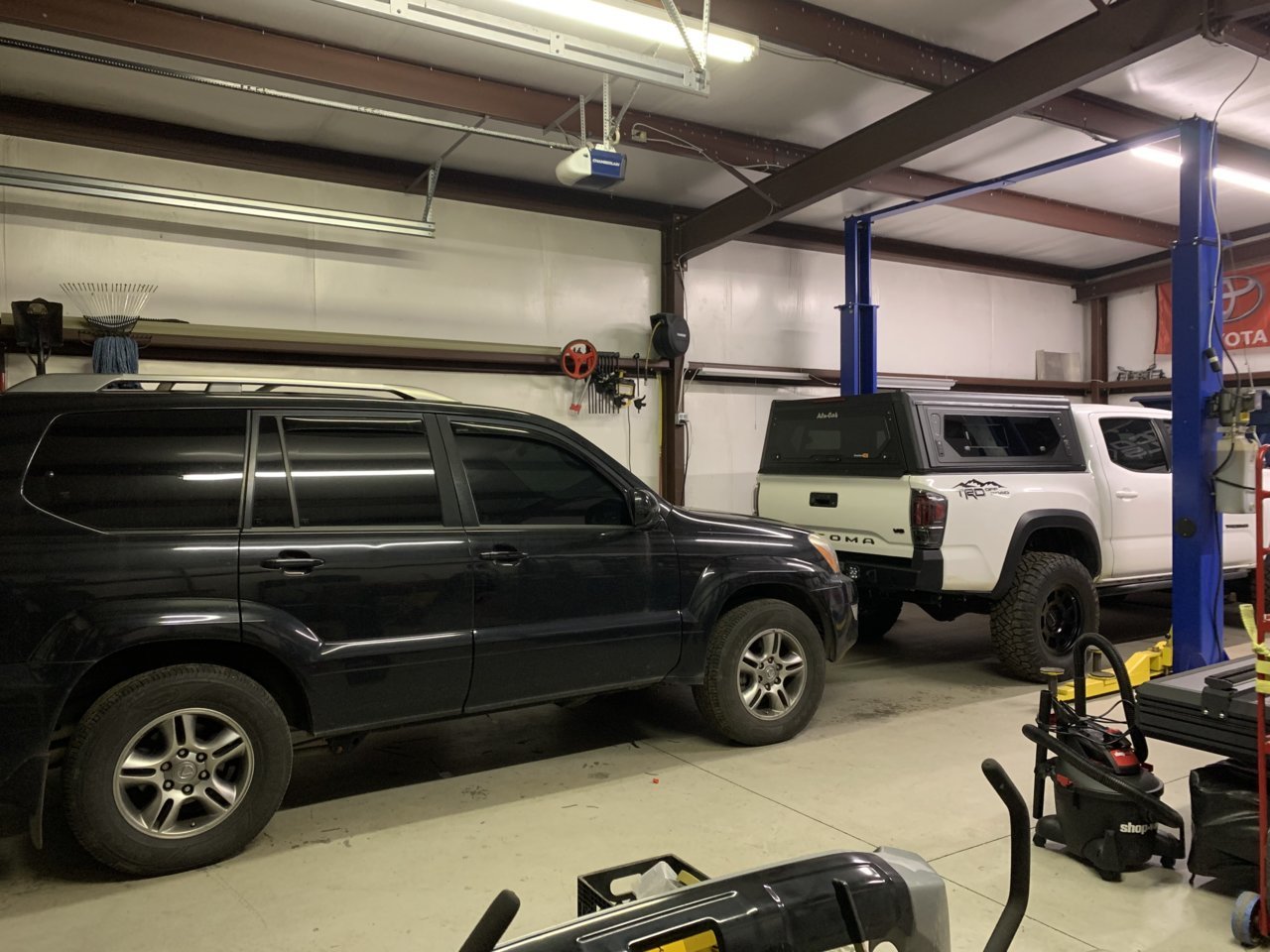

    It’s currently parked in the garage. It’s one small step at a time. It’ll take me another 3 months to put it on jack stands. Check back around September

    Shit...at least yours was parked in your own garage...I end up using the neighbors or in-laws (plus the two point lifts make it so much easier).
    I mean it took me about nearly 6 months to just pull the coilovers and add some preload, so I understand and support Matt's current rate of mod!

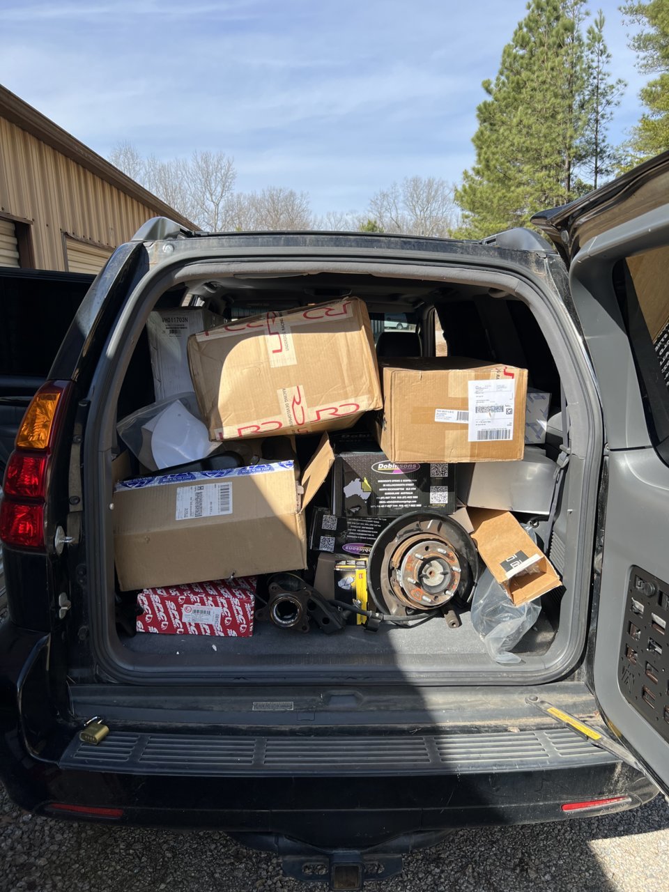

    This is the last photo of my GX being stock
    Big things are happening.

  12. Feb 9, 2023 at 3:08 AM

    All OP shows us is pictures of a stock GX.

    '04 T4R SR5 4x4
    How many truck loads did it take to deliver all of the parts?

  16. Feb 9, 2023 at 8:07 AM
    #256
    SearArtist
    SearArtist [OP] GX poor
    Jan 5, 2016
    #174151
    18,980
    NC
    GX470 & GX460
    Things
    This was the first delivery. My 6x12 trailer will be used next and will likely be full too.
