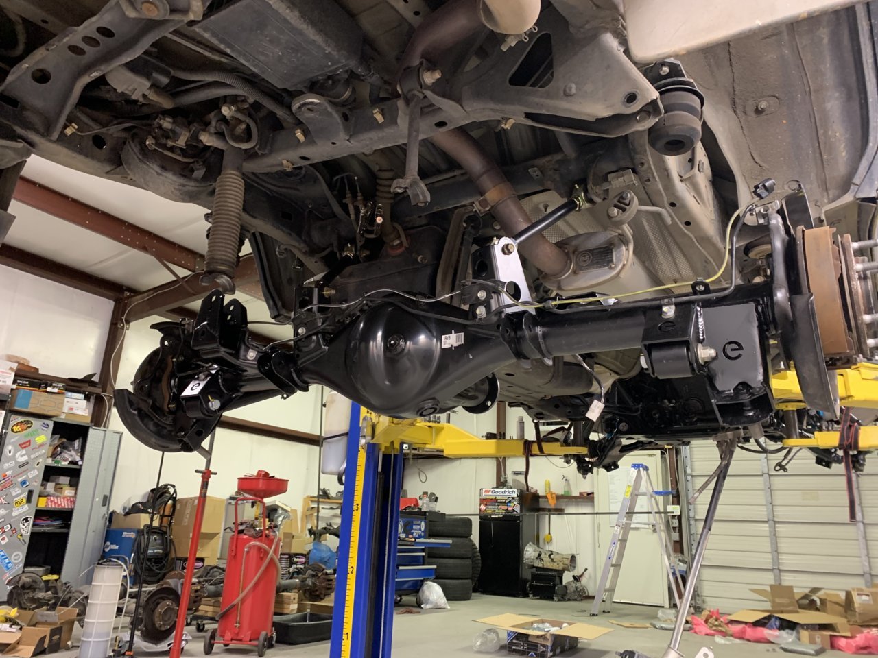

    Minor setback with the tundra rack. It sits too far back towards the firewall with the essentric bushings. Gonna have to weld in new barrels and get it pushed forward.
    this will let the 934’s clear as well as center the tie rods better.

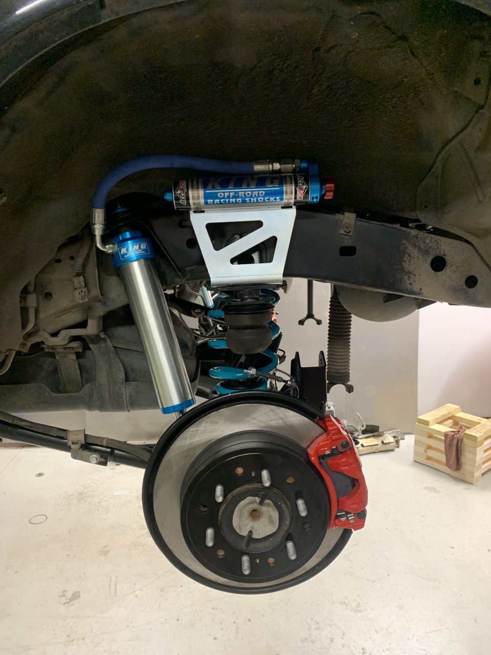

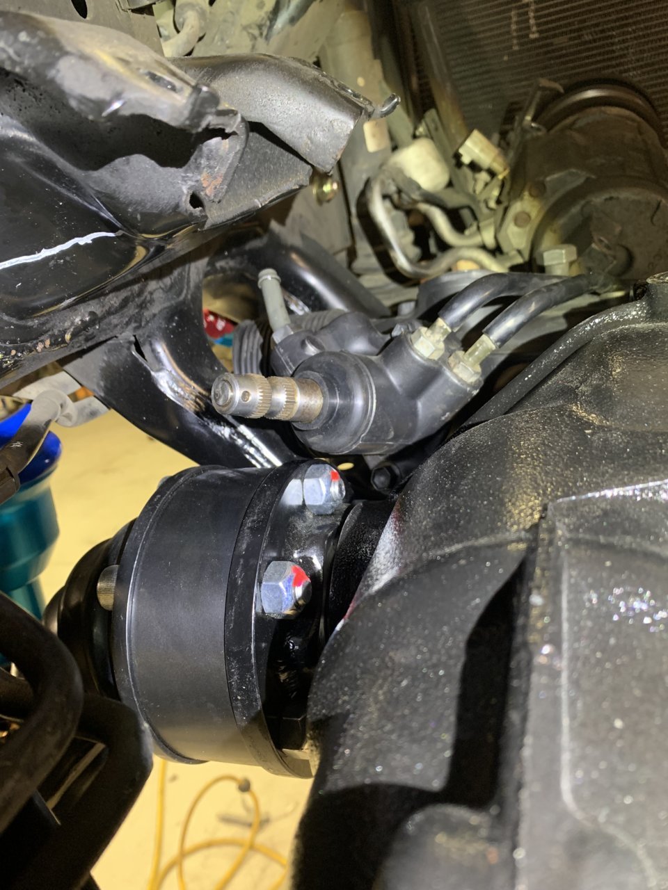

  20. Apr 27, 2023 at 3:30 PM
    #320
    SearArtist
    SearArtist [OP] GX poor
    Jan 5, 2016
    #174151
    18,980
    NC
    GX470 & GX460
    Things
    @Basikbiker Tundra rack had to ultimately be relocated and new barrels welded in. Having the engine out made this a lot less difficult than it would have been otherwise.
    My installer continues to kill it
    Jusssst enough clearance to feel comfortable.
