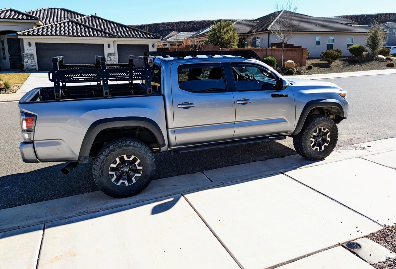

    Prinsu Roof Rack
    UpTOP TRUSS Bed Rack

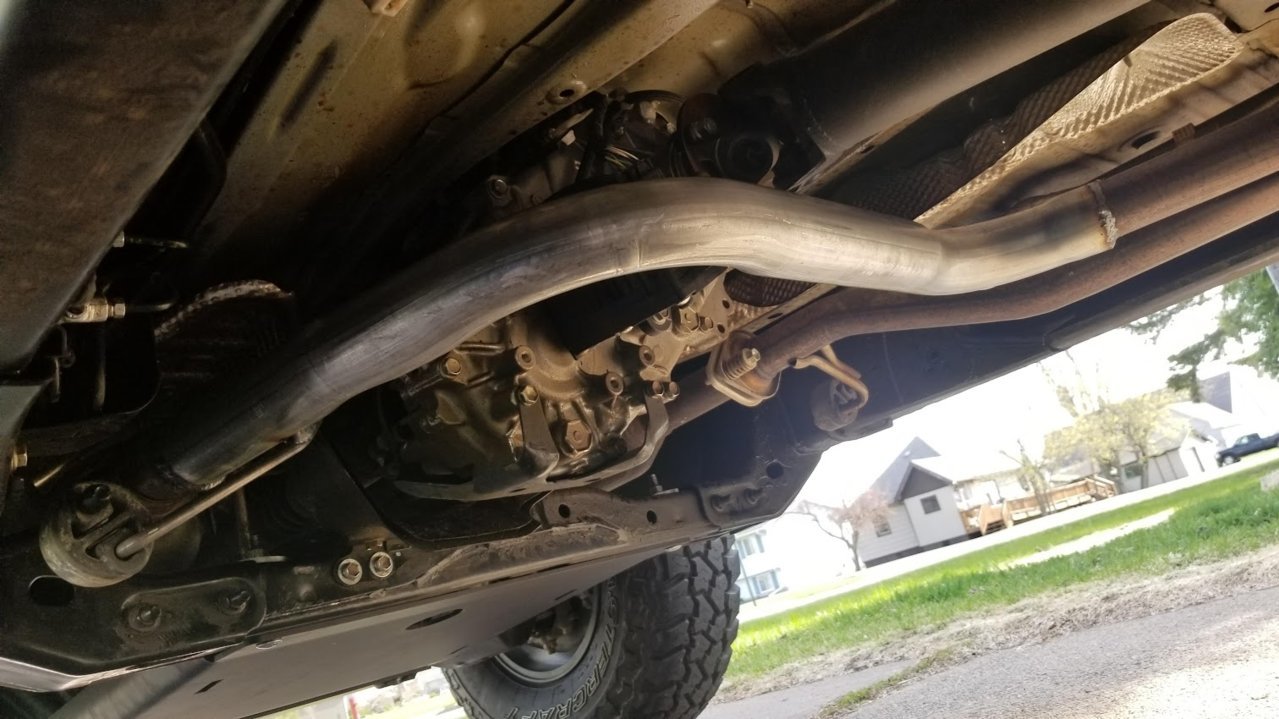

    Catalytic converter delete (removed 1 from both sides), and custom designed 3.5” single pipe catback exhaust with flowmaster 40 series muffler

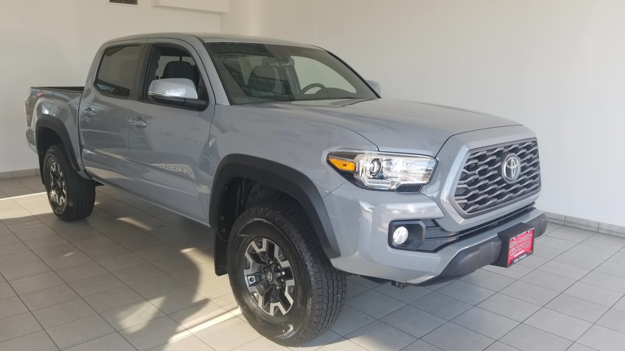

    1. What year and model is your rig? Why did you select that model?
    2020 TRD Offroad, DCSB, 6MT, basic package.

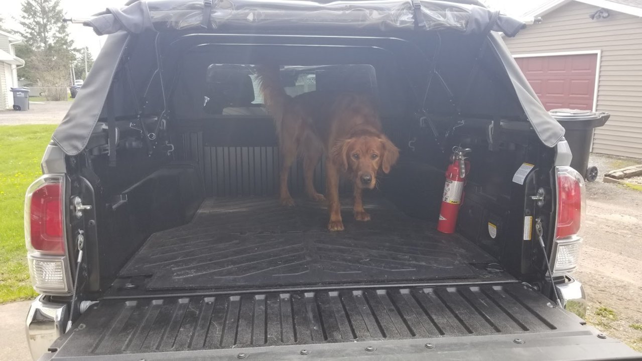

    I had an old 1999 SR5 before buying my current truck, and was always super jealous whenever I'd see a TRD Offroad driving around town. I liked the black fender flares, I liked the bedside stickers, and I liked the idea of a rear locking diff. That all translated to me choosing the Offroad for my 2020. I spent a lot of time going back and forth between wanting a manual transmission, a 6 foot bed, and a double cab. Ideally, I would have liked a DCLB in a 6MT, but it doesn't exist. My next choice was an ACLB in a 6MT, but only those lucky Canucks up north get that configuration on the offroad, where we get the Sports in the US. The last thing I was going to compromise on was the 6MT, so I ended up with a DCSB.
    No regrets whatsoever, the back seat has been invaluable (for hauling my dog, and for throwing stuff back there that won't fit in the bed). I've found that the back seat also doesn't turn into a bottomless pit of random things like the back seat did on my access cab SR5, maybe because there's always a chance I'll have a passenger back there now. The 5' bed has fit everything I've needed it to, and if it ever doesn't, I'll buy a small trailer.

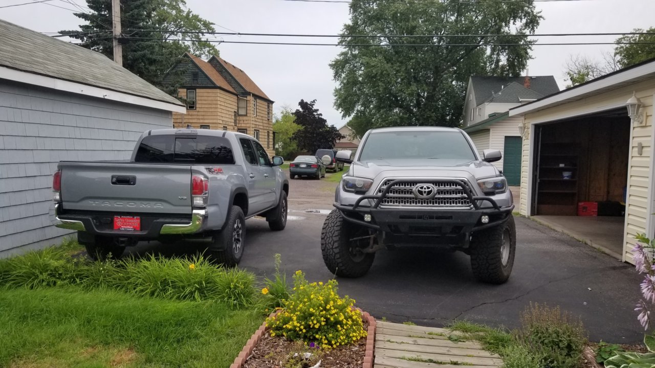

    4. What suspension, tires, and armor (if any of these) have you upgraded (or not) to? What drove you to select these?
    Suspension is pretty much stock, although I removed my sway bar, am on my 2nd set of OEM leaf springs, and 3rd set of rear shocks. Definitely next on my to-do list is to get a new leaf pack, another set of (better) rear shocks, and 2.5 coilovers with an aftermarket UCA for the front. Hoping to lift ~1.5"-2".

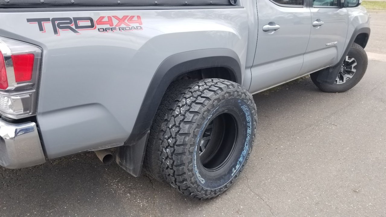

    Tires are Mastercraft Courser CXT's in 255/85R16 (33"x10"). I really like the practicality of pizza cutters, and these were the best way to "lift" my truck before Moab, since tires are the only thing that lifts the diffs higher. I wanted some Cooper ST Maxx's in the same size for their supposed prowess in the snow, but they weren't available anywhere when I needed them. The Mastercrafts have been awesome, but I'll be looking to get some dedicated snow tires (Wisconsin) for the winter sometime in the future.

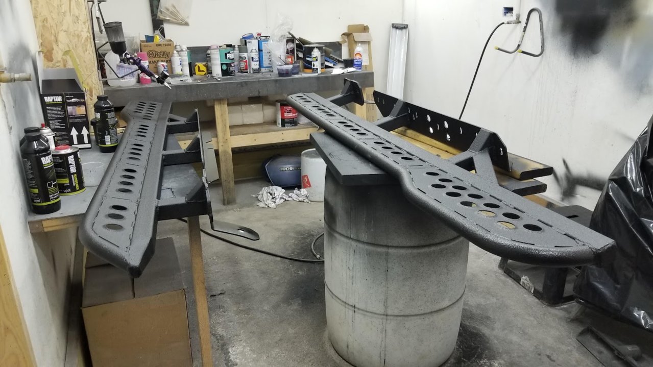

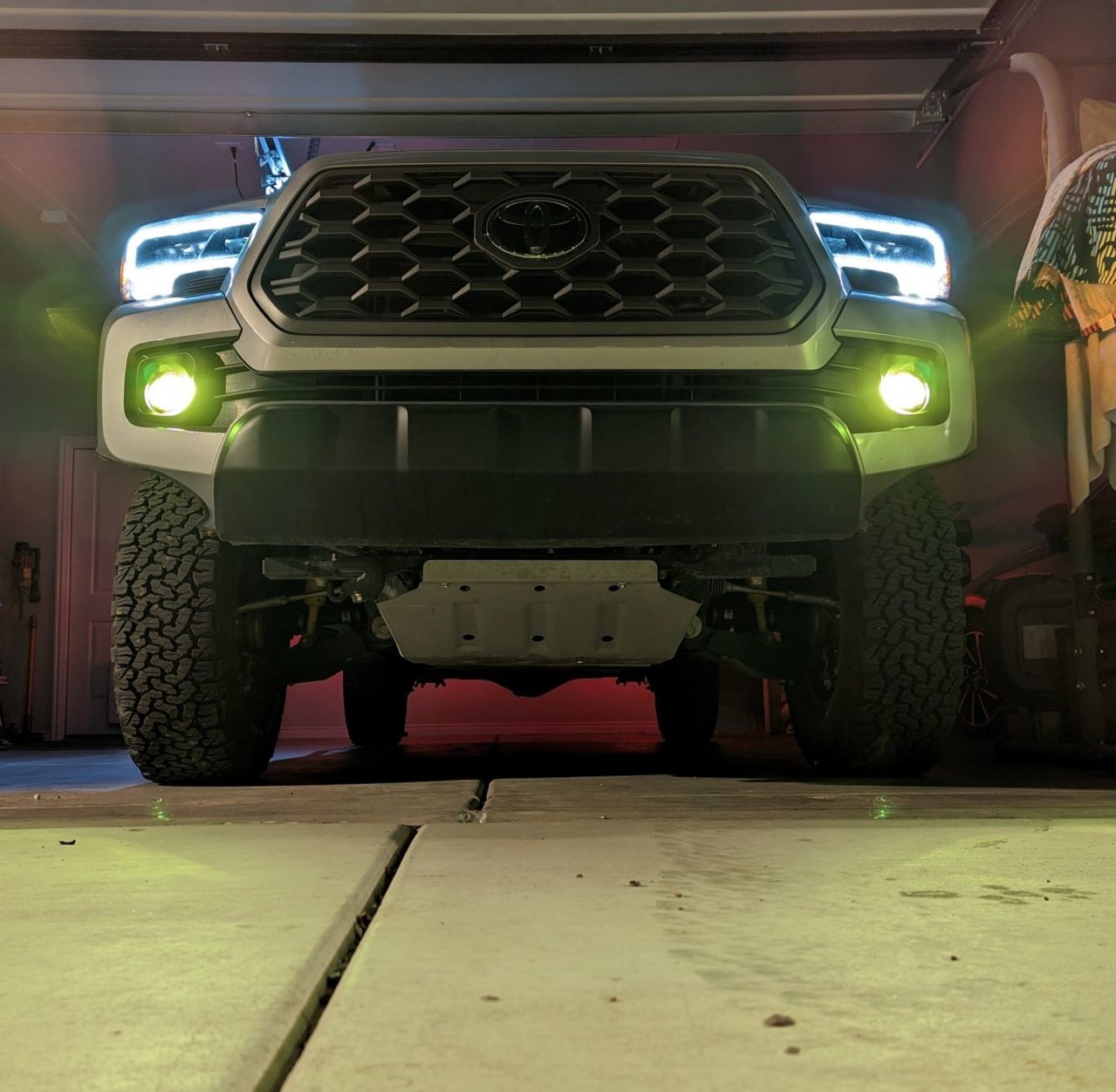

    Armor, I went with the engine/tranny/tcase steel skids from RCI, and I love them. They've saved me numerous times in our two trips to Moab, I would recommend anyone looking into wheeling, especially on rocky stuff, to invest in these (or similar). I went with the flat tcase skid, so my exhaust had to be rerouted at the crossover, local shop took care of it for $100. My buddy is a welder by trade, so he was able to make me a set of sliders for my truck. I had them sandblasted, then coated them with a two part epoxy primer, and finished them in Raptor liner (truck bed lining). They've held up great for ~2 years. These have also proved invaluable the handful of times I came down on them on rocks. Invest in armor!

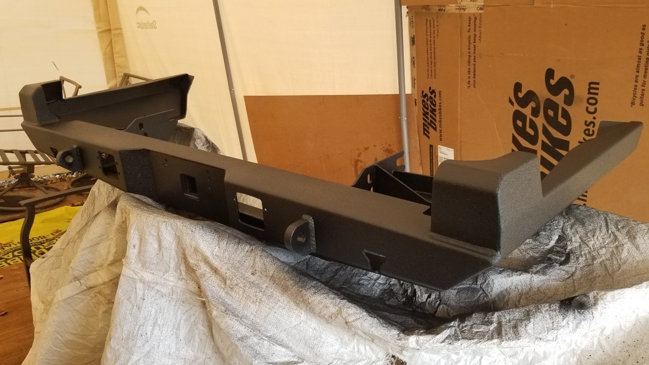

    High clearance rear bumper by ATH Fab, bought it a few months ago and got it coated (same as my sliders), but winter hit before I could get it on, so it'll go on this spring. I've smashed two rear bumper corner caps and would rather not continue doing that.

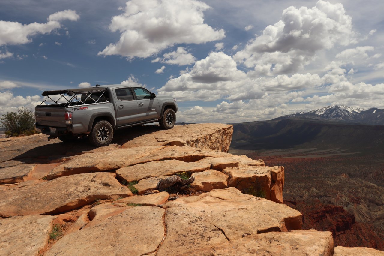

    Top of the World in Moab is the coolest place I've been in my truck, and everything behind that was also in Moab.

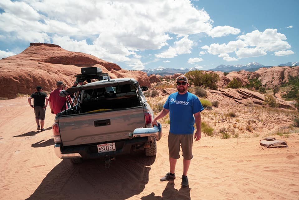

    I mentioned earlier that once I smashed my first rear bumper cap, it felt like the 1000 lb gorilla was finally lifted off of my back. It made me wheel harder, and I enjoyed every second of it so much more without the anxiety of hurting my truck.

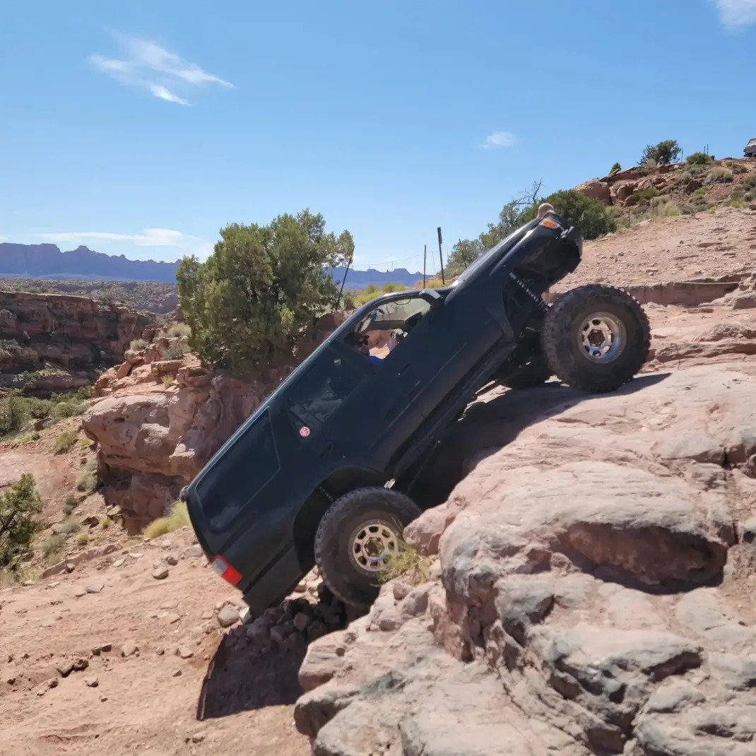

    Biggest pucker moment was riding in my buddies linked and solid axle swapped 4runner on 39's, we almost ended up on the roof (or so it felt like). It was a blast.

    2007 Tacoma reg cab 4x4 on 37's; 2021 TRD Offroad, 6 speed
    37's,lockers, bumpers, bobbed etc.
    I've got two, a 2021 Off-road manual, and a 2007 regular cab(the wheeler)
    2. What was your intended off-road use? (overlanding, wheeling, both?)
    Strictly offroading and back roads cruising. I have no kids, so the regular cab offers the best offroad package for me.
    3. What was your first modification to it, to make it more off-road capable? And, in hindsight, knowing what you know now, would you have reprioritized anything or done anything different?
    The 2007 was already heavily modified, but my first mods were a snorkel and front bumper. If I was starting stock...it would be good tires and body armor. Specifically bumpers and rock sliders.
    I've got Fox coilovers, all pro leaf springs with 12" travel shocks, and bumps tops. Bumpers front/rear, and rock sliders. Also, an aftermarket front skid( definitely needed). Currently running 37x12.50xr17 BFG KM3.
    5. What other modifications have you made to the truck, specifically, for off-road and/or emergency capability?
    It also has a arm skids, snorkel, bobbed bed, etc.
    6. What recovery gear (if any) do you carry with you, and what conditions are they intended for (daily driving, off-road, or both)?
    I carry tools(metric sockets, prybar, knipex pliers, side cuts, etc) and a hi-lift jack. Straps, shackles, and associated gear is key. Being able to winch yourself out when alone is a big key.
    7. What other gear do you carry with you always vs. when off roading? Or do you always have your truck kitted out and ready to go, why?
    Toilet paper...never know when you have to go. I also carry food such as beef jerky and nuts. Lots of water(or trail sodas if the situation warrants). I keep my truck always ready, because I am usually in rural areas where help is far away.
    8. What are your plans for your rig going forward?
    Plans are possibly a SAS. Otherwise, I'm happy with it as is.
    9. List a few of the coolest places you’ve been in your truck, that are unique to you and/or your home/grid?
    I've been to the local offroad parks(interlake, redbird). Previous owner had truck all over the west, including Moab.
    10. Lastly, pucker factor moment in your truck while off-roading – what happened? Then tell us about the coolest or most serene moment (for you) while off-roading, or just something memorable in a positive way
    Wildest one is a toss up. Laid the truck over in a washout...locked the front locker in and drove it out on its side. Other time, I nosed down a steep embankment, and stood the truck on its nose. Rode on the nose all the way down the hill.
    WarBeard_Actual[OP] likes this.
