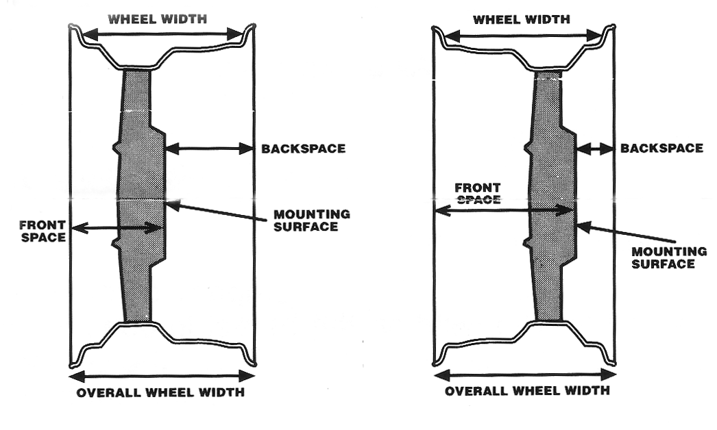

    Alright, Ive noticed this question keeps popping up. Its actually the 1st thing I asked when I joined this site. Can you run other Toyota Wheels on a 1st gen? Well, the short answer is YES! Some exclusions apply though.
    Backspacing. What is it?
    Backspacing is the distance between the part of the wheel that contacts the hub and the outer edge of the wheel. choosingdiagram.gif

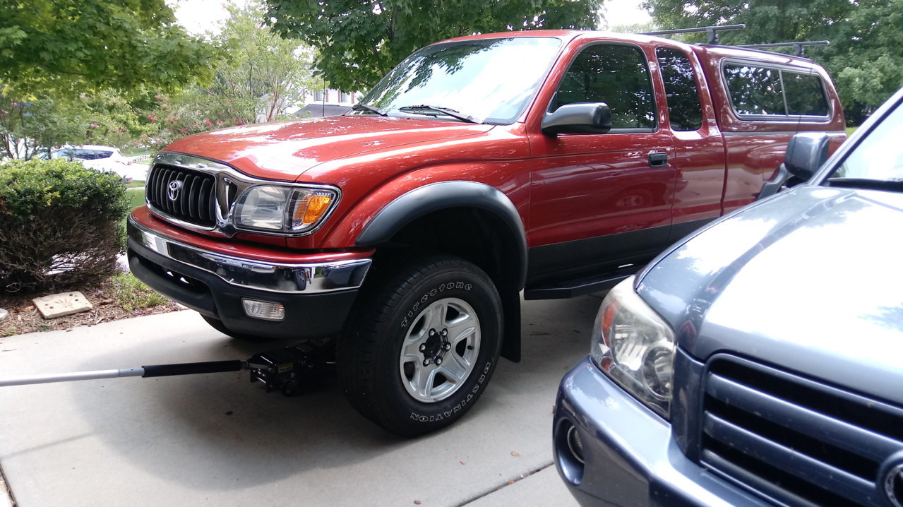

    2nd Gen Tacoma TRD off road wheels. These have 5.25" of backspacing.

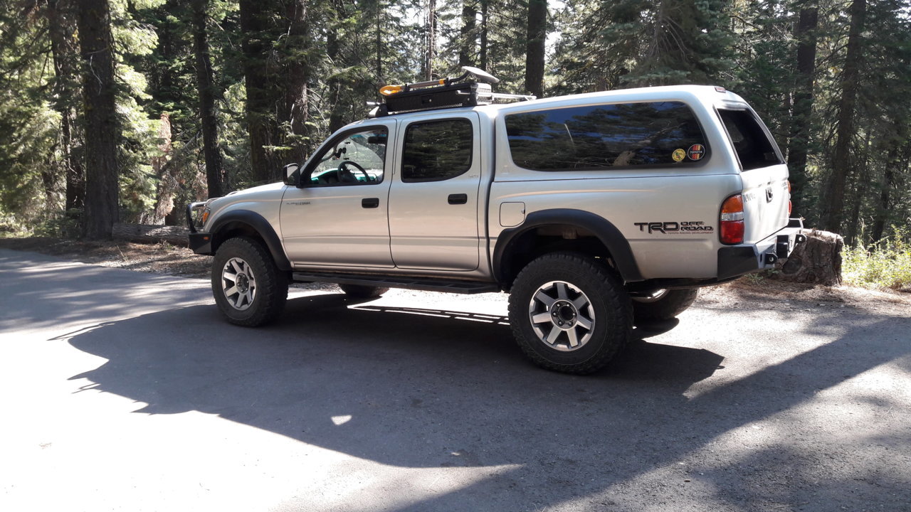

    3rd Gen Tacoma SR5 wheels, a favorite of mine. I believe they have about 5.15" of backspacing.

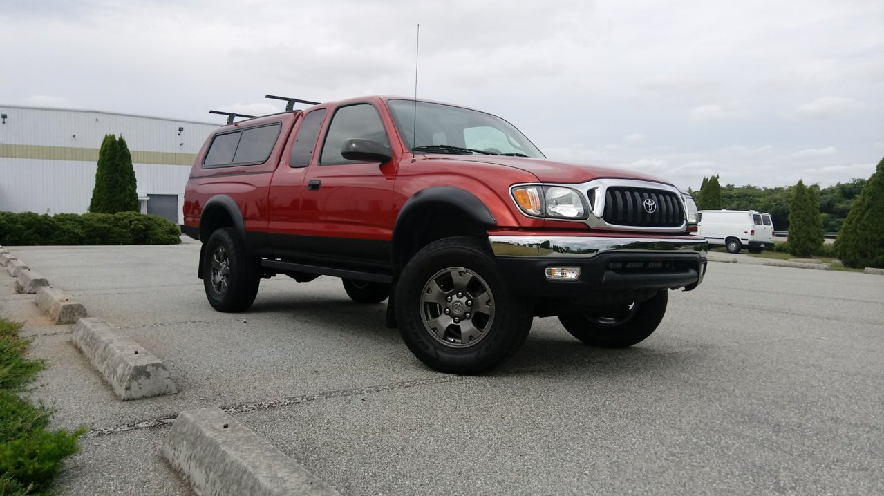

    I've seen Gen 1 on Gen 3 wheels. Looked great

    The Gen 1 looks great with the Gen 3 rims. It's a match.
