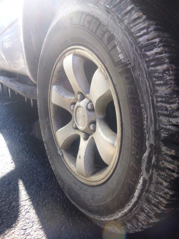

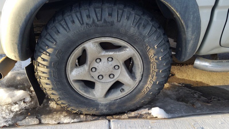

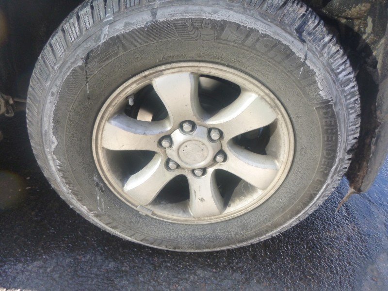

    Can I run stock 17" 4th Gen 4runner wheels with 265/65R17 tires on my 2004 Taco DC which currently has 16" wheels with 265/75R16 Duratracs... soon to be replaced. I am not really interested in going to larger tires (heresy, I know), but it occurred to me if we ever had to get-out-of-Dodge... everyone running the same wheel / tires size might be an advantage. Below are some photos of the tires/wheels on my Taco, and some of 17" wheel on a 4th gen 4runner Sport. So, in my case, I am interested in not only different wheels (e.g. 4th gen T4R), but also different wheel size -- going from 16" wheel to 17" wheel (but keeping outside tire diameter pretty much the same).
    Are there any issues running a 17" wheel on an axle (?) that currently has 16" wheels mounted? I'm guessing that since 17" > 16", there should be no issues fitting around brakes etc... but I figure I'd better ask.
    I think some folks in my area are selling on CL the same 17" alloy wheels that are on my wife's 4runner.
    As I understand it... her 17" allow wheels will fit, but with 5.25" of "backspacing", a stock tire (e.g. 265/65R17) will sit closerto the UCA of the front suspension. As long as I don't go up in tire size, I should be good to go? (I found my wife's 17" wheel in the parts section @ Olathe Toyota website, but it said this wheel is not compatible with my 2004 Taco. Hence all my questions. Also, it made note of 30mm offset, whereas the 5 spoke alloy wheels on my 2004 Taco the website made no mention of any offset?)
    Picture showing LT265/75R16 Duratrac on stock 16" allow wheel on my 2004 Taco DC:
    Stock 17" alloy wheels on my wife's 4th gen 4runner:

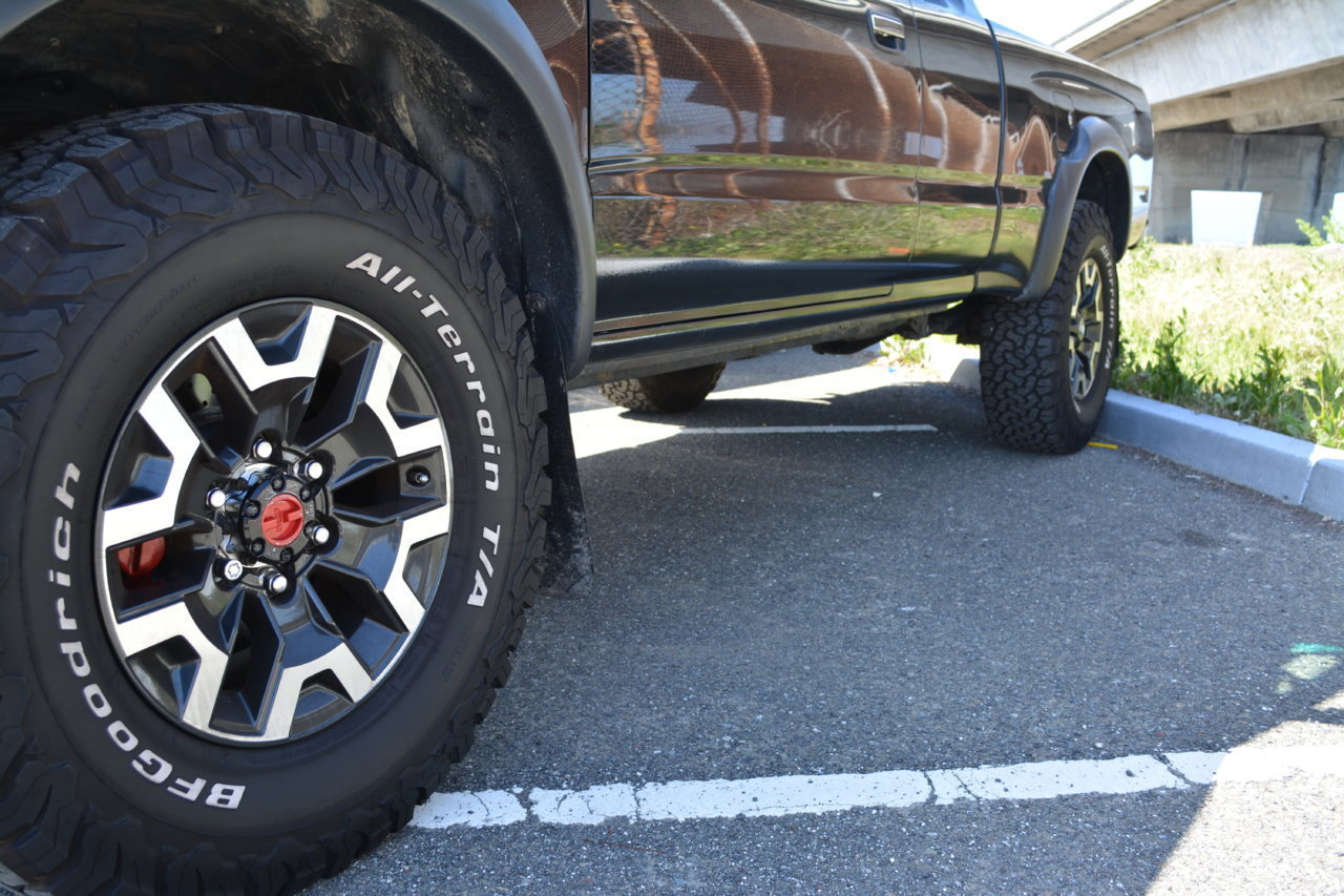

    Yes, you can. Exactly what I did and I have no rubbing anywhere. These are 17's from the 19 4runner. IMG_1664.jpgIMG_1665.jpg
