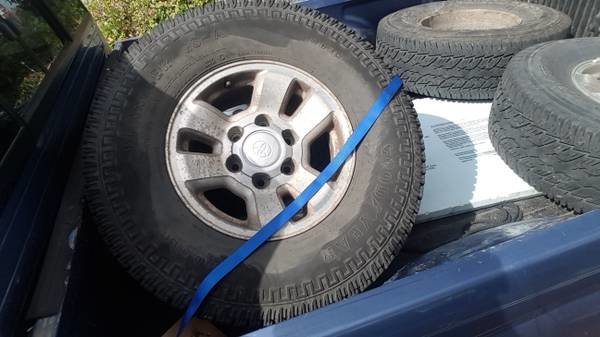

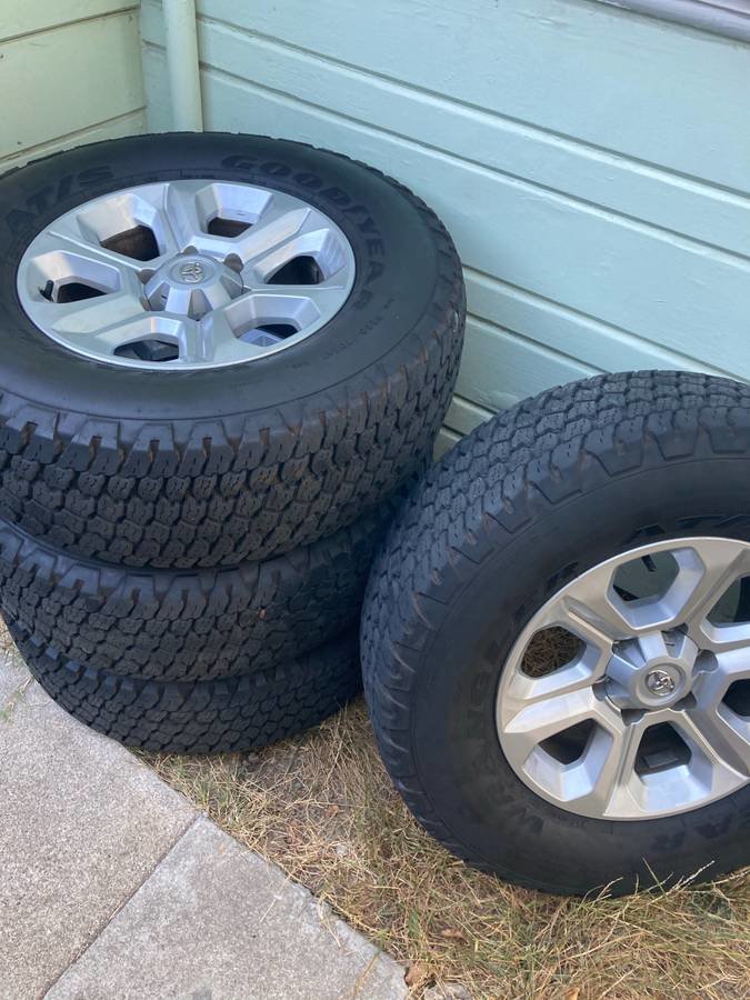

    I have both the 15" and 16" wheels of those stock Tacoma aluminum alloy wheels in the picture. My truck currently has the 15" OEM aluminum alloy wheels installed.

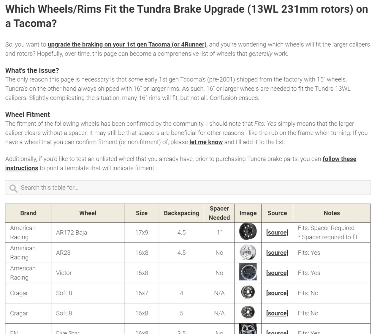

    So, this is semi-related, but I think hopefully useful information for folks who come to this thread.
    I've put together a page with the wheels that are confirmed to fit (or not fit) with Tundra 13WL calipers. Table is searchable for ease of use.
    Lots of help from folks on TW, which was great, and I've scrubbed several other sources (T4R.org, pirate, ttora, fb, etc.). As always, if you have additional wheels that fit/don't, please feel free to let me know.
    Which Wheels/Rims Fit the Tundra Brake Upgrade (13WL 231mm rotors) on a Tacoma?

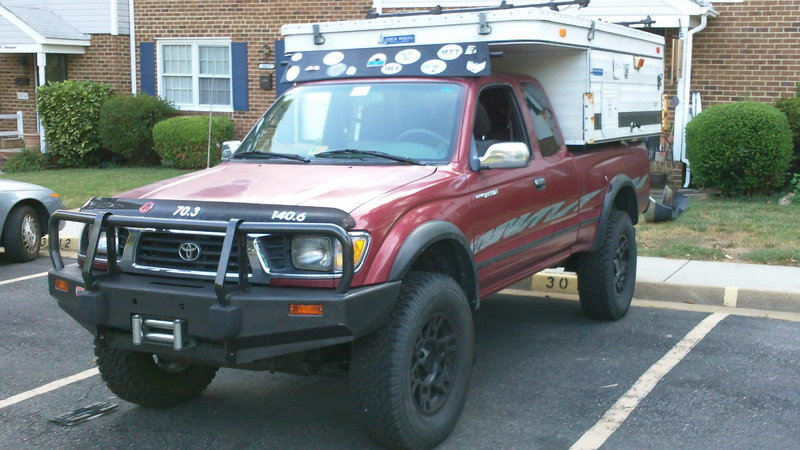

    OME front and rear suspension, ABR deluxe bull bar, Black FJ 17 inch SEMA wheel with treadwright 265/70/R17 E, Bushwacker fender flares, Stock rear bumper, Eagle 4 wheel camper.
    Yep running the same set up and love it !!!!!

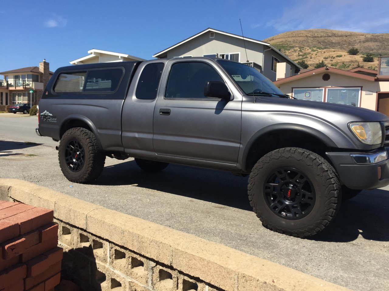

    Just to verify, that's stock suspension etc? I'm wanting to go with the same 17's soon but keep suspension stock.

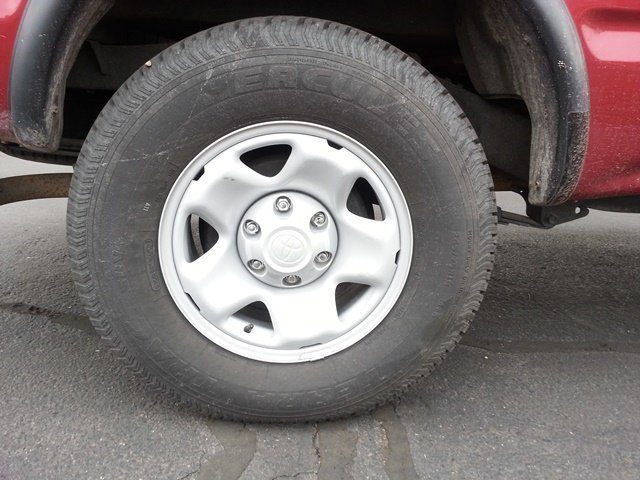

    Post pics? Sure! Brand New 16 inch steelies from a brand new 2014 Tacoma mounted on my 2000 PreRunner Extracab. In 2014 I paid $50 for all 4 wheels, and, no, they were not stolen. Like many of you these are the owner's "take-offs" that he replaced with something more upscale. Keep those "take offs" coming, boys, sure keeps my tire costs reasonable!

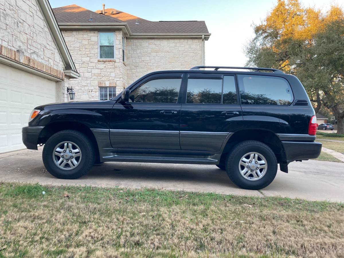

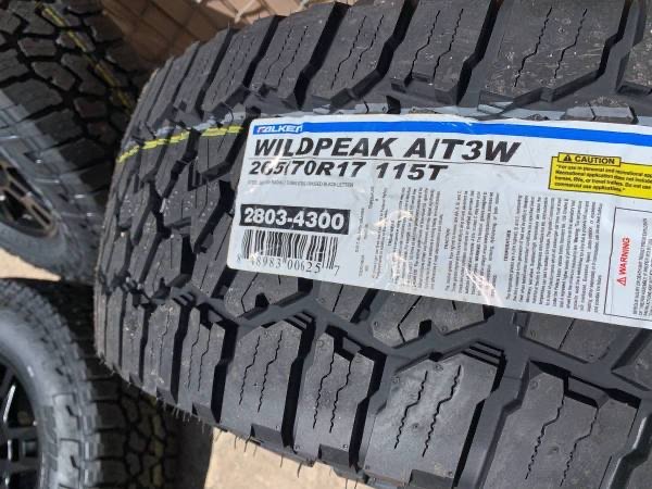

    Just joined the taco club this week. Sold my 100 series Lancruiser (2000 LX470) earlier this month, and missed having a tailgate to camp with, so a 4Runner would not do.. I purchased some spidertrax 1.25 spacers, and plan on pulling the trigger on these TRD replicas 265 70 R17 with Falken Wildpeak a/t3w's. The replicas are 8 inches wide vs stock TRD oem 7, and I'm not sure what their backspace is going to be. Hence the the spacers.. The game plan is to load up with a go fast camper setup in the back, and get a 2-2.5 inch lift. Would love to see part numbers and links if anyone has suggestions. Bilstein 5100's and OME springs seem to be the consensus. Just not sure which ones to order. The camper will be around 275 lbs, and this will eventually be an overland set up. I looked into the 3rd gen TRD pro wheels & the backspace is different, so to my knowledge spacers are recommended any time you go with newer Toyota wheels with some exceptions for certain 4Runner wheels. I'm going to be adding on weight as I go (and can afford), but don't want to buy things twice. Wanted to know if anyone could chime in with some advice, or if they have ran a similar set up. Photos of my prior set up, new 2003 TRD 4x4 DC, and what the end idea is:

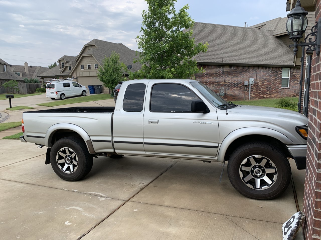

    Just got some stock Gunmetal 17in TRD Rims from a 4Runner running 265/70/r17, they look really fucking good and can confirm no rubbing except maybe at full lock and even then Im not sure.
