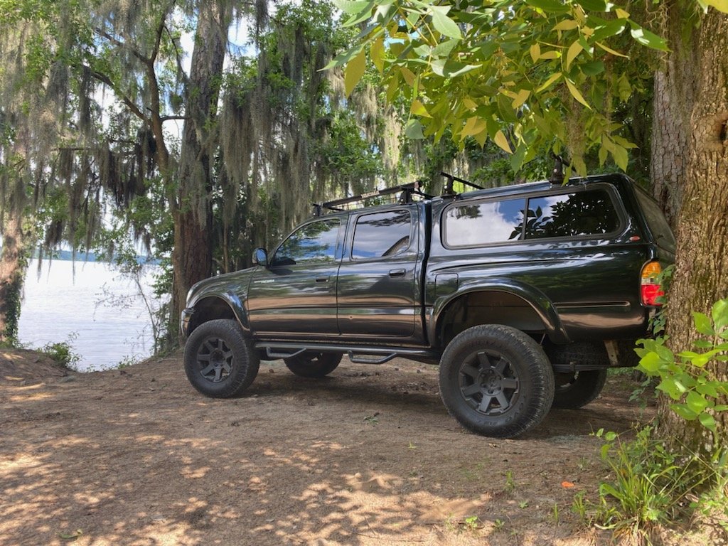

    2001 Tacoma Limited Double Cab

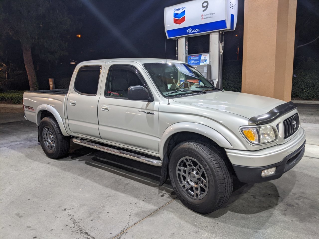

    Stock suspension or any spacers used. Truck looks great with that combo!
  4. Jun 16, 2021 at 11:28 PM

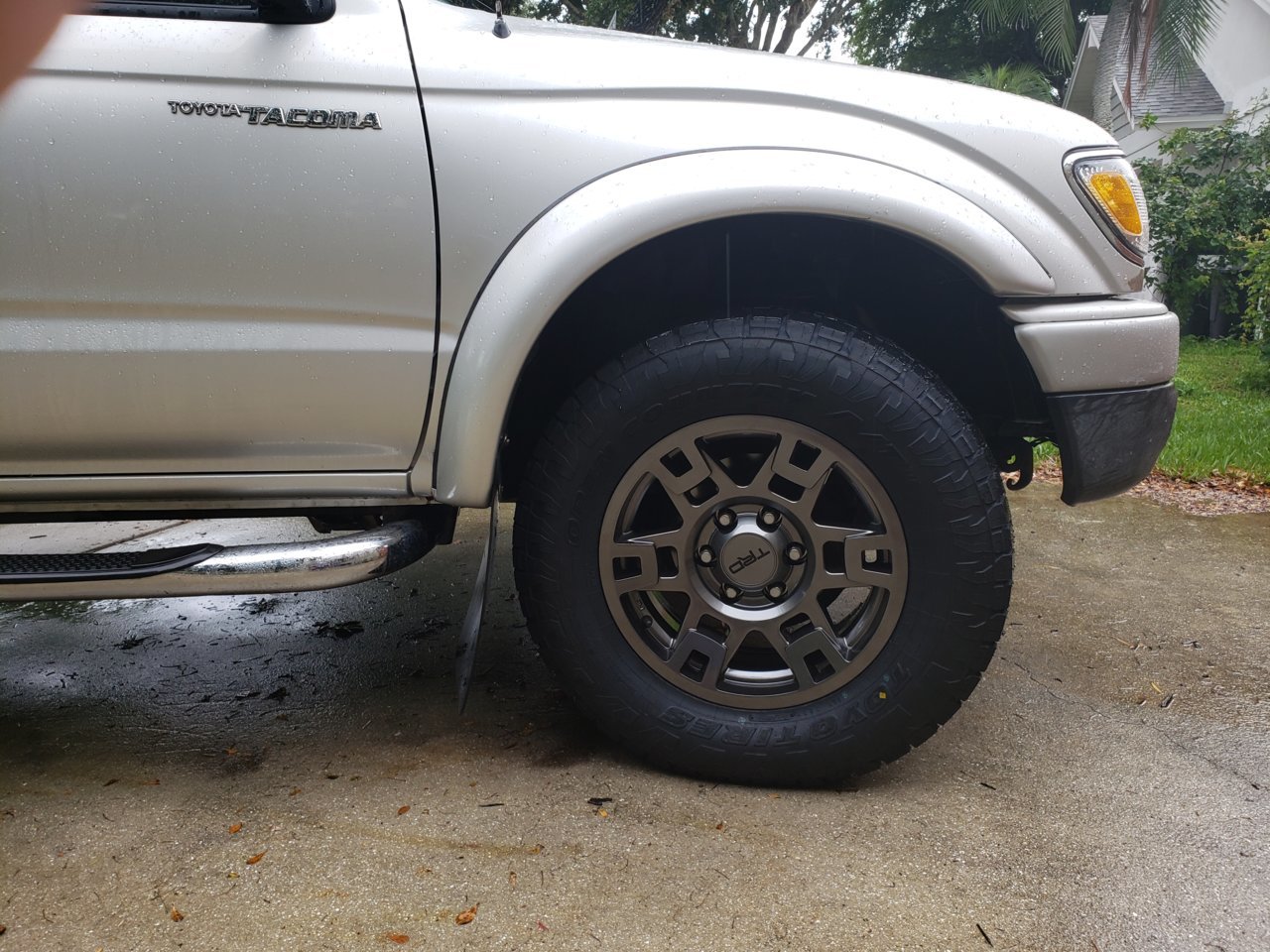

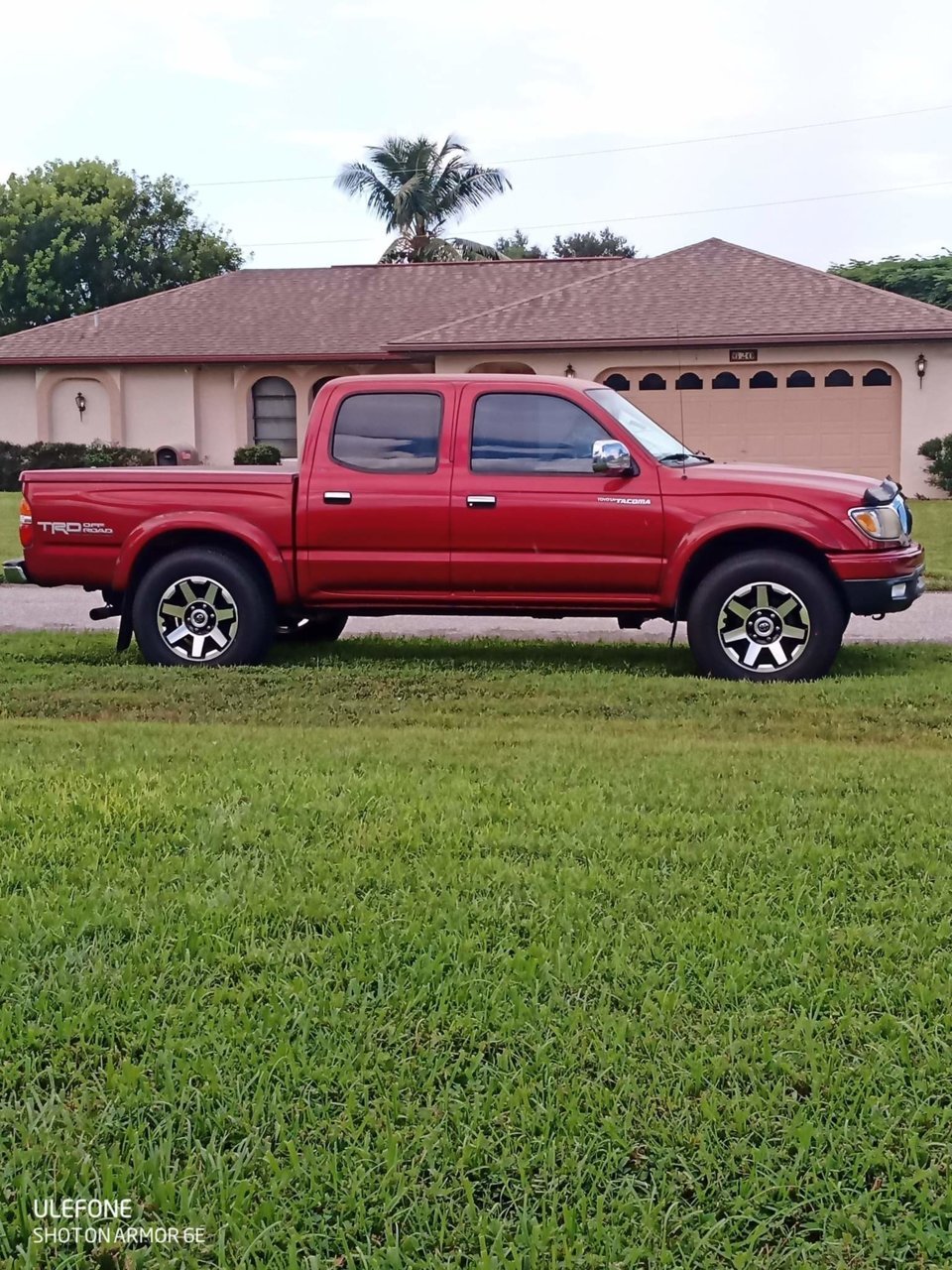

    285/70/17 Toyo OC AT2 on powdercoated 5th gen T4R TRD Off Road wheels 17"x7.5", OME 882 w/2" BL
    I went with Bora .75" front wheel spacers, since I didn't want to over poke the wheels past the fender, it fits no rubbing. Factory studs had to be shaved off a little, which I didn't mind. Of course it also clears for TBU as well.

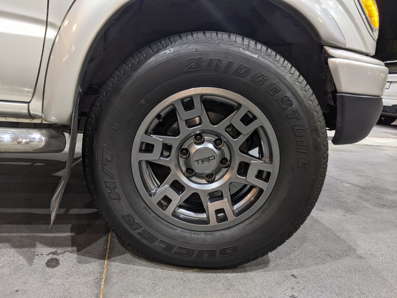

    2001 v6, 2wd 6 lug, stock suspension.
    OEM gloss grey TRD rims
    Toyo open country 3s- 265/65/17-- no rubbing at all
    No rubbing at all. Now I just need black lugnuts

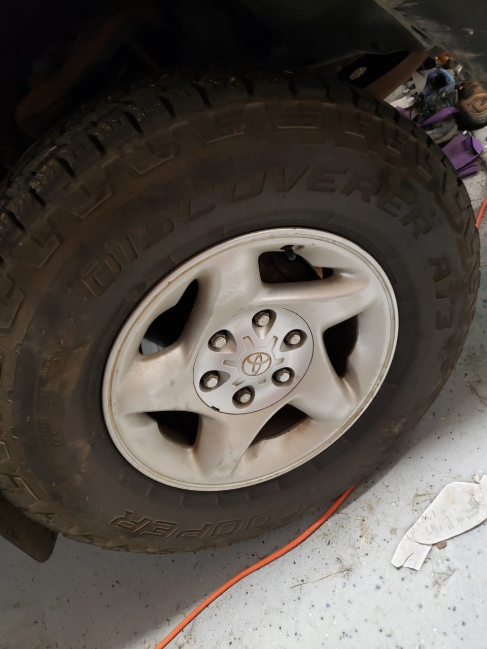

    This might be slightly off topic. I came to this thread cause I replaced my 16" steel wheels with first generation 16" Alloys on my 99 Tacoma since the steelies were rusting cause this is my snowboarding truck. The offset shouldn't be an issue here. I put on some Cooper Discover photo attached. Overall they handle great and I did a gnarly off road after ~150 miles of highway driving the first weekend. I've noticed a bit of a shimmy at highway speeds and sometimes in town, it feels like there is a bounce. I know the ride will be stiffer because of the reduced tire size. The old tires gave a mild vibration, though not like this, and I thought it was due to being 7 years old with uneven wear. Also I put new KYB shocks on last fall.
    It this alignment? Do I need to have the tire store double check the mounting and balance?
    thanks for you comments. Not mechanically savvy here

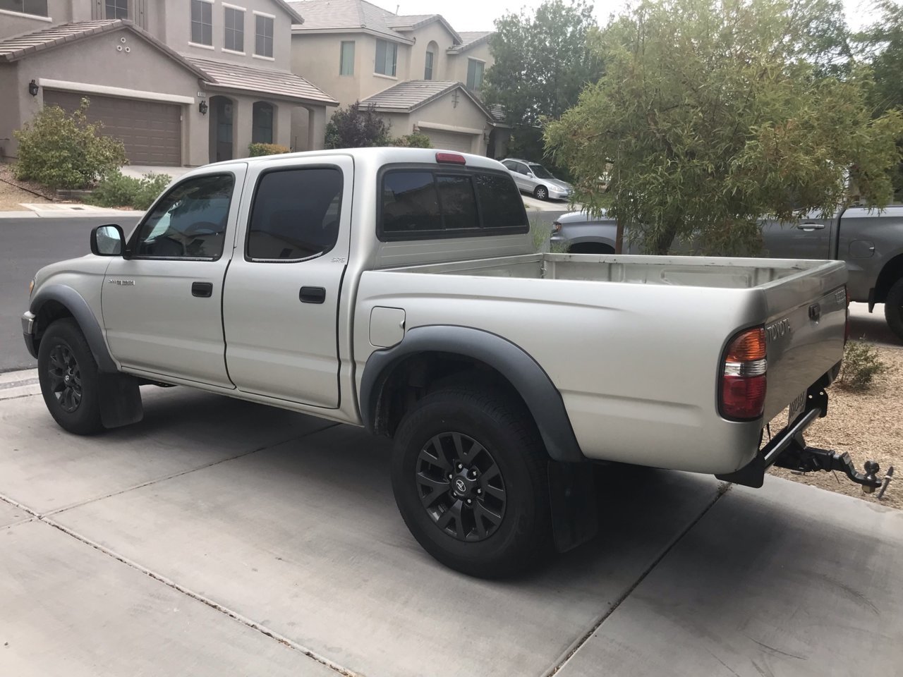

    2001 short bed Tacoma
    None

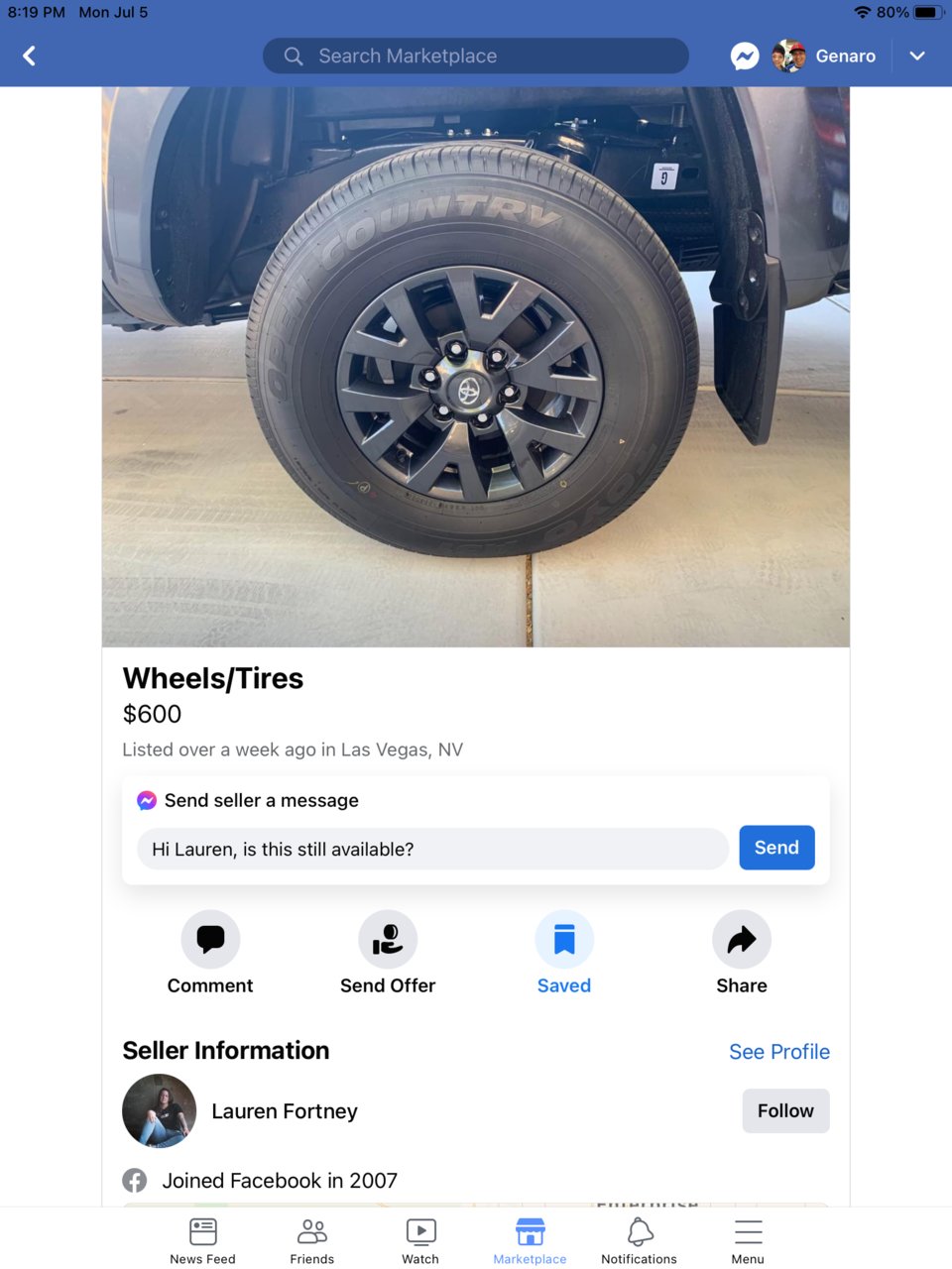

    I’m interested in replacing my stoke tires with theses wheels below, would these wheels fit ok ? Will the backspacing be really noticeable or rub on any interior part? Or would I have to add or modify anything ? Don’t want to put out the money and then have wheels that I can’t use
    I believe these are coming from 2021 sr5
  9. Jul 12, 2021 at 10:14 PM
    #69
    Taco_01
    Taco_01 New Member
    Jul 8, 2021
    #370795
    2
    1st or 2nd pic ? Thanks

    2 TRD OR wheels FTW

    I like your taste of wheels and color :thumbsup::cool:
    2nd, they polish up great

    Mine are 2020 SR5. Without fender flares I found the offset to be great. Wheels are tucked a little more than stock. This helped keeping road debris/spray in the wheel wells. Once I installed my Bushwacker 2" fender flares, I found that the offset is too much. I run 1.25" spacers with the fender flares now. Also to note, I have no rubbing issues with this wheel/tire combo. My truck does have a 2" lift.
    Vegasgenaro[QUOTED] likes this.
    None
    installed them today, with no spacers. Drove it for a little , doesn’t seem to have no issues . 2021 stock sr5 wheels

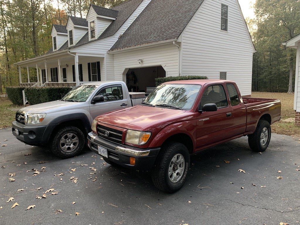

    1998, 2007 and 2020 Tacoma

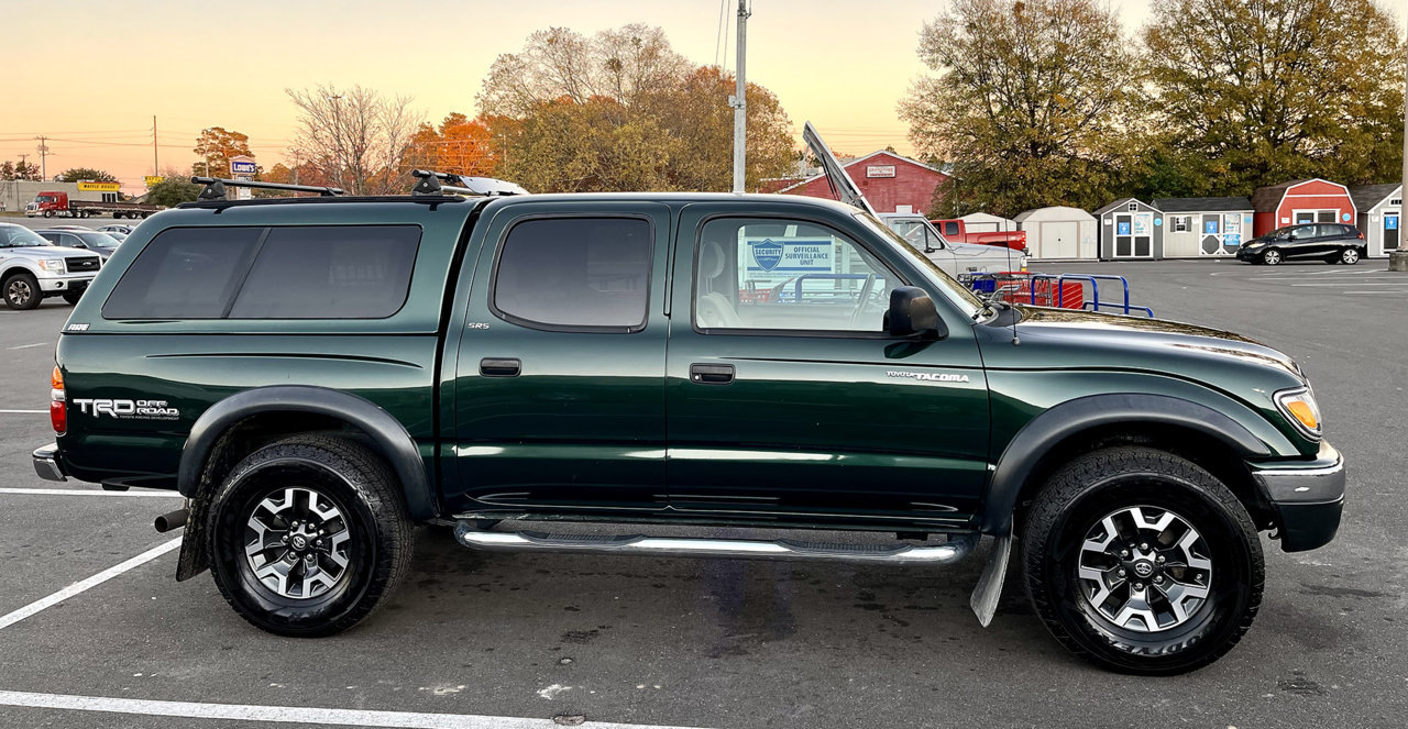

    The wheels and tires 265-70R16 that are on the my 1998 4X4 SR5 were purchased from another owner with a 2013 Tacoma SR5. Interestingly enough the wheels on the 2007 Tacoma Base were off of a 2013 Tundra. 07-98 Tacomas.jpg

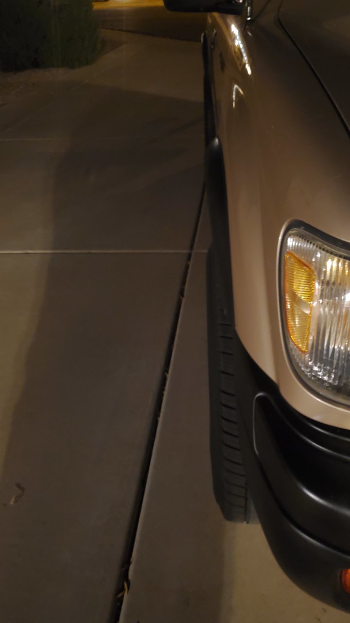

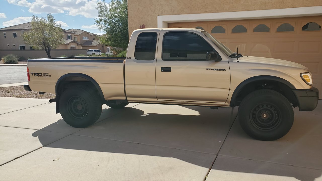

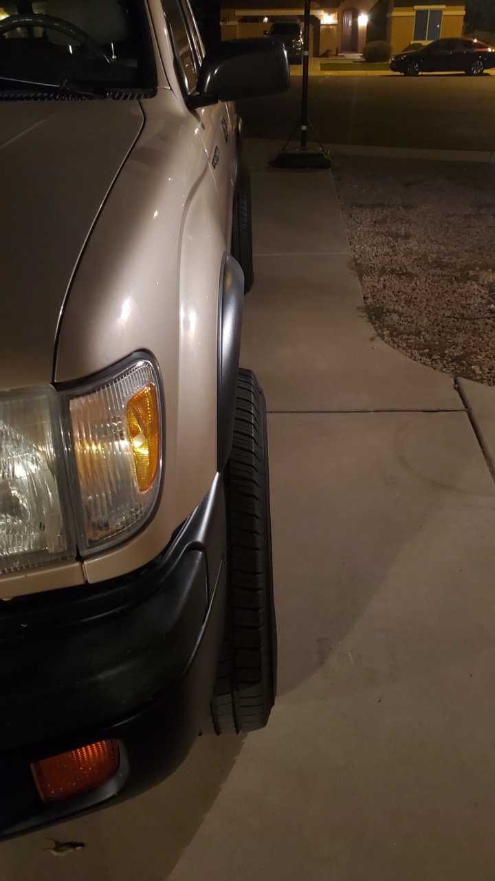

    Here are my 16" Toyota spare wheels installed. These are spare rims that came on 98-04 Tacomas. Took a while to collect 4 of them but they cost anywhere from $25-50 each. I scrubbed them down and hit them with a coat of flat black paint. Couple days ago added Spidertrax wheel spacers (2nd & 3rd pic). Btw I was able to sell my oem aluminmum wheels to a metal recycling facility for $30. No one wanted to buy them when I listed them lol (not big surprise)
    These wheels are said to have clearance for the Tundra brake upgrade which I'll likely do down the line.
