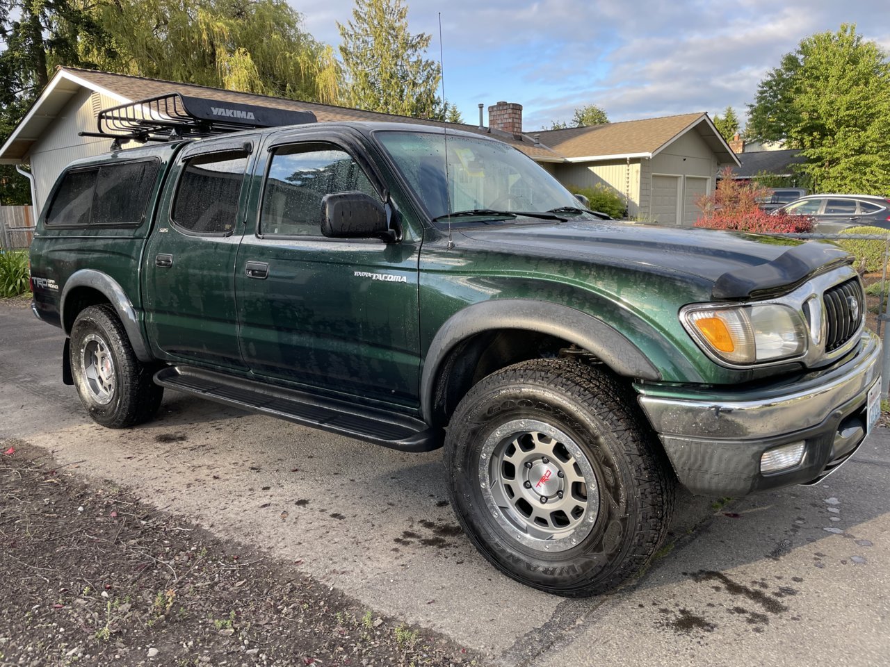

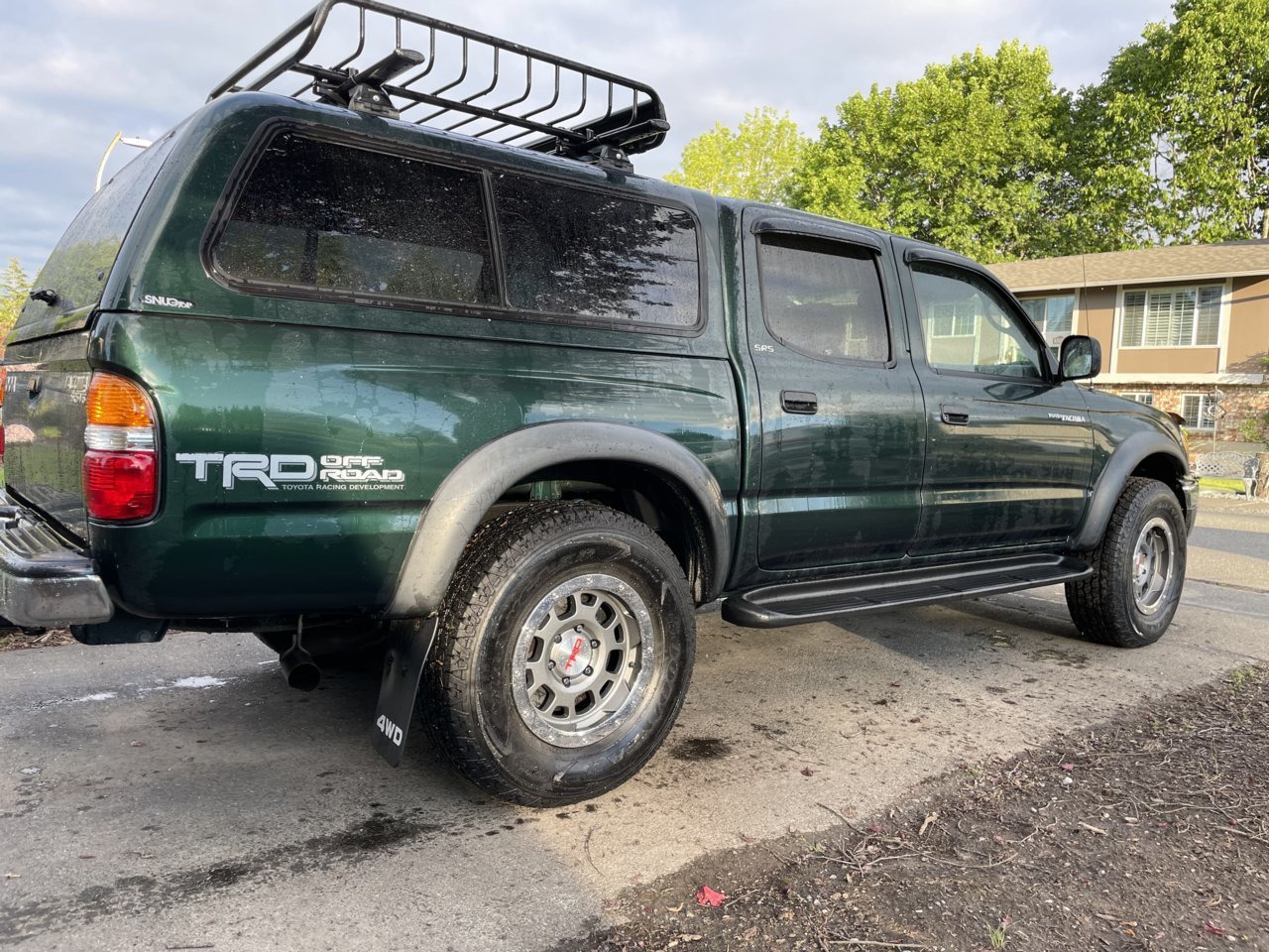

    2003 Toyota Tacoma TRD 4x4 Double Cab
    TRD Beadlock Style Wheels
    That’s the best color on these wheels :thumbsup:
  8. Jun 7, 2022 at 9:26 AM
    #88
    JadeTRD
    JadeTRD TRD Beadlock Style wheels in graphite
    Jun 21, 2021
    #369236
    52
    Will
    Confirmed fit:TRD Beadlock Style with 265/70 R16 Goodyear Wrangler Kevlar, no rub, stock suspension.

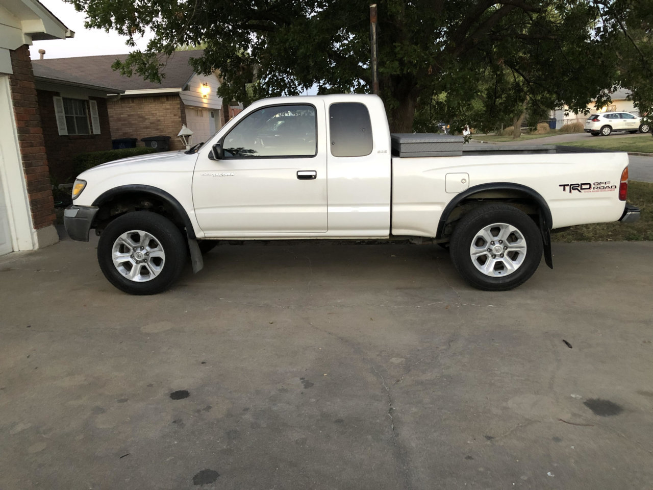

    '99 TRD manual

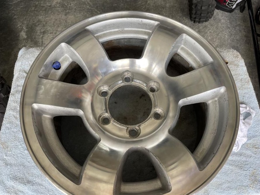

    thanks to this thread I got some 2nd gen rims for my first gen.
    I didnt like my wide wheels and no options to go narrow and tall, so now with 17's, it opens a lot of options. :thumbsup:
    drove around the neighborhood, no rubbing. :bananadance:
    from 8x15 rims to 7x17 only a 18# weight difference, each. :broccoli:
    current tire on 245/70 17 plan to change soon, i want pizza cutters :dancingbacon:

    I am concerned about the lug nuts…. The OD of the nut doesn’t fill in much on the second Gen rim.
    I brought the largest OD ones from O’Reillys.
    https://www.oreillyauto.com/detail/c/mcgard/tire---wheel/wheel-lug-nuts---studs/lug-nut/835b5ec42d53/mcgard-m12-1-50-thread-3-4-inch-hex-wheel-lug-nut/mcg0/64012/v/a/18885/automotive-truck-2006-toyota-tacoma
    But I’m guessing I really need to purchase these
    https://www.oreillyauto.com/detail/...v/a/18885/automotive-truck-2006-toyota-tacoma
    the washer would fill in the rim quite a bit better.
