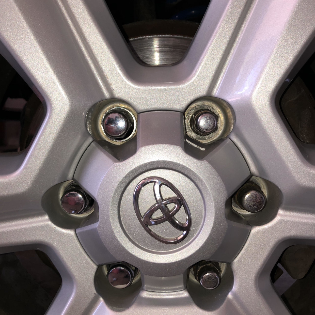

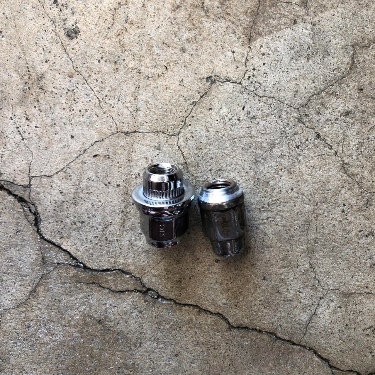

    I got my Amazon lug nuts on
    https://www.amazon.com/dp/B08J6DQ8YB?ref=ppx_yo2ov_dt_b_product_details
    MIKKUPPA M12x1.5 Lug Nuts Set of 24pcs Hex 13/16'' (21mm) Chrome OEM Factory Style Mag Seat Lug Nuts Replacement for Toyota
    left new,
    right old acorn style/ cone also known as the universal ones from part stores.
    I feel much safer with these on.
    Now to get tires

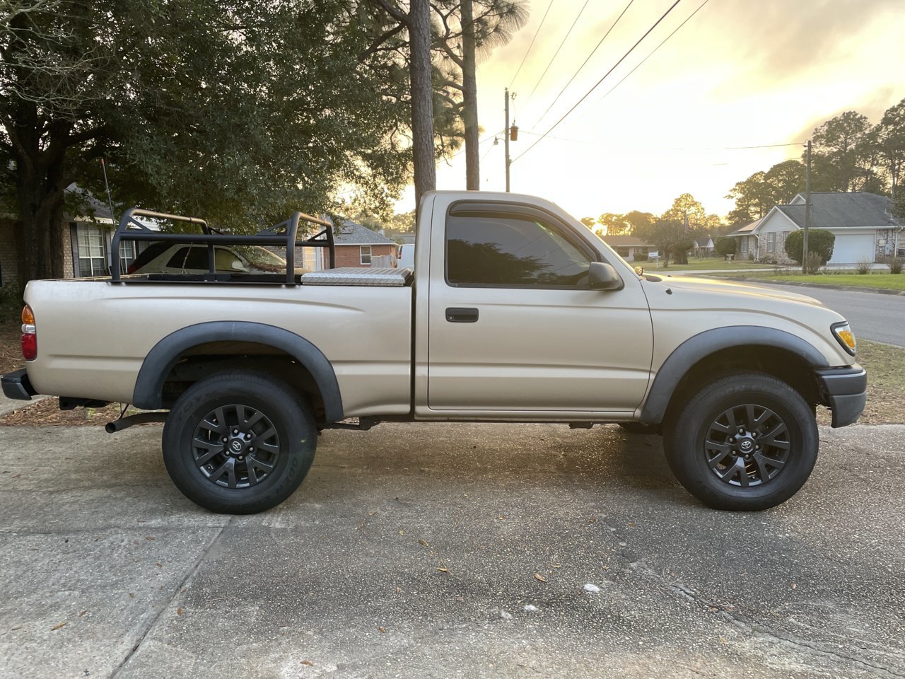

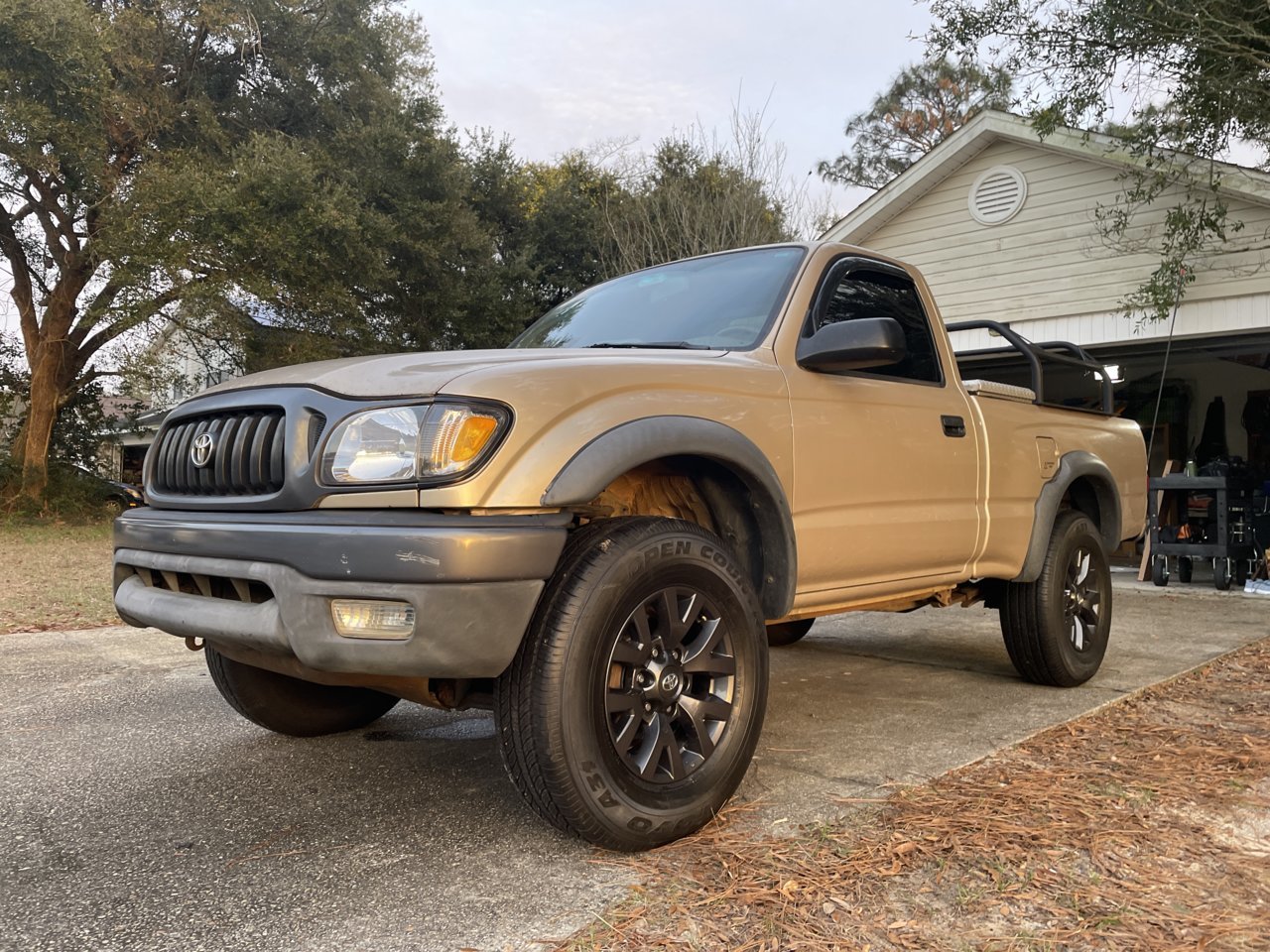

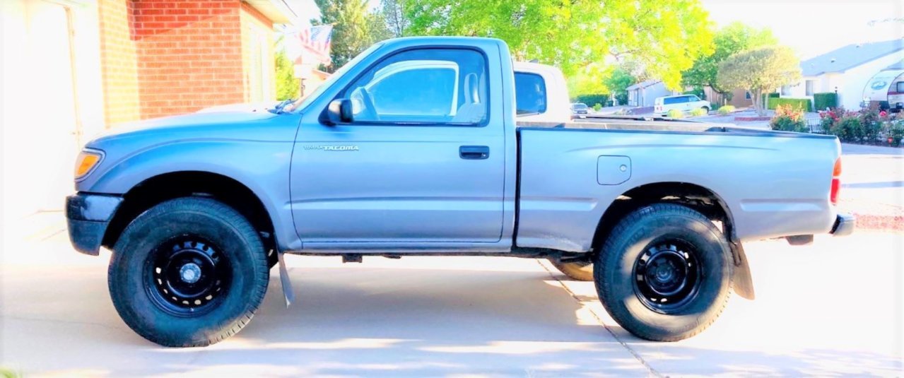

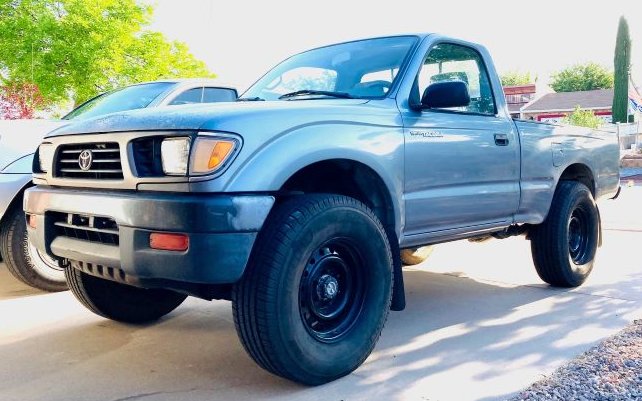

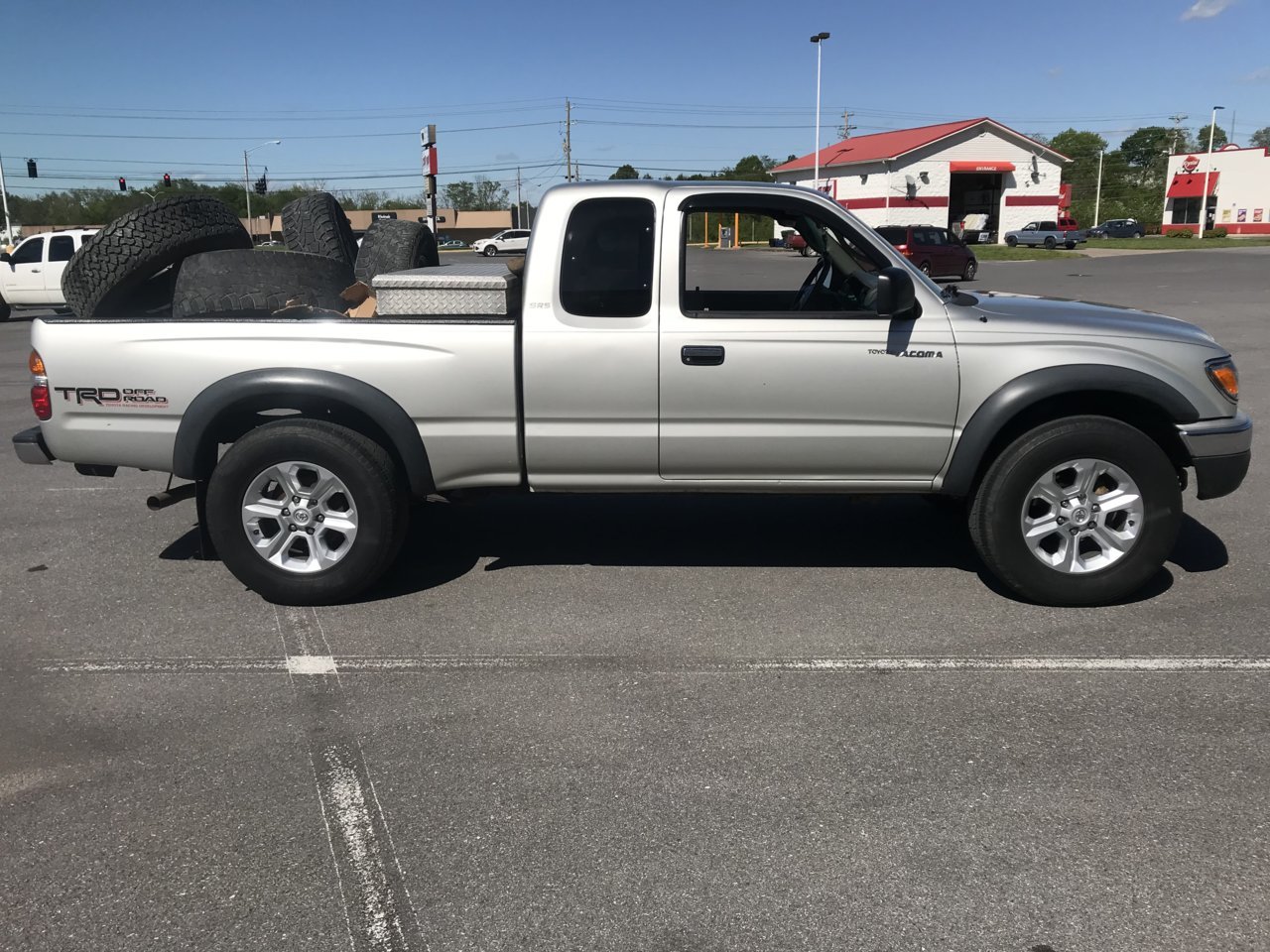

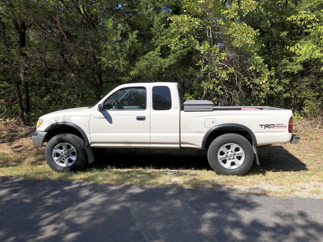

    before and after.
    Not sure what these aftermarket wheels were but I didn't like the lack of availability of different size tires
    15x8 with 30x9.5 actual height
    New 2nd Gen Tacoma wheels 17"
    235/80 17s actual height
    No rubbing thus far.
    SecureIT2021 and Area51Runner like this.

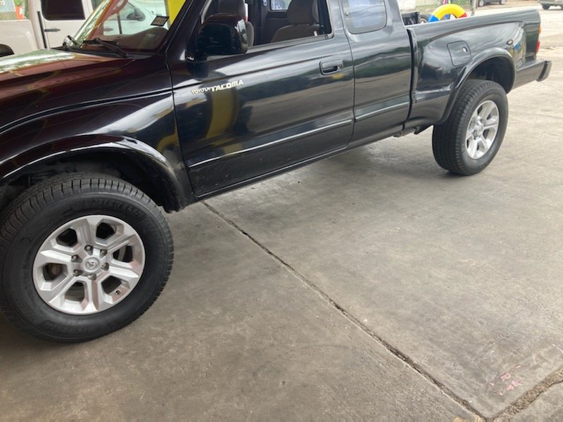

    Thanks for starting this thread and I can confirm these 2020(?) Tacoma wheels fit on my 2001 Tacoma with no rubbing!

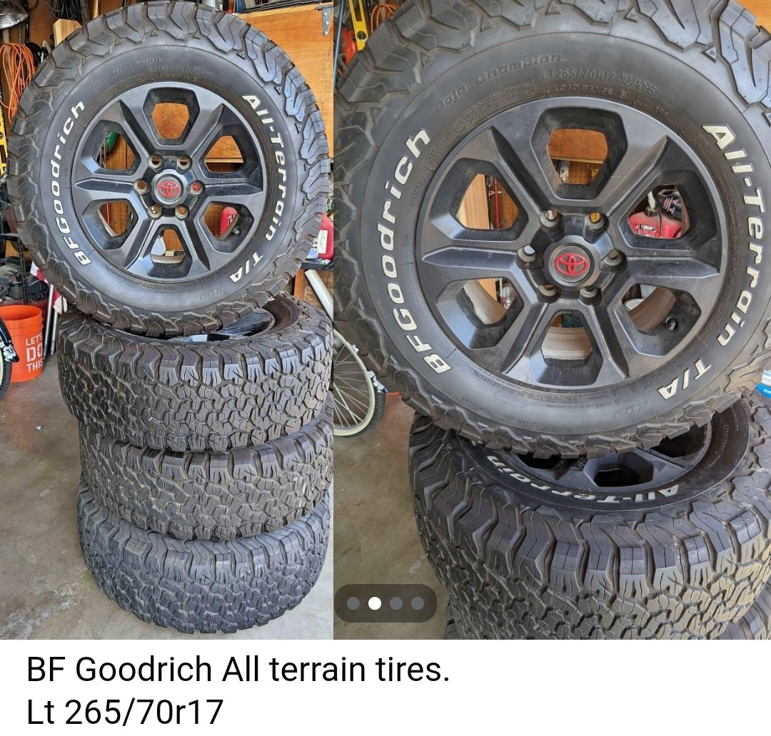

    Can anyone confirm if this will fit a 1st gen Tacoma with Tundra brake upgrade and without the need of spacers?
    They are Lt265/70/r17 wheels.

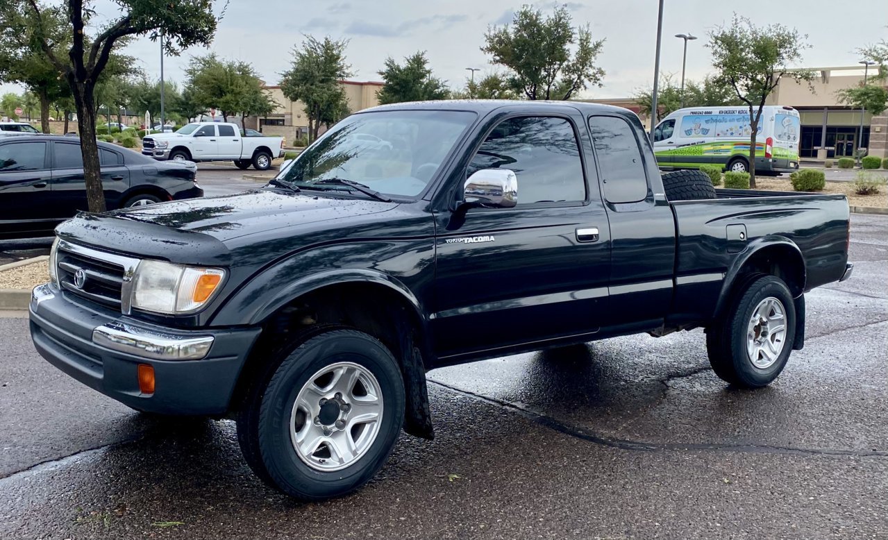

    2000 Black Tacoma SR5 4X4 Manual
    what size tires are these on the 2023 4runner wheels

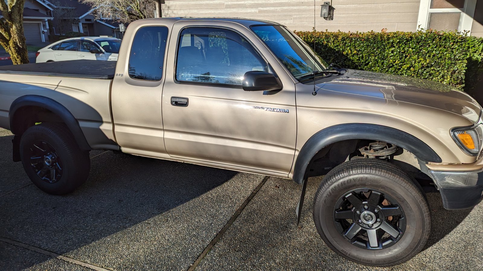

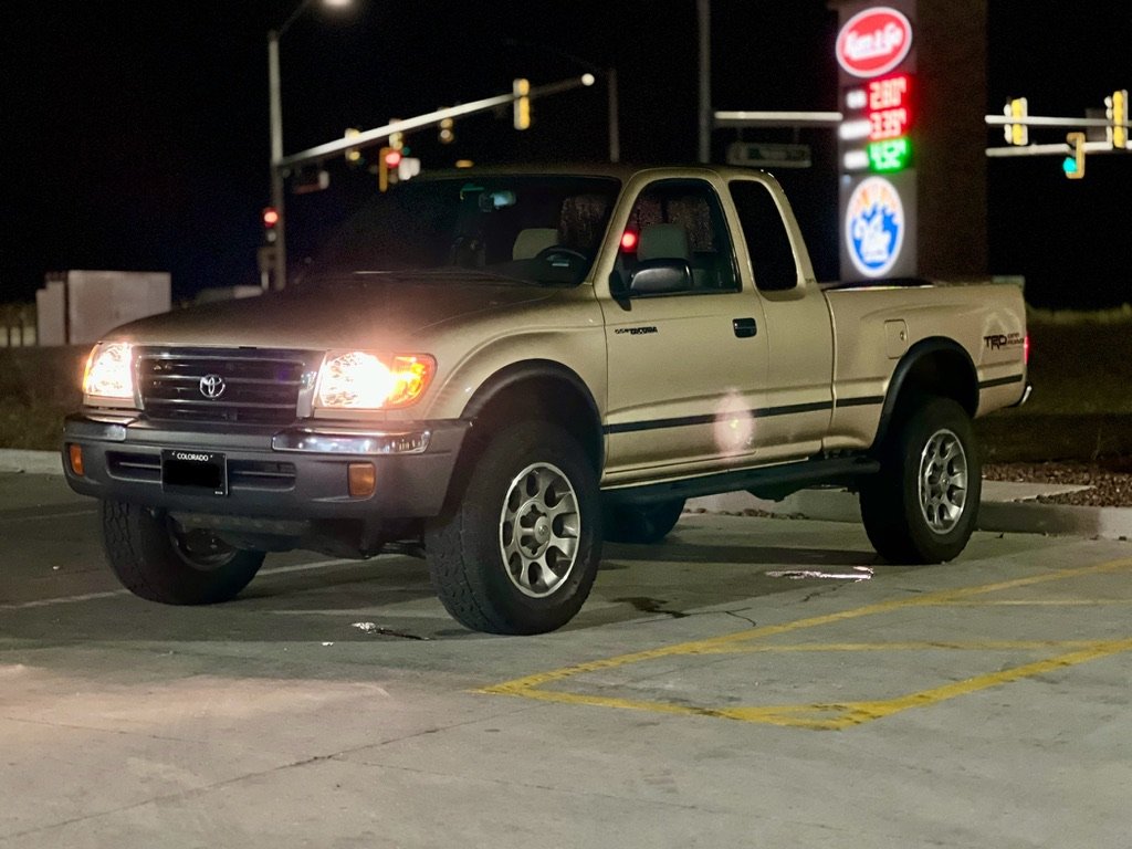

    I used this thread to do my research and forgot to come back and give my update:
    These are the charcoal special order 4Runner wheels and I put in some BFG 275/70r17 and a 2" lift.
  20. Feb 19, 2024 at 4:40 PM
    #120
    DenverMoto
    DenverMoto Well-Known Member
    Apr 5, 2023
    #421950
    110
    Paul
    Tan 1999 Tacoma SR5 Xtracab
    Bone stock so far!
    Those look excellent. Taco lookin cleeeeeeeean!
