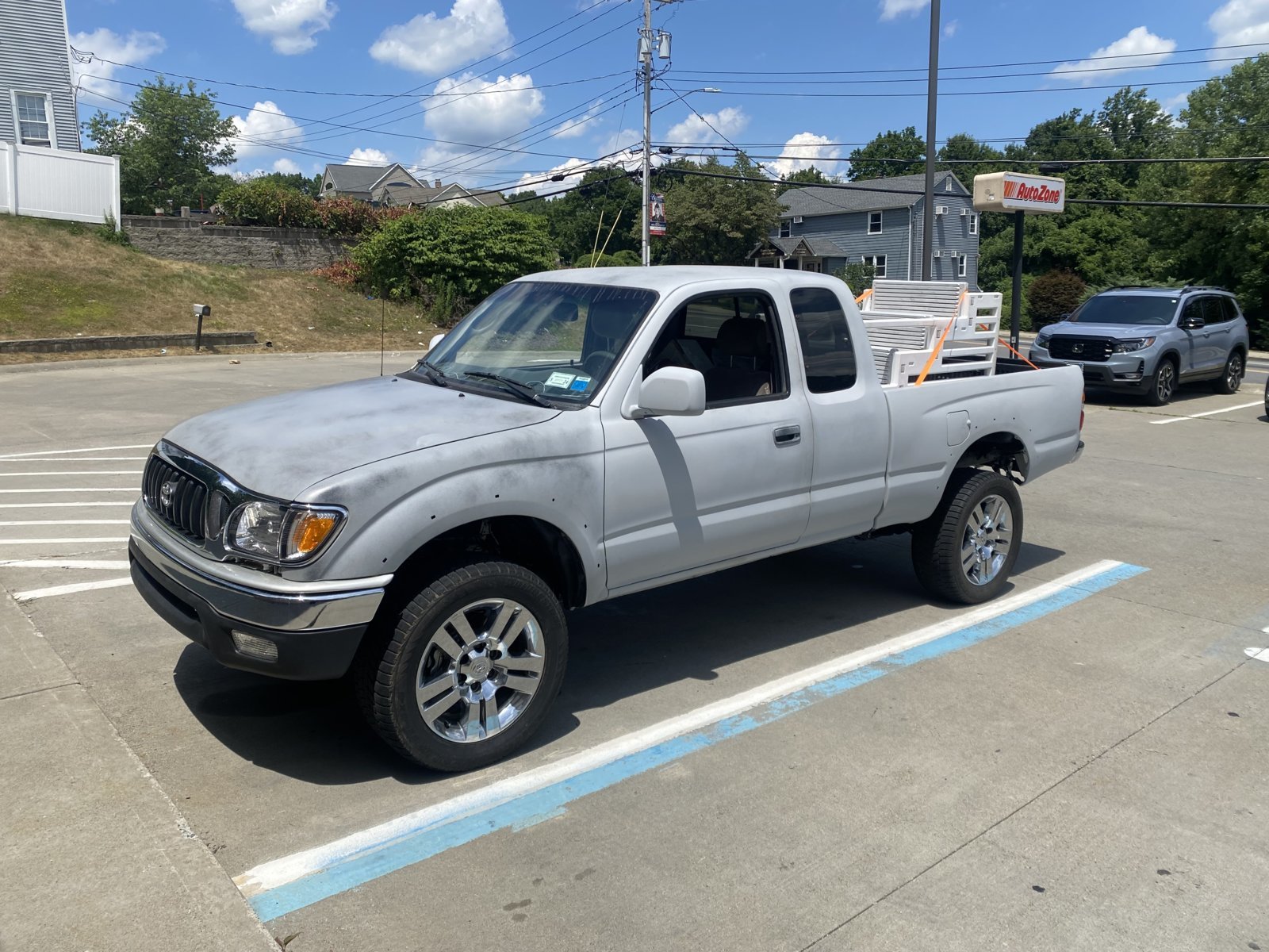

    OEM 2018 Toyota Tacoma Chrome Clad Wheels 18 X 8 on a set of 265/60R18 with absolutely no issues and I have REAR FJ Cruiser Disc brakes/Tundra Front Brakes !

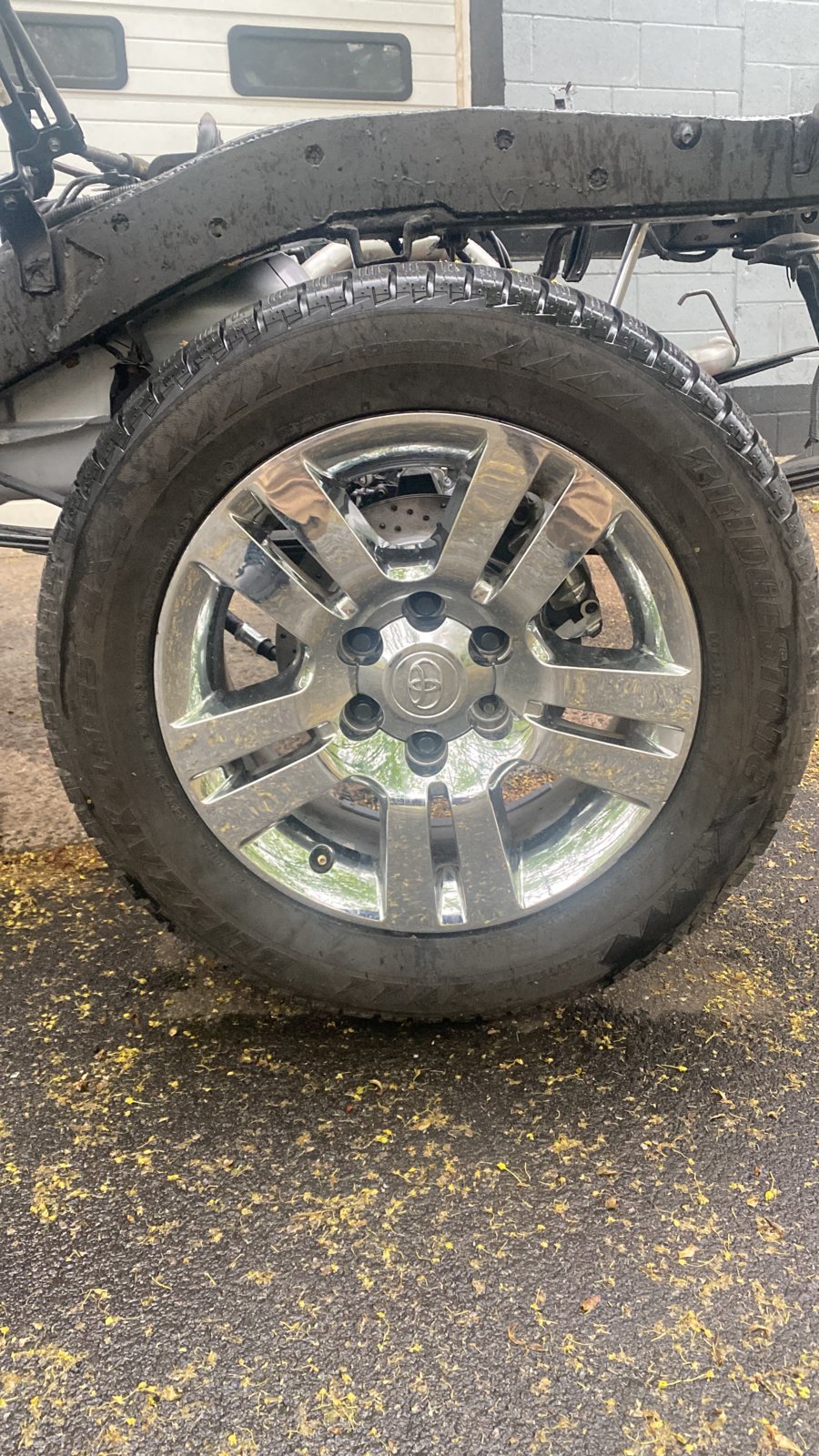

    No clearance issues with the REAR FJ Cruiser Calipers & Rotors.

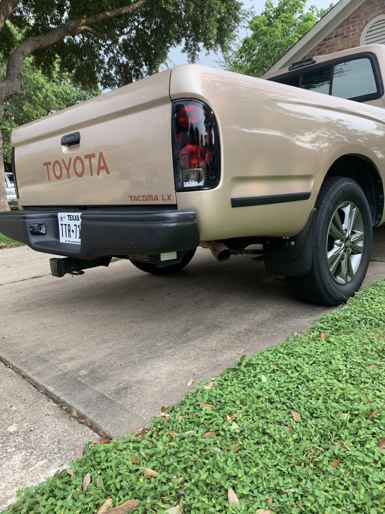

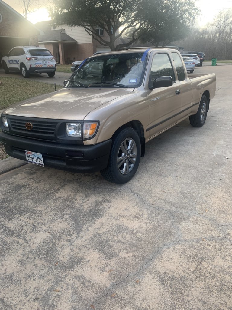

    1996 Taco 2.4L 2wd Automatic
    Clock Volt meter/LSPV Delete/Hyundai 16’s/FP gauge/after 9months of wrenching ZERO oil leaks
    I will play!
    +1 on Sonata rims for 5lugs
    -$100 luck out CL find
    -bolt on
    -no mods/clearance issues
    -225 65 16’s
    -14inch steel lugs fit NP(I found some nice SS lugs on CL too)
    -even front center caps clear bearing dust cover

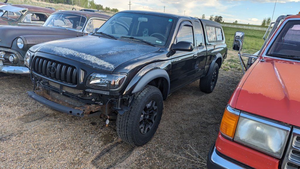

    Black O3 SR5 V6 Extended Cab and Army Green 2022 TRD Off-Road

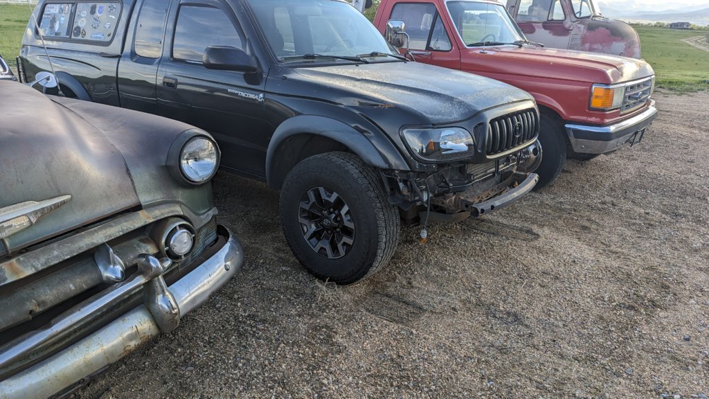

    Did this back in May. The truck is a work in progress so ignore the lack of a front bumper. Put the stock wheels and tires from my '22 on my '03 with no issues. Apart from getting the old wheels off the '03. The truck has been sitting for a few years. Changed the whole look of my poor old beat up Taco.

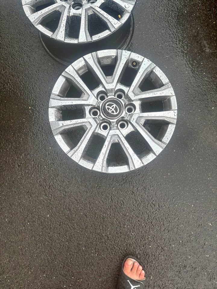

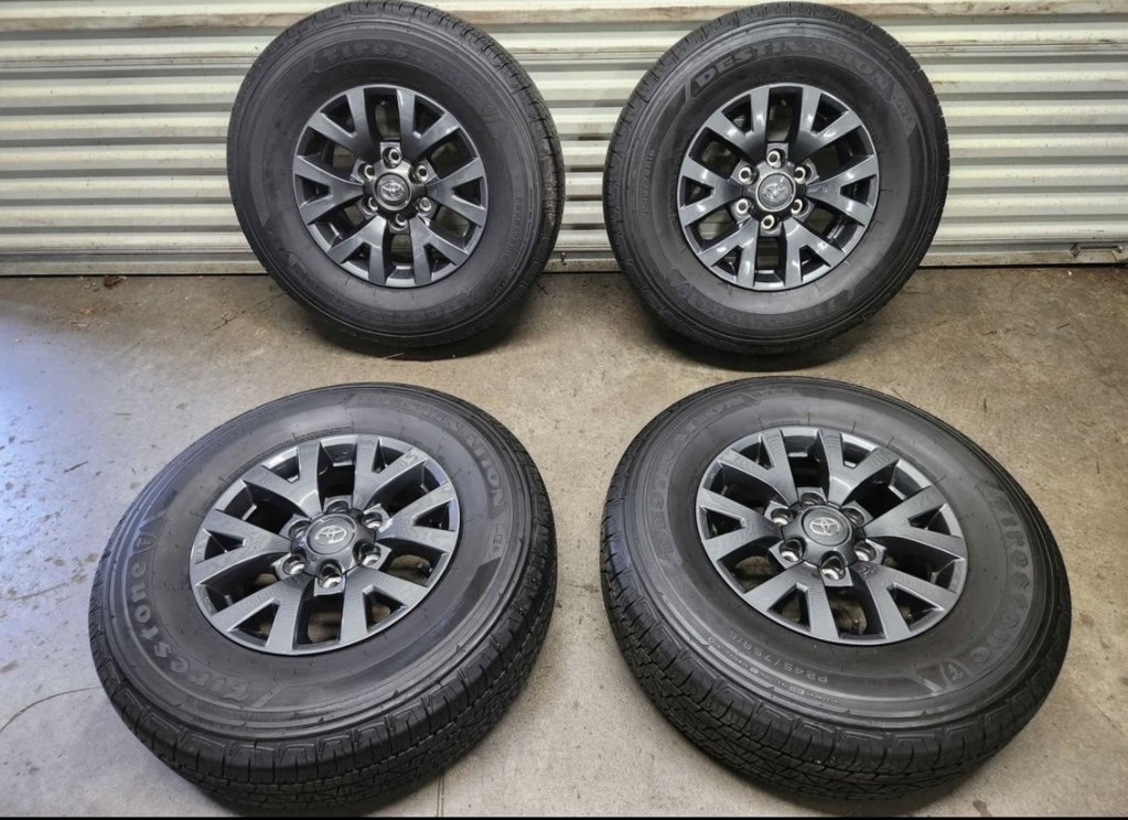

    THEY DO NOT FIT !!! The bore size is 95.2MM our Tacomas are : 106.1MM The 2024 Tacomas are not the same BORE SIZE !

    Those are 3rd gen wheels not 4th. They fit as Turbodb says.
    42611-04230
    They look similar to the 4th gen Limited trim wheel, but thats a different design and only comes in chrome.

    My appoligies to you my friend ! They do look very very similar, as you can see here in the picture below:

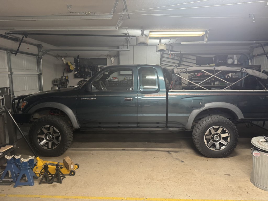

    1995 Tacoma Xtracab LX 4WD 3.4L 5 Speed
    ARB Front Bumper. BFG All-Terrains.
    1995 Tacoma

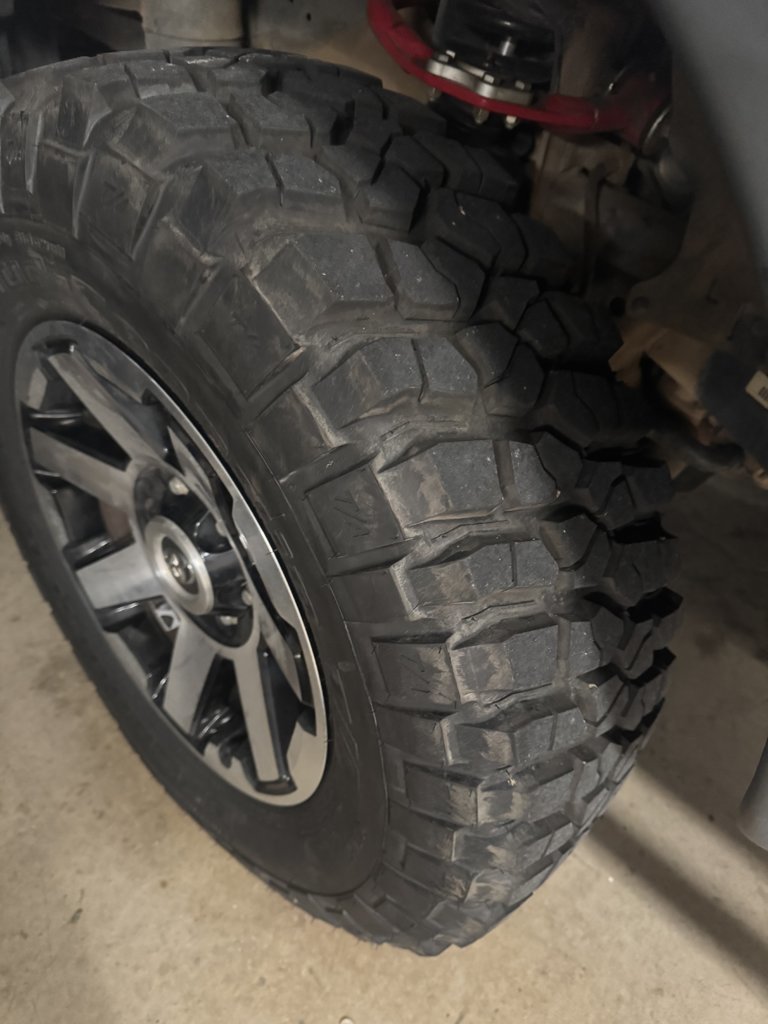

    Trail Edition TRD 4Runner wheels
    255 75 17 (pizza cutters) BFG KM2
    1” spacers.

    What is the ET on those wheels ?
  20. Jan 16, 2025 at 10:51 AM
    #140
    DrBobbySaget
    DrBobbySaget Member
    Sep 5, 2023
    #432838
    22
    17"x7.5" +15 offset. BS is 4.5"
