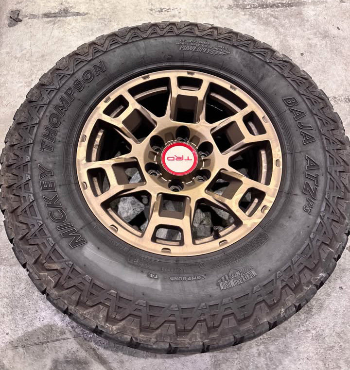

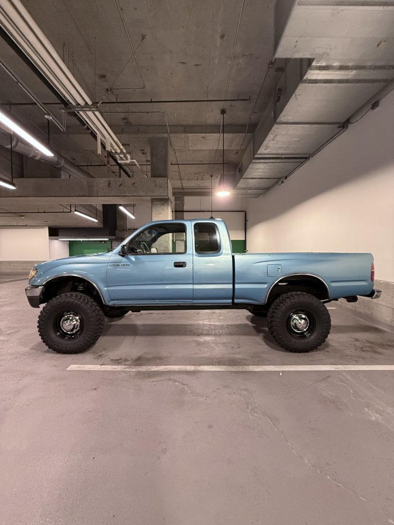

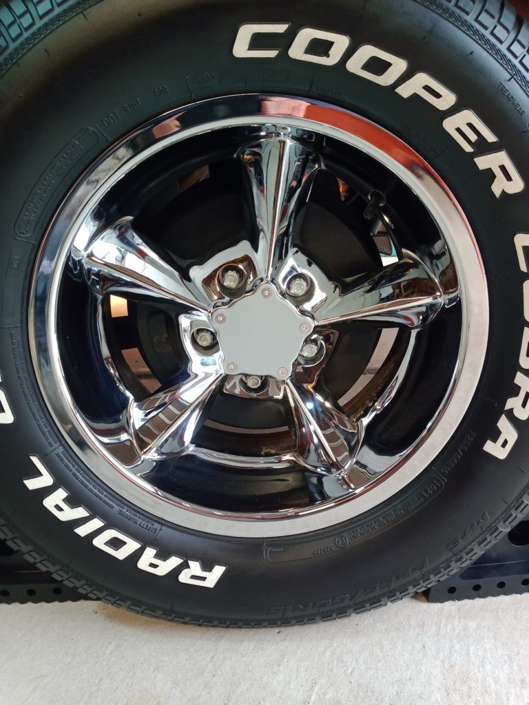

    Will these work on my 1997 Base model without mods? Tires are 285/70/17.

    I have the older 4runner pro wheels on my 1st gen with 265/70/17 and rub at full lock backing up. Suspension is ome 2881 and camburg uca. Wheel bolt pattern fits no problem, although its looks like you have locking front hubs and im not sure if those would fit through the center cap area? Center cap on new 4runner pro wheel is 3in just measured on my 4runner

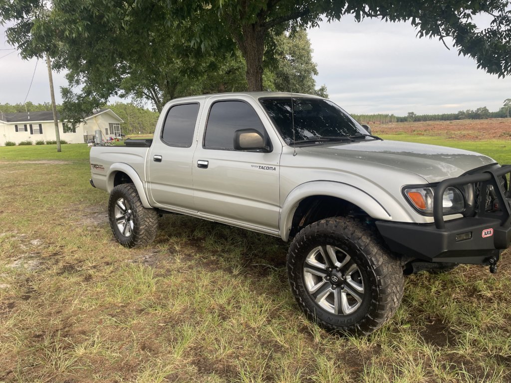

    33x12.5 MTs on these 3rd gen limited wheels. From what I can find, they’re 18x7.5 with +18 mm or + 25 mm ( I’ve found differing information). Already have 1” spacer but I rub the frame horribly at full lock. I’m thinking I’ll need a 2” spacer to keep from rubbing the frame. Any input?

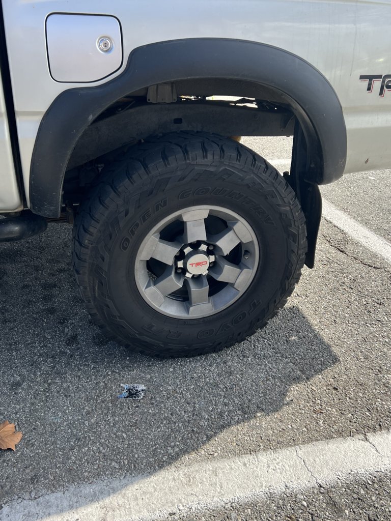

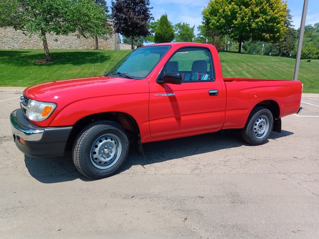

    Wheels from an FJ40. Part # 42601-60072

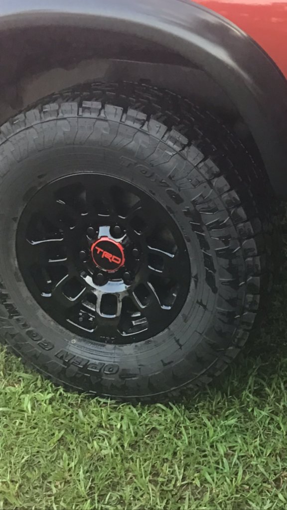

    Love my gloss black 16” TRD Pro 8 spokes for 2016-2019 Tacoma w/ Toyo Open Country 265/75 AT 3’s. With a 13mm offset, these are one of the closest to our first gen. 6 lug stock wheels(15mm), no rubbing at full lock w/stock suspension, no spacers, and my fender liner zip tie mod.

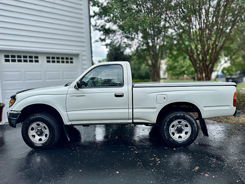

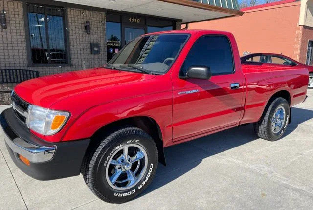

    IMG_20250729_140305052.jpg BG Rod Works Old School wheels on a 1999 base 2WD. No spacers required.
    I always thought the BG wheels looked too wide for this application.
    I ended up selling them and going with the stock configuration.

    Wow truck looks really good on those stock steelies. Any issues running a 15" wheel on the front brake rotors (any rubbing)? What size tire are you running? Do you have a part number for the hubcaps? sorry for all the questions.

    No rubbing issues at all. Tire size is 33x10.5 toyo open country MTs. Part number for the hub caps are 42624-60010-86

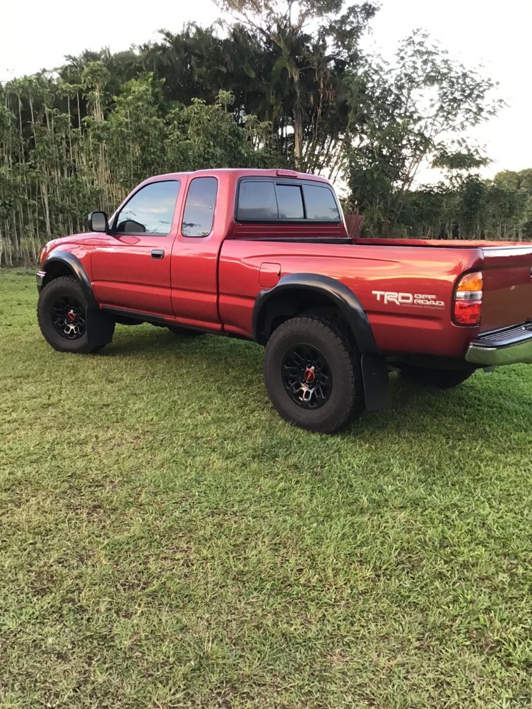

    2.5" Lift, Bilstein shocks, 33x12.50r15 Wheels and Tires

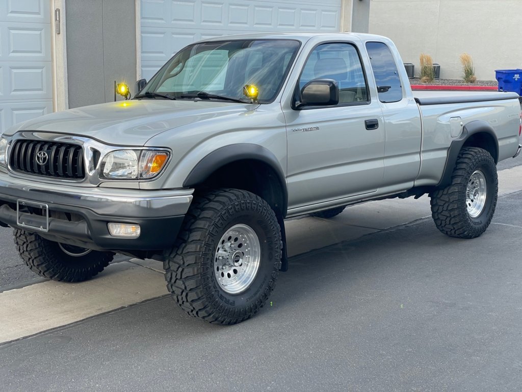

    Thought i'd throw mine up there. 2.5" lift with 33x12.50r15... I believe the offset is +7. Slight rub when backing up on full turntacoma.jpg
