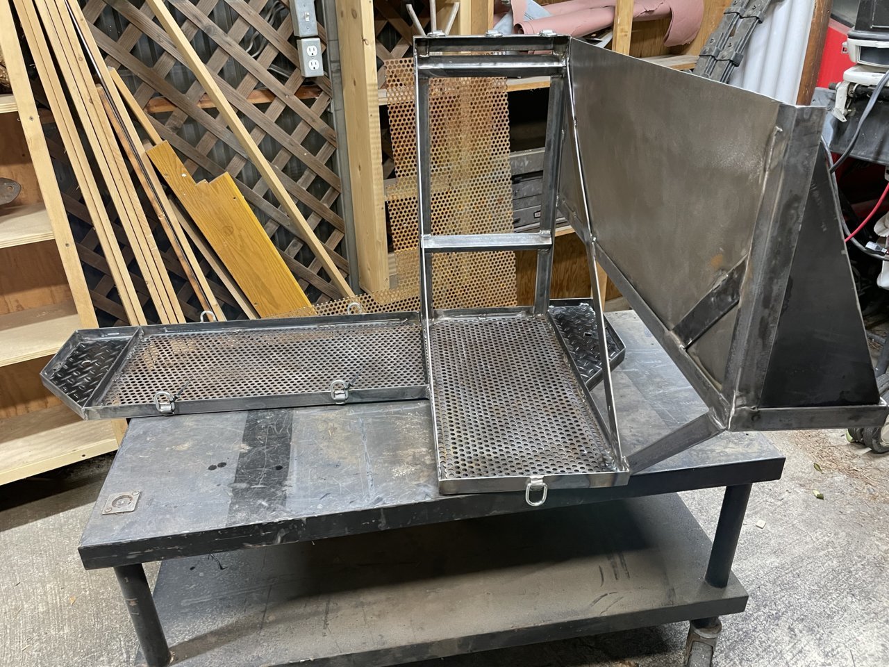

    One more half day of fabricating and I should be ready to paint.

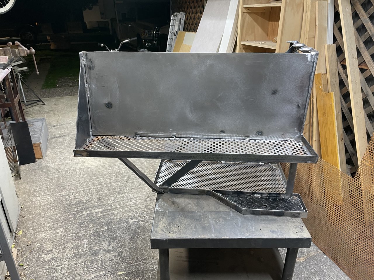

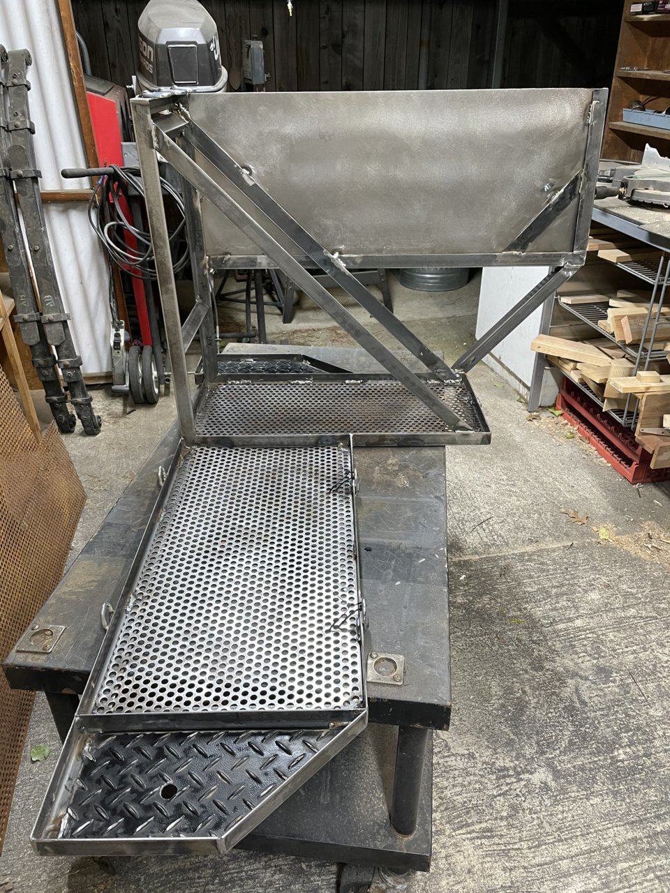

    If I had a pipe bender handy I would have used round tube. But angle iron is hands down the bast bank for your buck.

    Notching round tube is a nightmare anyways

    True.... but it’s more aesthetically pleasing.

    There’s not plans. I’m really just fitting pieces as I go. It’s definitely not the way a professional would have done it.

    Not really. There is a bit of black magic wizardness involved, but once you figure out what you are trying to accomplish and look at the cuts needed from a different perspective, you can easily free hand notch with a bandsaw, sawzall, or even a cutoff wheel. You can fine tune with a die grinder if needed, but you can actually get a tight fit up with just 2 straight cuts, 3 if you are cutting the tube to length first on some angles.
    Building things out of round tube can get tricky if you are bending the tube and don't have the correct type of bender or die for the tube or even the appropriate die CLR. Compound bends do suck and can get tricky real quick, but a rack like the one being built in this thread looks like it's all single plain 90's.

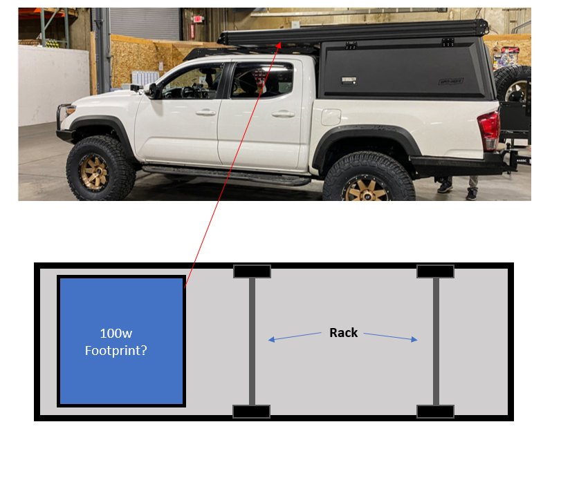

    Whats the deal with solar panels?
    Debating on whether to "glue" one to the SP roof, put one on a rack, or put one hanging below the rack, so the rack could be used (yes whatever is on top of the rack woudl cover the panel).

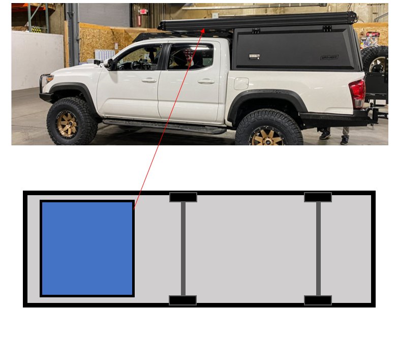

    Wonder if I could get a 100W panel of this size, right before the camper leaves the bed.
    Quick approximation below where I coudl maybe place 100W and have the rest of the space for a rack

    Someone on this tread maybe it was @gnardoggie convinced me I didn’t need a solar panel.... so I went with whatever he said he was doing but I went with AGM not Lithium iron phosphate for obvious cost saving reasons. But I am solar ready if I change my mind. Would plan for 100w flex panel affixed to the SP lid.

    And if you’re not penny pinching the Cascadia hood mounted 80ish watt I think it is panel like rad.... as long as you don’t have a Sport hood scoop.

    Yeah, I'm running redarc to a 78ah ( i think) AGM but for something like a baja trip where my truck might sit in the heat for a day, I want solar for my fridge to keep that thing cranked down.
    Since I have the redarc, the cost of adding solar is pretty low, just need the placement and panel.
